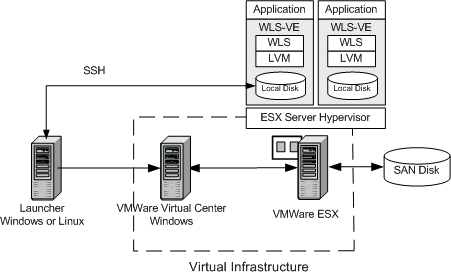

To successfully configure and use WLS-VE, it is important to understand the overall architecture and components of a WLS-VE configuration. Figure 1-1 provides a sample configuration consisting of two WLS-VE instances in a virtual environment.
Table 1-1describes the components of the sample WLS-VE configuration.
