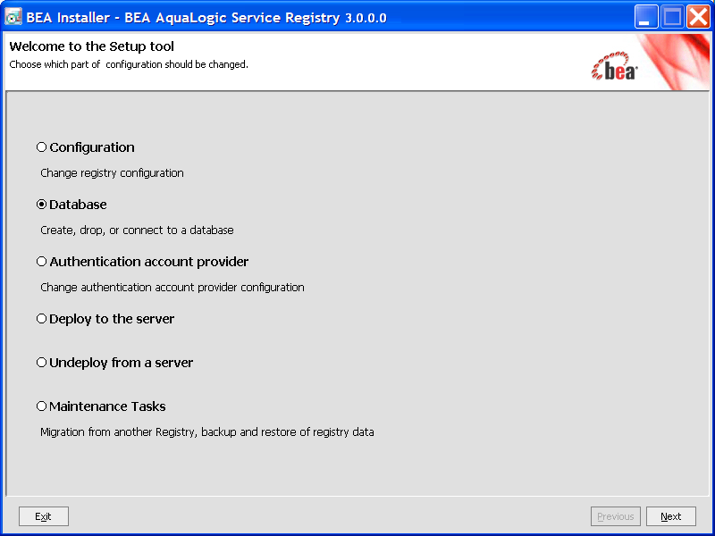

The database may be set up during installation or by using the Setup tool after installation. Both of these scenarios use the same set of GUI panels shown in this section.
To run the Setup tool, execute the following script from the bin subdirectory of your installation:
Windows: setup.bat
UNIX: ./setup.sh
See Setup in Command Line Scripts.
Select your database. For more information on the Setup tool, please see Reconfiguration After Installation.

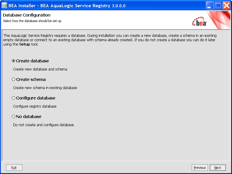

The registry requires a database. During installation you can create a new database, create schema in an existing empty database or connect to an existing database with created schema. Using the Setup tool, you can also drop a database or database schema. Select your database operation on the following panel:
Select a method from those shown in Figure 9-2.

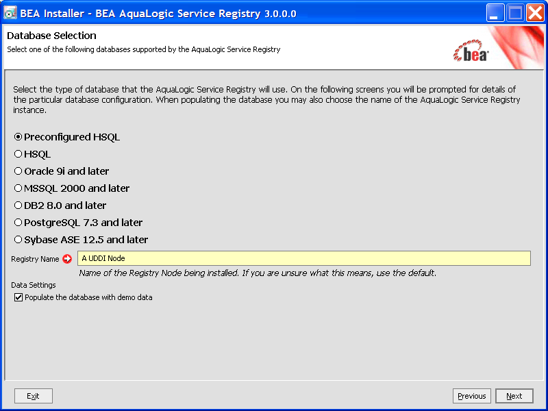

The following figure shows the supported database engines that can be prepared for BEA AquaLogic Service Registry. The panel may differ if another method was selected in the previous step.
Follow these links for the selected database.

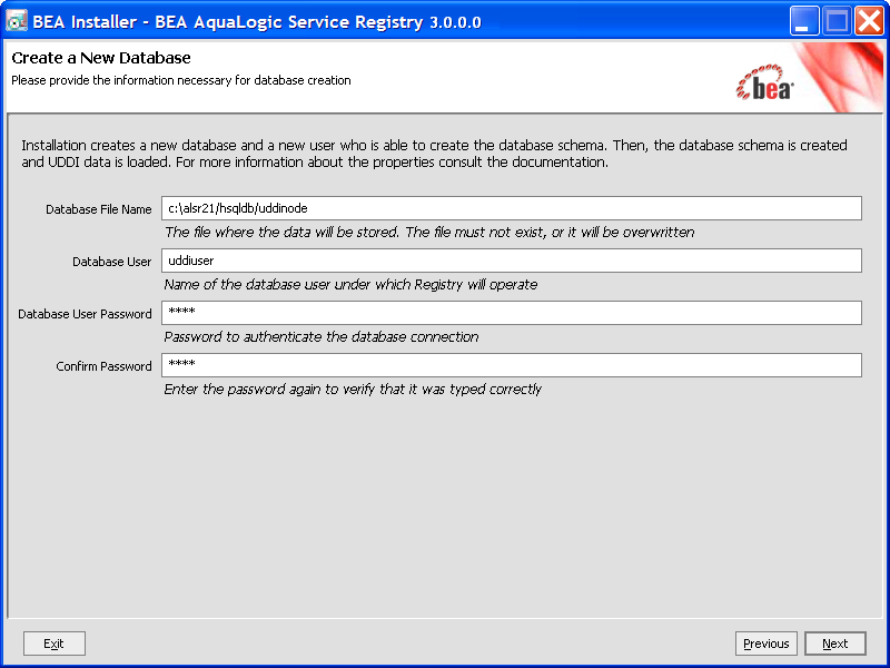

The default database is the pre configured HSQL. The installer or Setup tool creates database named REGISTRY_HOME/hsqldb/uddinode
and the user account uddiuser
with the password uddi
in the database. Note that all database files can be found in REGISTRY_HOME/hsqldb
directory.
Note: | This database is recommended for evaluation and testing purposes only. |
Note: | If you use HSQL then user credentials are stored in the HSQL database files in plain text. So you must protect these files from unauthorized reading using appropriate file system access rights. The files are located in the directory REGISTRY_HOME/hsqldb/ by default. |
The installation process creates a new database and a user who is able to create schema/tables.
The HSQL database requires the following properties.

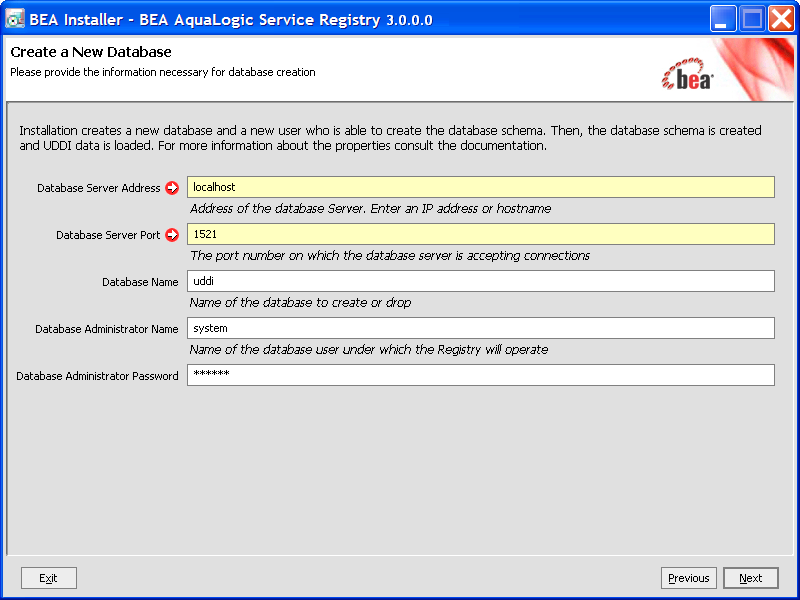

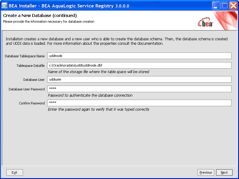

The Create database option on the installer/Setup tool does not mean to create a new physical database. The installation process only creates a new tablespace in an existing database and a new user of the default tablespace is set up on the created one. Then a database schema is created and UDDI data are loaded. Because relational tables are created in the schema of the specified user, if you want to create more UDDI databases (such as databases for publication and discovery registries for the approval process), you must create UDDI databases with different database users.
Oracle database creation requires the following properties. To connect or create a schema requires a subset of these properties. Please note that properties marked with an asterisk (*) must not collide with existing objects in the database.

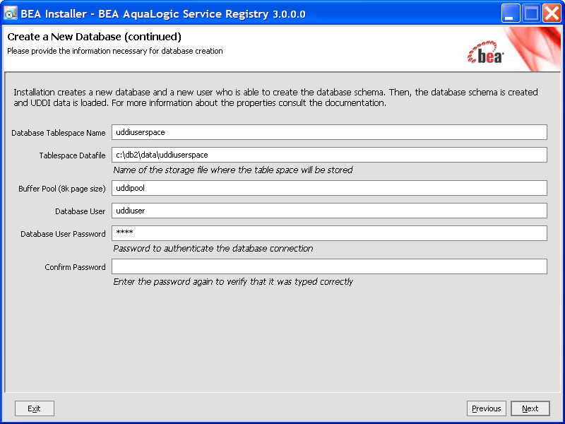

The Create database option from the installer/Setup tool does not create a new database physically. The installation process creates a new tablespace in an existing database with the given (existing) buffer pool and associates the tablespace with the given file. Permission to use the tablespace is given to the specified user. Then, a database schema is created and UDDI data are loaded.
Because relational tables are created in the implicit schema, if you want to create more UDDI databases (such as databases for publication and discovery registries for the approval process), you must create UDDI databases with different database users.
The Create database option requires a buffered with 8k page size and an database user account, that can use a temporary tablespace with such buffered.
C:\Db2\data\udditempspace
, click Next 3 times and then click Finish. DB2 Control Center
:DB2 database creation requires the following properties. To connect or create schema requires a subset of these properties. Please note that properties marked with an asterisk (*) must not collide with existing objects in the database.
Note: | You must have read and write permissions to this directory. |

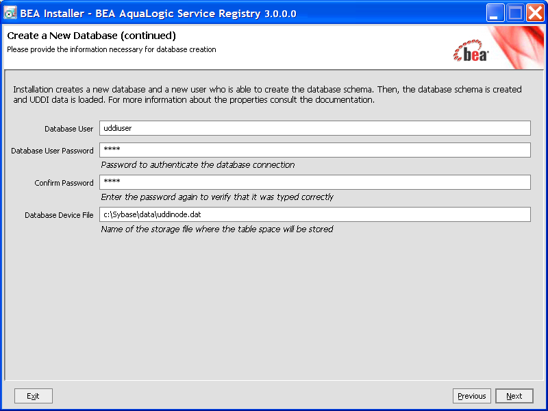

The installation process creates a new database and a new user who is able to create tables. Then database schema is created and UDDI data are loaded.
Note: | You must configure the Sybase database server with at least 8K page size. Servers with a lesser page size may refuse some requests to store data. |
Sybase database creation requires the following properties. To connect or create a schema requires a subset of these properties. Please note that properties marked with an asterisk (*) must not collide with existing objects in the database.
