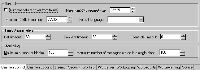

The Daemon Control tab is shown in the following figure:
The Daemon Control tab comprises fields, as listed in the following table:
Table C-1 Daemon Control tab Components
| Field | Description |
Automatically recover from failure |
The daemon restarts automatically if it fails for any reason (any error that causes the daemon process to terminate, such as network process lost or the CPU running the daemon crashes and the backup daemon is defined on another CPU). All available and unconnected servers are terminated and any connected servers are marked and terminated on release. Also the backup starts a backup for itself. The backup appends a new log file to the log of the original daemon, adding a line indicating that a backup daemon was started. |
Maximum XML request size |
The maximum number of bytes that the daemon handles for an XML document. |
Maximum XML in memory |
The maximum amount of space reserved for the XML in memory. |
Default language |
The language that the daemon supports. This setting is used when working with a client with a code page different from the server code page. |
Call timeout |
The timeout period for short calls for all daemons. The definition of a short call is a call that should be completed in a few seconds. For example, most calls to a database such as Specifying the timeout in a workspace overrides the value set in this field for that workspace. |
Connect timeout |
The time the client waits for a daemon server to start. If the daemon server does not start within this period, then the client is notified that the server did not respond. The value specified for this parameter serves as the default timeout for all the workspaces listed in the daemon configuration. The default value for this parameter is 60 seconds. Notes:
Client idle timeout |
The maximum amount of time any daemon client may be idle before the connection with the server is closed. Specifying the timeout in a Workspace overrides this setting for that workspace. |

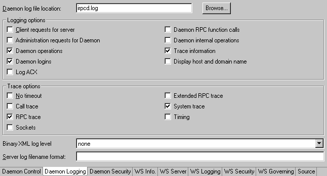

The Daemon Logging tab is shown in the following figure:
The Daemon Logging tab comprises fields, as listed in the following table:
Table C-2 Daemon Logging tab Components
Daemon log file location |
Specifies the daemon produces its log data. The full path must be specified. |
Logging options |
Specifies what tracing is performed. |
Client requests for server |
Logs client requests for server activations; this provides logging of the process IDs of the started servers along with the location of the log files. |
Administration requests for daemon |
Logs all of the administration requests for the daemon. |
Daemon operations |
Logs all of the daemon operations. |
Daemon logins |
Logs daemon logins. |
Daemon RPC function calls |
Logs all daemon RPC function calls. |
Daemon internal operations |
Logs daemon internal operations. |
Log trace information |
Logs low-level RPC operations. |
Display host and client domain name |
Specifies whether the client host and domain name are logged rather than the client IP address. The default is false. |
Trace options |
Specifies the type of tracing being performed. |
No timeout |
Disables the standard RPC timeouts, setting them to a long duration (approximately an hour) to facilitate debugging. |
Call trace |
Generates a message in the server log file for each RPC function called. This is useful for troubleshooting the server. |
RPC trace |
Enables debugging messages on the server. |
Sockets |
Generates a message in the server log file for each socket operation. |
Extended RPC trace |
Generates a verbose message in the server log file for each low-level RPC function called. This is useful for troubleshooting the server. |
System trace |
Generates system-specific tracing of various operations. |
Timing |
Generates a timestamp for every entry to the server log file. |
Binary XML log level |
Sets the binary XML log level. Your options are:
Server log filename format |
Defines the name and location of the server log file. The field must specify the full path name. If no directory information is provided for the log file, then it will be located in the login directory of the account running Oracle Connect workstation. |
The following tokens can appear in the log file template and will be replaced accordingly:
%A: workspace name
%D: date (yymmdd)
%I: instance number of the given workspace server
%L: server account login directory
%P: server process ID
%T: time (hhmmss)
%U: server account name (username)
For example, %L/server_%A%I.log may produce a log file such as: /usr/smith/server_sales15.log.
The default log file template is %L/server_%A%I.log.

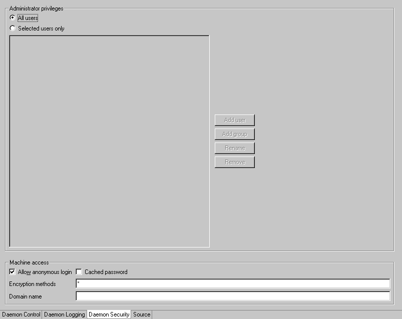

The Daemon Security tab is shown in the following figure:
The Daemon Security tab comprises fields, as listed in the following table:
Table C-3 Daemon Security tab Components
Administrators privileges |
Identifies the users (accounts) allowed to perform administrative tasks (tasks that require administrative login). |
All users |
Enables all users to access the daemon and change the settings. |
Selected users only |
Identifies the names of users (accounts) and groups that can be administrators.Foot 1 If a user is not specified, the account from which the daemon was started is considered the administrator. Note that the daemon does not require the user to log in to the account on the system, but to log in to the daemon using the account name and password. |
Machine access |
Manages access to the computer. |
Allow anonymous login |
Whether workspaces allow anonymous logins (without user name/password entries). For the optimal level of security, keep this option unchecked and define a username for the Daemon Administrators parameter. If unchecked, then no workspace can have an anonymous client. If checked, then a particular workspace allows anonymous clients. |
Cached password |
Enables login passwords to be cached. This enhances performance by reducing login times for future connections from the same client in a session. |
Encryption methods |
Specifies the encryption method used to send information across the network. The default is an asterisk (*), meaning that all methods are acceptable. If an encryption method is specified, it must be used. The RC4 and DES3 protocols are currently supported. |

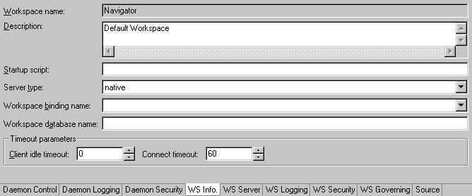

The WS Info. tab is shown in the following figure:
The WS Info. tab comprises fields, as listed in the following table:
Table C-4 WS Info tab Components
Workspace name |
The name used to identify the workspace. Note: The default configuration includes the default Navigator workspace. This workspace is automatically used if a workspace is not specified as part of the connection settings. |
Description |
A description of the workspace. |
Startup script |
The full path name of the script that starts the workspace server processes. The script specified here must always activate the |
Server type |
This field is not applicable for use with OracleAS Adapters for VSAM. |
Workspace binding name |
Timeout parameters |
The time the client waits for the workspace server to start. If the workspace server does not start within this period, then the client is notified that the server did not respond. Specifying the timeout here overrides the default setting, specified in the Control section. See Also: "Daemon Control" for details about the Daemon Control section. |
The maximum amount of time a workspace client can be idle before the connection with the server is closed. |
Connect timeout |
The time the client waits for a workspace server to start. If the workspace server does not start within this period, then the client is notified that the server did not respond. |

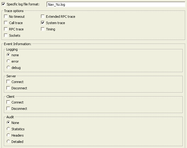

Click the WS Logging tab.
After making changes to the workspace, right-click the daemon and select Reload Configuration.
You can also change daemon settings using the Configuration Explorer, by selecting a computer and scrolling the list to the required daemon. Right-click the daemon and select Edit Daemon.Changes made to the daemon configuration are not implemented. They are only implemented after the configuration is reloaded using the Reload Configuration option in the Runtime Manager.
Right-click the daemon and select End Unused Servers. Any servers in the connection pool are closed and new servers start with the new configuration.
The WS Logging tab is shown in the following figure:
The WS Logging tab comprises fields, as listed in the following table:
Table C-6 WS Logging tab Components
Specific log file format |
Defines the name and location of the server log file if you want the data written to a file instead of SYSOUT for the server process. The parameter must specify the name and the high level qualifier. The following tokens can appear in the log file template and will be replaced accordingly:
Trace options |
Specifies the type of tracing to be performed. The following tracing options are available:
Logging |
Specifies the level of events that are logged for the workspace. The following event levels are available:
Server |
Specifies the server connection events to log. The following server events are available:
Client |
Specifies the type of tracing performed. The following client events are available:
Audit |

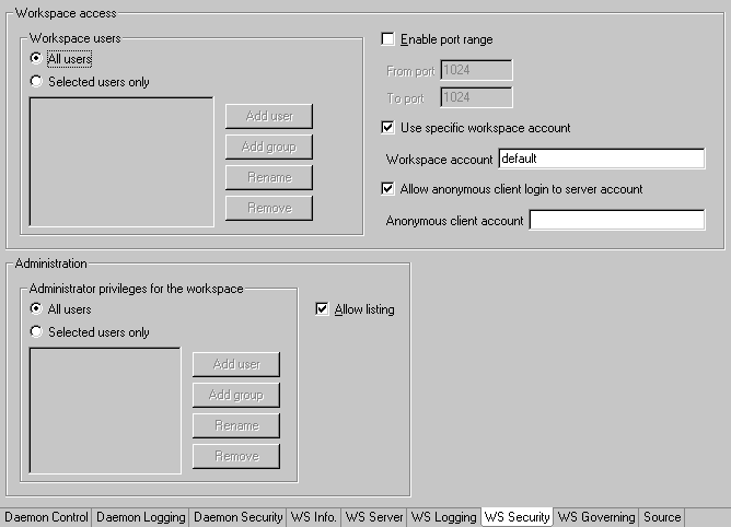

Using the WS Security tab, you specify the level of security at the workspace level, as opposed to the daemon level, which is set in the Daemon Security tab.
See Also:
"Daemon Security" for details about security.The WS Security tab is used to:
Grant administration rights for the workspace
Determine access to the workspace by a client
The WS Security tab is accessed as follows:
From the Start menu, select Programs, Oracle, and then select Studio.
Select the required computer from the Configuration Explorer.
Right-click the computer and select Open Runtime Perspective.
Expand the Daemons node to display the workspaces in the Runtime Explorer.
Right-click the workspace and select Edit Workspace Configuration.
Click the WS Security tab.
The WS Security tab is shown in the following figure:
The WS Security tab comprises fields, as listed in the following table:
Table C-7 WS Security tab Components
Administration |
Defines the users (accounts) allowed to perform administrative tasks (tasks that require administrative login) on this workspace. |
Administrator privileges |
Identifies the users (accounts) with administrator privileges. The following options are available:
Workspace account |
Defines the users (accounts) allowed to access the workspace, firewall access ports, workspace account, and anonymous login permissions. |
Workspace users |
Lists the users who are allowed to use the workspace.
