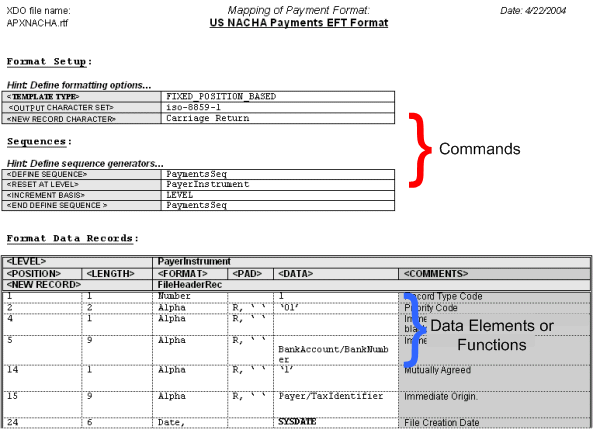

There are two types of eText templates: fixed-position based (EFT templates) and delimiter-based (EDI templates). The templates are composed of a series of tables. The tables define layout and setup commands and data field definitions. The required data description columns for the two types of templates vary, but the commands and functions available are the same. A table can contain just commands, or it can contain commands and data fields.
The following graphic shows a sample from an EFT template to display the general structure of command and data rows:
Commands that apply globally, or commands that define program elements for the template, are "setup" commands. These must be specified in the initial table(s) of the template. Examples of setup commands are Template Type and Character Set.
In the data tables you provide the source XML data element name (or static data) and the specific placement and formatting definitions required by the receiving bank or entity. You can also define functions to be performed on the data and conditional statements.

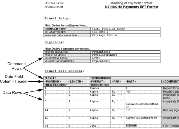

The following figure shows the placement of Command Rows, Data Rows, and Data Column Header Rows:
Command rows are used to specify commands in the template. Command rows always have two columns: command name and command parameter. Command rows do not have column headings. The commands control the overall setup and record structures of the template.
Blank rows can be inserted anywhere in a table to improve readability. Most often they are used in the setup table, between commands. Blank rows are ignored by BI Publisher when the template is parsed.
Data column headers specify the column headings for the data fields (such as Position, Length, Format, Padding, and Comments). A column header row usually follows the Level command in a table (or the sorting command, if one is used). The column header row must come before any data rows in the table. Additional empty column header rows can be inserted at any position in a table to improve readability. The empty rows will be ignored at runtime.
The required data column header rows vary depending on the template type. See Structure of the Data Row.
Data rows contain the data fields to correspond to the column header rows.
The content of the data rows varies depending on the template type. See Structure of the Data Row.
