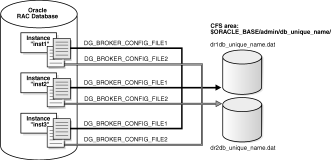

3.2.2.1 Using Cluster File System (CFS) for Configuration Files
If cluster file system (CFS) is available, and the configuration files reside there, the DG_BROKER_CONFIG_FILEn parameters on all of the instances must be set to these files including the path to the CFS area. Figure 3-2 shows the set up for the broker configuration files on CFS. In this scenario, the parameters and value for all instances would be:
DG_BROKER_CONFIG_FILE1=$ORACLE_BASE/admin/db_unique_name/dr1db_unique_name.dat
DG_BROKER_CONFIG_FILE2=$ORACLE_BASE/admin/db_unique_name/dr2db_unique_name.dat
Figure 3-2 Broker Configuration Setup in a CFS Area

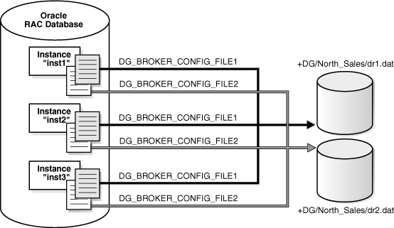

3.2.2.2 Using Oracle ASM Disk Groups for Configuration Files
The broker's configuration files can also reside on an Oracle ASM disk group. Figure 3-3 shows the setup for the broker configuration files on Oracle ASM devices. In this scenario, the parameters and values would be specified, as follows:
ALTER SYSTEM SET DG_BROKER_CONFIG_FILE1 = '+DG/DIRECTORY/DR1.DAT' SCOPE=BOTH;
ALTER SYSTEM SET DG_BROKER_CONFIG_FILE2 = '+DG/DIRECTORY/DR2.DAT' SCOPE=BOTH;
Figure 3-3 Broker Configuration Setup with Oracle ASM
Description of Figure 3-3 follows
Description of "Figure 3-3 Broker Configuration Setup with Oracle ASM"
Because the configuration files must be explicitly named by the user, these configuration files are not Oracle Managed Files (OMF).To create the broker's configuration files on an Oracle ASM disk group, set the DG_BROKER_CONFIG_FILE1 and DG_BROKER_CONFIG_FILE2 initialization parameters to a string value that includes the name of an existing Oracle ASM disk group, an existing directory in that disk group, and the name of the configuration file itself.

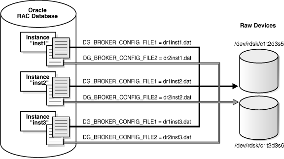

3.2.2.3 Using Raw Devices for Configuration Files
If CFS is not available and you are not using Oracle ASM, the files must be on raw devices. In this case, the parameter values on each of the instances must point to the raw devices. Figure 3-4 shows the set up for the broker configuration files on raw devices. On a UNIX system, you would set this up similar to the following on each node:
% ln -s /dev/rdsk/c1t2d3s5 dr1inst1.dat
% ln -s /dev/rdsk/c1t2d3s6 dr2inst2.dat
Figure 3-4 Broker Configuration Setup with Raw Devices
Description of Figure 3-4 follows
Description of "Figure 3-4 Broker Configuration Setup with Raw Devices"
If the broker configuration files need to be on raw devices, set up two additional raw devices of 1MB each. Set up the value of the DG_BROKER_CONFIG_FILE1 and DG_BROKER_CONFIG_FILE2 parameters to point to the raw devices. A 1MB configuration file will accommodate 10 databases with a total of 45 instances between them.
You may need a larger device if the number of instances for this configuration exceeds 45 instances. You will need 15KB for each additional instance.
