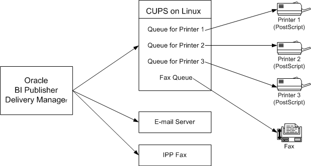

The delivery manager requires Common UNIX Printing System (CUPS) to print and fax documents. This section describes how to set up CUPS for printing and faxing on RedHat Linux.
The following diagram shows the integration between BI Publisher and CUPS:

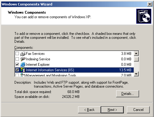

Open the Control Panel. Select Add or Remove Programs, then Add/Remove Windows Components.
Select the check box for Internet Information Services (IIS) from the list of available Windows Components (shown in the following figure).

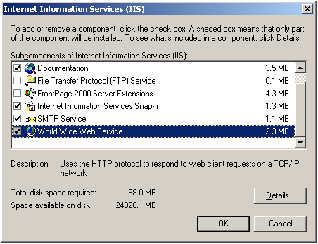

With IIS highlighted, select Details. Ensure that World Wide Web Service is selected (shown in the following figure).

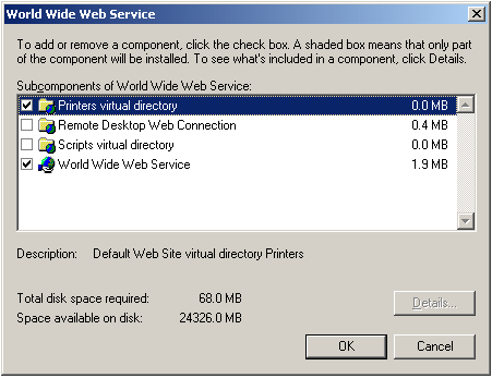

With World Wide Web Service highlighted, select Details. Ensure that Printers virtual directory is selected (shown in the following figure).

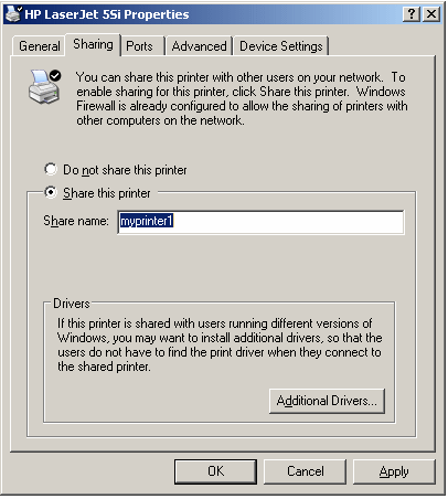

Right-click the printer icon and select Sharing.
In the printer Properties dialog, select Share this printer and assign a Share name (for example: myprinter1). An example is shown in the following figure.

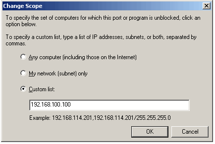

From the Edit a Program dialog, select Change Scope.
Choose Custom list, and enter the IP address of the XMLP Server.
Note that if you use the HTTP proxy server in BI Publisher Server, you must enter the IP address of the proxy server.

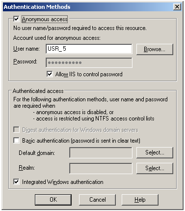

In the Anonymous access and authentication control region, select Edit.
In the Authentication Methods dialog, select the Anonymous access check box. An example is shown in the following figure.
