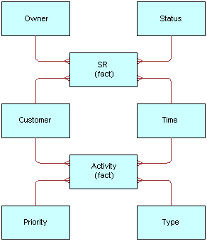

 Siebel Business Analytics Server Administration Guide > Setting Up Mobile Analytics > Creating the Mobile Application Configuration File > Data Set DefinitionsThe sample XML configuration file for the retail application in Create the Application Configuration File for Mobile Analytics was a simple configuration file containing a single data set with three tables. You might need only a single table in a data set or, for a more complex application, you might want to use multiple data sets. This section discusses why administrators might want to define multiple data sets for a particular mobile application or why they might want to define a single data set with only one table. This section contains the following topics: Defining Multiple Data SetsThis section describes multiple data sets by using an example of a customer interaction application that tracks the following types of customer interactions:
 Figure 20 illustrates the database schema for the application. It shows a schema with two main fact tables (Activity and SR) and their associated dimension tables. The two fact tables share the Customer and Time dimension tables. CAUTION: It is the administrator's responsibility to verify data consistency and integrity. For example, if you create a new data set that contains new dimensional records and do not update the corresponding facts data set, the mobile database might provide incorrect results. Static DimensionsStatic dimensions are dimension tables that do not change for long periods of time, if at all. For example, a dimension table of United States zip (postal) codes could be a static dimension for most applications. Because static dimensions do not change often, mobile users typically need to download them only once. Therefore, administrators should put all static dimension tables for a mobile application into a separate data set. The Customer Interaction application example in Defining Multiple Data Sets has one static dimension (Time). Database administrators typically preallocate many years worth of time data. As a result, the table does not change for years at a time. For example, in the Customer Interaction application, the Time dimension contains static data through the year 2010. Example of a Data Set for a Time DimensionThe following is an example of the data set definition for the Time dimension.
