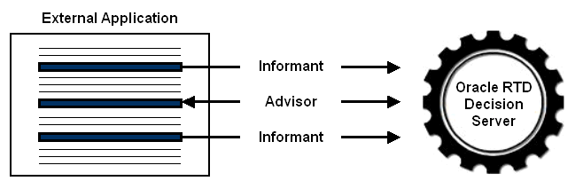

In general, Oracle RTD connects with other applications, and passes its recommendations to these external applications. See the next section for more information about how Oracle RTD integrates with external applications.
Applications that you develop to interact with Oracle RTD are referred to as external applications. Typically external applications consist of many processing steps and stages. The points at which external applications communicate with Oracle RTD are generically known as Integration Points.
There are two main types of Integration Point:
An Informant is a process that passes data from the external application to Oracle RTD
An Advisor is a two-way process, that both passes data from the external application to Oracle RTD, and also receives data sent back from Oracle RTD to the external application
Advisors are the main method by which an external application requests and receives recommendations from Oracle RTD.
Each external application can have many Informants and Advisors.

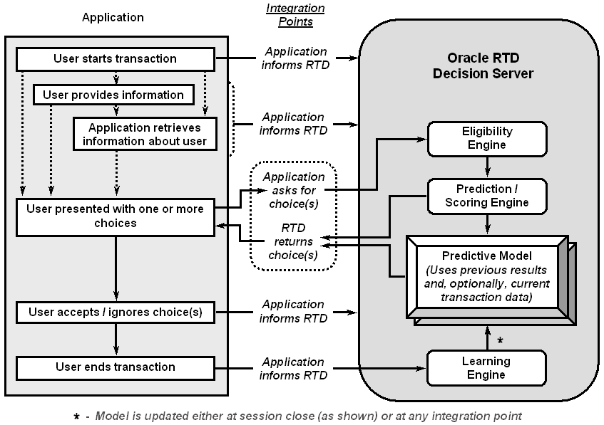

Figure 2-1 shows, in outline form, how a typical application interfaces with Oracle RTD.
Figure 2-1 shows one Advisor and four Informants, the Informants corresponding to the following key stages in the application:
The user has started the transaction.
The external application has acquired more information about the user.
The user has accepted or rejected a choice.
The user has ended the transaction.

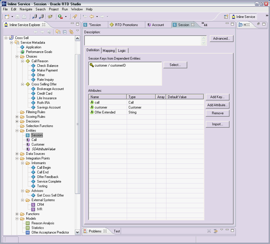

Choice Groups and Choices are the Inline Service elements from which Decisions draw their possible Choices, and which become targets of analysis for Choice and Choice Event Models.
Choice Groups and Choices form a hierarchy, where:
Each Choice belongs to one Choice Group only
Each Choice Group can have one or more sub-Choice Groups
Choices exist only at the lowest level of a Choice Group hierarchy branch.
Choices can be used by a Decision, so that they can be returned by Advisors, and can be registered to either Choice or Choice Event models through Informants.

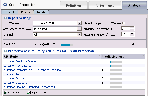

Both types of model can be used for prediction and for generating analysis reports.
Input
The main objective of any model is to show, for each choice of the associated choice group, what factors influenced a particular choice.
Models are updated with, and "learn" from the following data:
All the data in the Session entity - specifically, all the Session attributes, unless specifically excluded from analysis through the Inline Service configuration
In addition, Choice Event Models also require event-related details. For more information, see Section 2.5.7.3, "Choice Event Models."

An Oracle RTD Inline Service consists of all the Oracle RTD elements necessary to interface with an external application and model the desired business process.
The main elements of an Inline Service are the following:
Data Sources
Entities
Integration Points
Decisions
Filtering Rules
Scoring Rules
Models
Performance Goals
Functions
Not all Inline Services have all of these elements. The specific requirements of each external application determine which elements are needed in the associated Inline Service.
For more information on how to configure an Inline Service, see the Related Documents in the Preface chapter, in particular the Oracle Real-Time Decisions Decision Studio Reference Guide.
In Oracle RTD, you define the Inline Service elements in the Oracle RTD Decision Studio. You must first configure, then deploy an Inline Service to the Oracle RTD server before the Inline Service can be used by an application.
Figure 2-3 shows some of the elements of an Inline Service, called Cross Sell, as displayed in the Decision Studio.
For more information about how to define and deploy Inline Services, see Oracle Real-Time Decisions Decision Studio Reference Guide.
Oracle RTD Decision Center is a client tool for business users to explore, analyze, examine, and even modify the structure and data gathered by a deployed Inline Service.
The Oracle RTD Decision Center provides a variety of analytic reports, both for performance analysis and model analysis.
For example, there are several reports at the choice group and choice level, such as the following examples from a Cross Sell application:
Choice Group Performance Counts
The Choice Group Performance Counts shows the total counts for each choice or choice event occurrence in a choice group.
Choice Analysis Drivers
The Choice Analysis Drivers report identifies the attributes that are influential as drivers of predictiveness for each of the choices.
Predictiveness is a measure of the relationship strength between entity attributes, that are the model input, and choice and choice events, that are the model output.
A drilldown on any of the attribute hyperlinks will reveal additional reports about the attribute values themselves.
Choice Analysis Trends
The Choice Analysis Trends report shows the change of predictiveness for each of the attributes for a choice over two selected model time windows.
Choice Analysis Best Fit
The Choice Analysis Best Fit report shows all the attributes and values that are most likely to predict the specified event outcome.
Oracle RTD also provides a variety reports that show the effectiveness of entities and entity attributes for predicting choices.
For more information about how to view, analyze, and modify the structure and data of Inline Services in the Decision Center, see Oracle Real-Time Decisions Decision Center User Guide.
