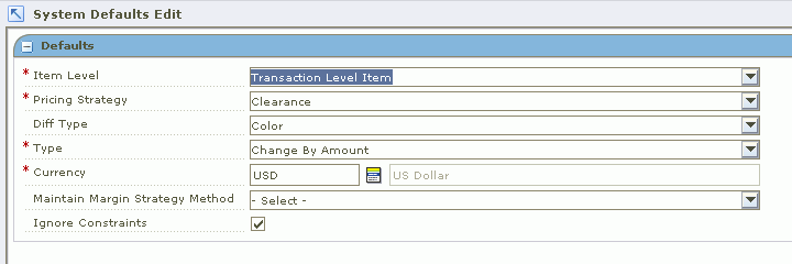

System Defaults
The System Defaults Edit workspace allows you to configure RPM to maximize the system. Select the values that should be initially displayed when a user enters the workspace. This helps the user save time as they do not have to select the appropriate value each time they complete a task. The values entered will appear in other areas of the application.

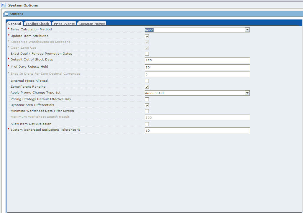

Edit System Options
Navigate:From the Task Pad, select System Options > System Options Edit. The System Options workspace opens.
Figure 2-1 System Options Workspace - General
  1. Update any enabled fields as necessary.
    See "System Options" for more information.
  2. Click Save to commit any changes and close the workspace.

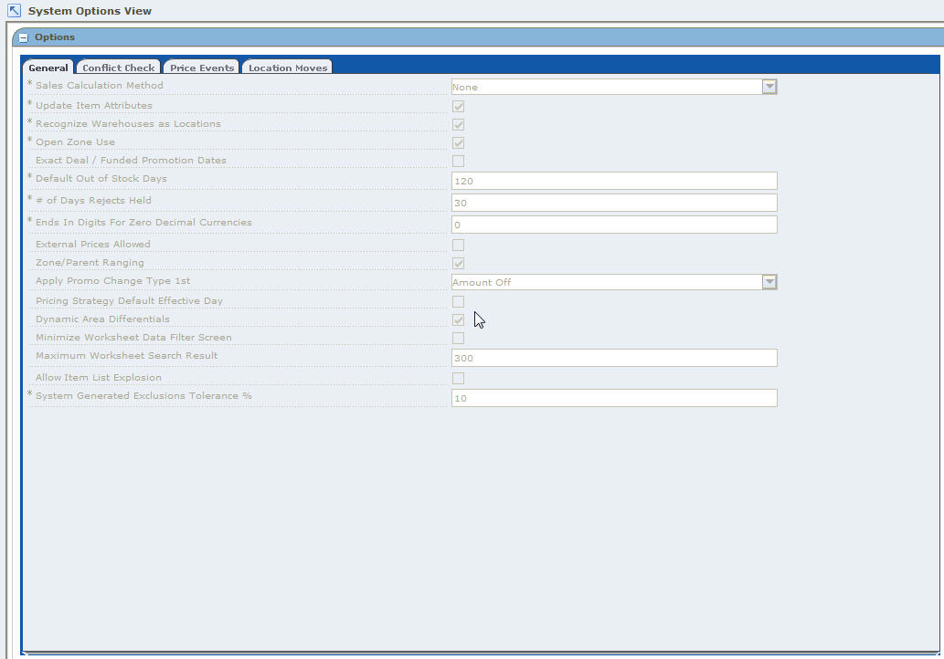

View System Options
Navigate: From the Task Pad, select System Options > System Options View. The System Options View workspace opens.
Figure 2-2 System Options View Workspace
  • Click Close to exit the workspace.

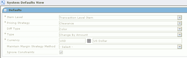

System Options
The following table lists the system defaults.
Table 2-2 System Defaults Definitions
System Default Definition Options
Item Level
The level of an item in an item group.
  • Parent Item
  • Parent Item/Diff

Figure 2-3 System Defaults Edit Workspace
  1. Update enabled fields as necessary. See "System Options" for more information.

Navigate: From the Task Pad, select System Options > System Defaults View. The System Defaults View workspace opens.
Figure 2-4 System Defaults View Workspace

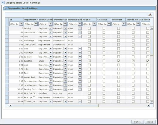

The Aggregation Level Settings workspace allows you to define system parameters that vary for price strategies and price worksheet. When a department is created in the merchandising system, Oracle Retail Price Management assigns the default value for each parameter to the default or default level defined in the system. You may choose to define the aggregation level at a different parameter than the default. When a price strategy exists for a department, parameters are disabled and cannot be changed.
Maintain Aggregation Level Settings
Navigate: From the Task Pad, select Aggregation Level > Maintain Aggregation Levels. The Aggregation Level Settings workspace opens.
Figure 2-5 Aggregation Level Settings Workspace
  1. Select the record you want to update.
  2. Click in the field that you want to change.
    • Lowest Definable Level: Select the lowest level of the merchandise hierarchy for which a price strategy can be defined.
    • Worksheet Level: Select the level of the merchandise hierarchy at which worksheets are generated.
    • Historical Sales: Select the sales period RPM should represent as historical on the worksheet.
    • Regular: Select the checkbox to indicate that regular sales should be included as part of historical sales in the price worksheet.
    • Clearance: Select the checkbox to indicate that clearance sales should be included as part of historical sales in on the price worksheet.
    • Promotion: Select the checkbox to indicate that promotional sales should be included as part of historical sales in on the price worksheet.
    • Include WH Inventory: Select the checkbox to indicate that warehouse inventory should be included in the calculations for sell through and price change impact in the price worksheet.
    • Include On Order In Sell Thru: Select the checkbox to indicate that inventory ordered is included in the sell through calculations on the price worksheet.
    • Price Change Amount Calc: Select the method of calculating the price change amount on the price worksheet.
      • New-Current: The current price is subtracted from the new price.
      • Current-New: The new price is subtracted from the current price.
    • Past Retail Change Highlight Days: Enter the number of days previous retail changes will cause the Last Price Change column of the pricing worksheet to be highlighted.
    • Past Cost Change Highlight Days: Enter the number of days previous cost changes will cause the Last Cost Change column on the pricing worksheet.
    • Pending Cost Change Window Days: Enter the number of days into the future the system should look for pending cost changes.
    • Pending Cost Change Highlight Days: Enter the number of days into the near future the system should look for pending cost changes. The Pending Cost Change column on the worksheet is highlighted if a cost change falls within the Pending Cost Change Highlight Days.
    Pending Cost Change Highlight Days must be less than or equal to Pending Cost Change Window Days.
  3. Click Done to save any changes and close the workspace.
