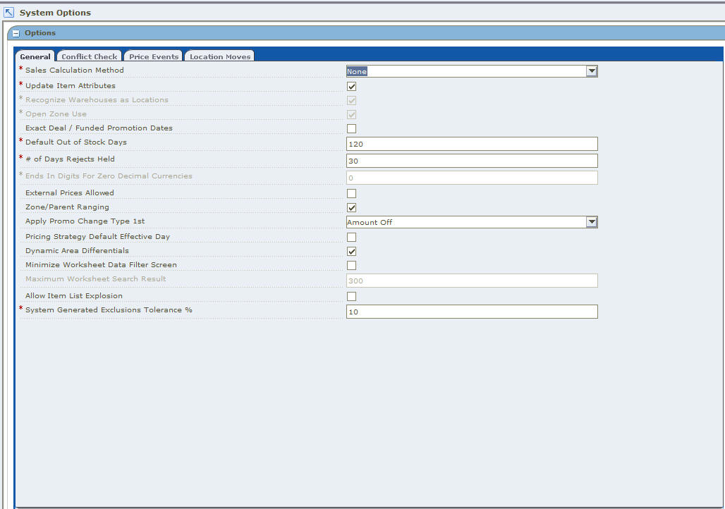

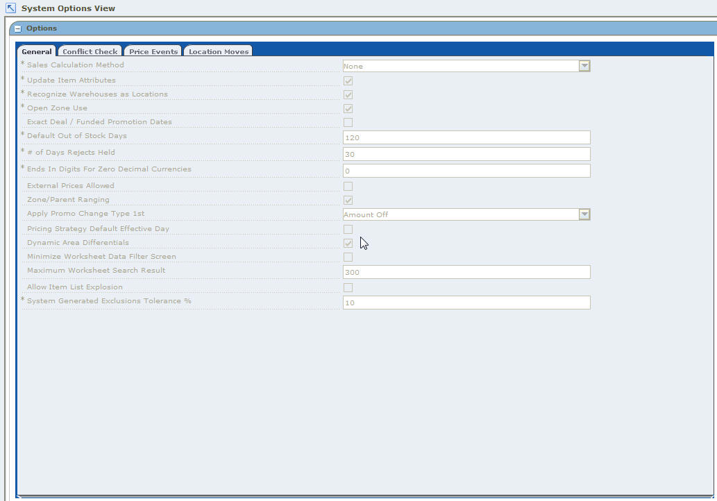

System options are organized on the following tabs:
General
Conflict Checking
Price Events
Location Moves
Table 2-1 System Options Fields and Descriptions
| System Options | Definition |
General |
Sales Calculation Method |
The method used by the merchandise extract program to populate the Projected Sales column in the worksheet. |
Update Item Attributes |
When selected, the merchandise extract program updates certain item attributes during each extract that occurs during a worksheet review period. |
Recognize WHs as Locations |
When selected, indicates that warehouses can be assigned to regular and clearance price zones. They cannot be assigned to a zone that is only setup for promotional pricing. |
Open Zone Use |
When selected, indicates a zone can be used across different types of pricing, regardless of zone type. |
Exact Deal/Funded Promotion Dates |
When selected, indicates that the dates of a deal associated with a vendor funded promotion must match the promotion component dates exactly. When selected, only deals with the same begin and end dates as the promotion component being created will appear in the deal. |
Default Out of Stock Days |
The number of days that should be added to an items clearance effective date in order to calculate the Out of Stock date. The default is applied to generate the out of stock date when the clearance is first created. |
# of Days Reject Held |
The number of days after the effective date of a rejected price change or clearance that it is purged from the system. |
Ends in Digits for Zero Decimal Currencies |
The number of digit fields set in system options that are available in the Ends In definition area. This field is used for currencies that do not contain a place after the decimal point. For currencies that contain places after the decimal point, the digit fields that are available. |
External Prices Allowed |
When selected, RPM accepts pricing events created in other systems. |
Zone/Parent Ranging |
When selected, RPM performs ranging checks for price changes, promotions, and clearances that are created at a higher level than transaction/location. If the indicator is set to yes, the system will not let you create a price change at the parent or zone level if none of the transaction item/location combinations are ranged. If the indicator is set to no, the system will let you create a price change at the parent or zone level even if none of the transaction item/location combinations are ranged. |
Apply Promo Change Type 1st |
Indicates which type of promotion change should be applied first. This system option is only factored into the promotion retail calculation when there are multiple promotion details under a single promotion that has different change types (amount off or percent off). The ranking algorithm used first applies a promotion as a whole to a given item/loc before ranking/applying the details under those promotions. The ranking is applied to the Promotion Header first, before looking at the Promotion Components. The promotions are applied to an item/location based on the following ranking order. These rules apply to all promotions, including those created using the Injector Price Event Batch. Note: This system option will only be used when selling retail calculations are compounded. It will not be used when the system option: simple promotion overlap rule is set to non-compounding best deal. Ranking order:
Example scenario:
Both promotions are NON secondary and the system option: Apply Promo Change Type 1st is set to Amount Off. The system will first rank at the Promotion Level. Since Promo 2 has the Fixed Price Component in it, it will be ranked higher than Promo 1. All components under Promo 2 will be applied first, and then component under Promo 1 will be applied. When applying Promo 2, component P2C2 will be applied first, since it is a Fixed Price and then P2C1. After applying all components under Promo 2, then component under Promo 1 will be applied. For this example, the order of application is:
Pricing Strategy Default Effective Day |
When selected, the user can choose which day of the week price changes will be effective. |
Dynamic Area Differentials |
When selected, allows the worksheet to dynamically update secondary locations based on changes to the primary location. |
Minimize Worksheet Data |
When checked, the user is given an optional workflow which includes worksheet data filtering. When unchecked, the worksheet filter screen will not be accessible. |
Maximum Worksheet Search Result |
Indicates the maximum number of rows that are displayed based on the respective search criteria. |
Allow Item List Explosion |
Allows you to select whether the item list should be exploded to the item level or left at itemlist level. Recommendation to set value to N if you are not managing your items on a price event at a lower level. Valid values are: Y – Yes/Checked. Two options are provided in the Item Level field: Item List and Item (when Item Type = Item List). N – No/Unchecked. Item Level could only be Item List (when Item Type = Item List). The default value is N/Unchecked. |
System Generated Exclusion Tolerance % |
This system option is used to determine the number of transaction items that will be automatically excluded during the price event approval process. This feature is available for price changes, clearance, and simple or threshold promotions that are created at a merchandise hierarchy level above transaction level. The percent value designated determines the number of items on a price event that can encounter conflicts and continue with the approval of the price event. If the number of items with conflicts exceeds the percent value based on the total item in the price event, the price event will be set to worksheet status and conflicts will be flagged. |
Conflict Check |
# Days Event Displayed Before Vdate |
The number of days before the VDATE that a pricing event is displayed in the Conflict Review Check window. |
# Days Event Displayed After Vdate |
The number of days after the VDATE that a pricing event is displayed in the Conflict Review Check window. |
Display Conflicts Only |
When selected, only the record that caused the conflict will be displayed in the lower portion of the Conflict Review List window. When unchecked and the days before/after are provided, the system will search for all records using the price event's effective date as the point to search forward and back. This will bring back all records within the window of time calculated. Multiple records are displayed in the conflict review list window so that if one rule returns conflicts for multiple item/locs in a price event, all those conflicts are displayed. This is limited to a maximum of 100 records. |
Unique UOM is used for all items |
(DBA maintained) When selected, you have to specify which UOM should be used when fixed price events are created and the system will skip the UOM validation. |
Unique UOM to be used for all items |
(DBA maintained) Specifies which unique UOM needs to be used. This is a required field if ”Unique UOM is used for all items” option is checked. |
Do not run Conflict Check for Submit |
When checked, the system will skip conflict checking process when the user clicks the Submit button. |
Do not run Conflict Check for Complex Promotion Approval |
When checked, the system will skip conflict checking process when the user approves a Complex Promotion. |

Navigate:From the Task Pad, select System Options > System Options Edit. The System Options workspace opens.
Update any enabled fields as necessary.
See "System Options" for more information.
Click Save to commit any changes and close the workspace.
Navigate: From the Task Pad, select System Options > System Options View. The System Options View workspace opens.
Click Close to exit the workspace.

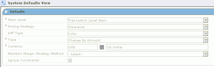

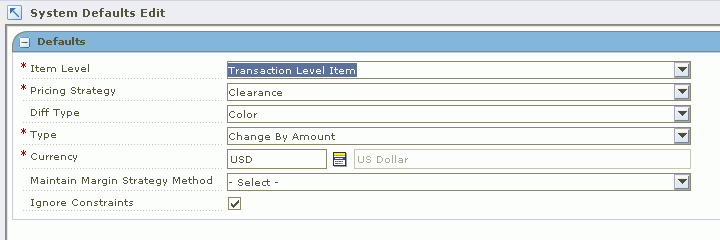

The following table lists the system defaults.
Table 2-2 System Defaults Definitions
| System Default | Definition | Options |
Item Level |
The level of an item in an item group. |
Pricing Strategy |
The pricing strategy is the default strategy type displayed for the user when entering the Pricing Strategy workspace. |
Diff Type |
The category that a diff belongs. |
Valid diff types from the Merchandising System. |
Type |
The type is the default price change type displayed when creating a price change. |
Currency |
The primary currency used in RPM. |
See LOV on System Default screen for code and description. |
Maintain Margin Strategy Method |
Defines the default method used when creating a maintain margin pricing strategy. |
Ignore Constraints |
Defines whether or not promotion constraints are taken into account when conflict checking is performed in the worksheet. |
Select/Clear check box |
Navigate: From the Task Pad, select System Options > System Defaults Edit. The System Defaults Edit workspace opens.
Update enabled fields as necessary. See "System Options" for more information.
Navigate: From the Task Pad, select System Options > System Defaults View. The System Defaults View workspace opens.

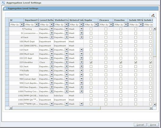

The Aggregation Level Settings workspace allows you to define system parameters that vary for price strategies and price worksheet. When a department is created in the merchandising system, Oracle Retail Price Management assigns the default value for each parameter to the default or default level defined in the system. You may choose to define the aggregation level at a different parameter than the default. When a price strategy exists for a department, parameters are disabled and cannot be changed.
Navigate: From the Task Pad, select Aggregation Level > Maintain Aggregation Levels. The Aggregation Level Settings workspace opens.
Select the record you want to update.
Click in the field that you want to change.
Lowest Definable Level: Select the lowest level of the merchandise hierarchy for which a price strategy can be defined.
Worksheet Level: Select the level of the merchandise hierarchy at which worksheets are generated.
Historical Sales: Select the sales period RPM should represent as historical on the worksheet.
Regular: Select the check box to indicate that regular sales should be included as part of historical sales in the price worksheet.
Clearance: Select the check box to indicate that clearance sales should be included as part of historical sales in on the price worksheet.
Promotion: Select the check box to indicate that promotional sales should be included as part of historical sales in on the price worksheet.
Include WH Inventory: Select the check box to indicate that warehouse inventory should be included in the calculations for sell through and price change impact in the price worksheet.
Include On Order In Sell Thru: Select the check box to indicate that inventory ordered is included in the sell through calculations on the price worksheet.
Price Change Amount Calc: Select the method of calculating the price change amount on the price worksheet.
New-Current: The current price is subtracted from the new price.
Current-New: The new price is subtracted from the current price.
Past Retail Change Highlight Days: Enter the number of days previous retail changes will cause the Last Price Change column of the pricing worksheet to be highlighted.
Past Cost Change Highlight Days: Enter the number of days previous cost changes will cause the Last Cost Change column on the pricing worksheet.
Pending Cost Change Window Days: Enter the number of days into the future the system should look for pending cost changes.
Pending Cost Change Highlight Days: Enter the number of days into the near future the system should look for pending cost changes. The Pending Cost Change column on the worksheet is highlighted if a cost change falls within the Pending Cost Change Highlight Days.
