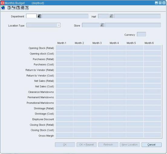

The Monthly Budget window allows you to maintain budget details at the monthly level for a specific department, half, and location.
To view the monetary values in the primary currency of the company or the currency of the location, select the appropriate option from the Options > Currency menu. Monetary amounts can only be edited in the primary currency of the company.
Navigate: From the main menu, select Finance > Monthly Budget by Budget Type. The View Monthly Budget window opens.
In the Department field, enter the ID of the department, or click the LOV button and select the department.
In the Half field, enter the ID of the half, or click the LOV button and select the half.
In the Budget Type field, select the type of budget that you want to view. The budget details appear by location.
In the Location Type field, select the type of location.
Note: The selection you make in this field affects the results displayed on the table. The field label on the first column in the table will display your selection from the Location Type field. Values in the Description column are limited to valid values for the selection you made in the Location Type field. |
Click OK to save your changes and close the window.
Navigate: From the main menu, select Finance > Monthly Budget Information > Edit. The Monthly Budget window opens.
In the Half field, enter the ID of the fiscal half, or click the LOV button and select the fiscal half.
In the Location field, enter the ID of the location, or click the LOV button and select the location. The budget details appear by the month.
Note: This is a dynamic field. The field label will display your selection from the Location Type field. Values in the List of Values are limited to valid values for the selection you made in the Location Type field. |
Edit the monetary amounts under each month as necessary.

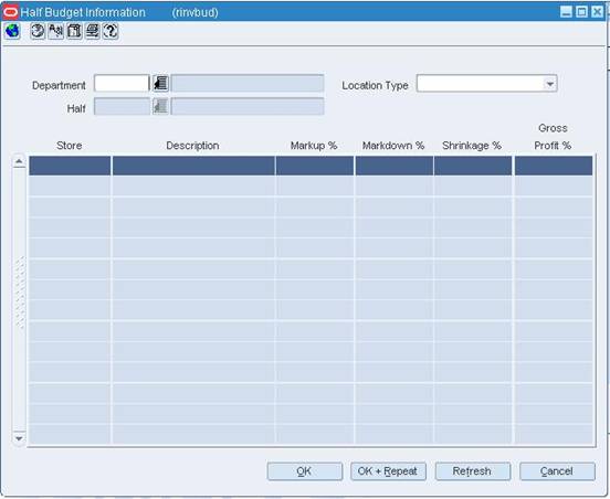

Navigate: From the main menu, select Finance > Half Budget Information > View. The Half Budget Information window opens.
In the Half field, enter the ID of the half, or click the LOV button and select the half. The budget details appear by location.
In the Location Type area, select the appropriate type of location.
Navigate: From the main menu, select Finance > Half Budget Information > Edit. The Half Budget Information window opens.
Edit the markup, markdown, and shrinkage percentages as necessary. The gross profit percentage is adjusted based on the changes that you make.

The Half Budget Information window allows you to maintain budget information at the department and half level for either all stores or all warehouses. You can edit the following percentages as a percentage of sales:
Markup percentage (cumulative markon)
Markdown percentage
Shrinkage percentage
The gross profit percentage is automatically calculated from the markup, markdown, and shrinkage percentages that you enter.

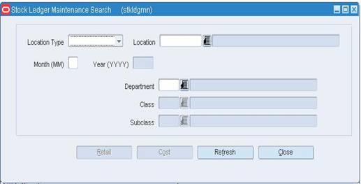

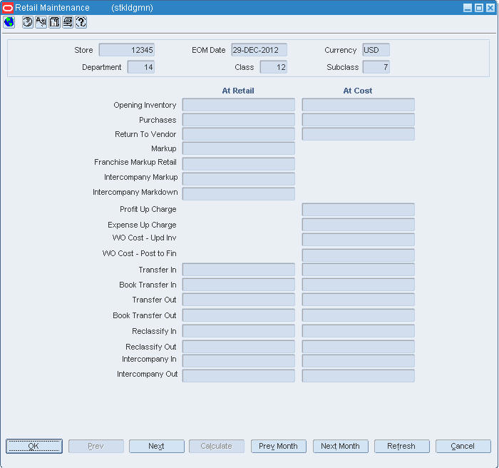

The Stock Ledger Maintenance Window allows you to view stock ledger details by subclass/location/month. Details vary based on the setup for each department.
Navigate: From the main menu, select Finance > Stock Ledger Maintenance > Edit. The Stock Ledger Maintenance Search window opens.
In the Location field, enter the ID of a specific location, or click the LOV button and select the location.
In the Month and Year fields, enter the month and year for which you want to edit the stock ledger records.
In the Department, Class, and Subclass fields, enter the ID of a specific member at each product level, or click the LOV buttons and select the members.
Click either Retail or Cost. The details appear in the Stock Ledger Maintenance window.
Edit the details as necessary.
Note: If you are editing the retail information, click Next to view and edit additional fields. |

Navigate: From the main menu, select Finance > Stock Ledger Maintenance > View. The Stock Ledger Maintenance Search window opens.

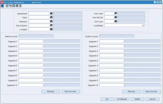

The GL Cross Reference window allows you to cross-reference the merchandise hierarchy levels and transaction codes from RMS with the appropriate general ledger accounts within your financial system.
Navigate: From the main menu, select Finance > General Ledger. The General Ledger Search window opens.
Search for and retrieve a cross reference in View mode. The GL Cross Reference window opens.
Click OK to close the window.
Navigate: From the main menu, select Finance > GL Cross Reference. The General Ledger Search window opens.
In the Action field, select New.
Click OK. The GL Cross Reference window opens.
Enter the merchandise hierarchy information as necessary, or click the LOV button and select the merchandise hierarchy information.
In the Tran Code field, select the transaction type. The Line Type field is filled.
In the Tran Ref No. field, select the reference information associated with the transaction code.
Note: This field is enabled only for certain transactions. It is a dynamic field and will be labeled depending on the transaction code selected. |
In the Cost/Retail field, select the accounting method.
In the Debit Account area, enter the segments that make up the account.
Click Find Account. The Debit Account field is displays the account number.
In the Credit Account area, enter the segments that make up the account.
Click Find Account. The Credit Account field is displays the account number.

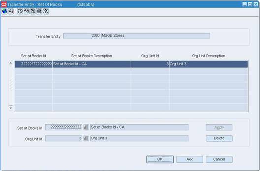

Between set of books ID and the organizational unit ID there would be one-to-many relationships. One set of books ID can be mapped to multiple organizational units, but one organizational unit will be mapped to only one set of books ID.

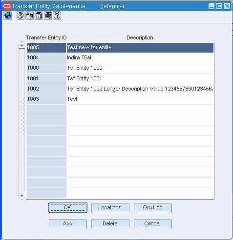

Navigate: From the main menu, select Control > Setup > Transfer Entities > Edit. The Transfer Entity Maintenance window opens.
Select a transfer entity with a multiple set of books.
Click Org Unit. The Transfer Entity - Set of Books window opens.
Click Add.
In the Set of Books ID field, select an ID.
In the Org Unit ID field, select an ID.
Click Apply. The association is applied to the transfer entity.
Click OK to save any changes and close the window.

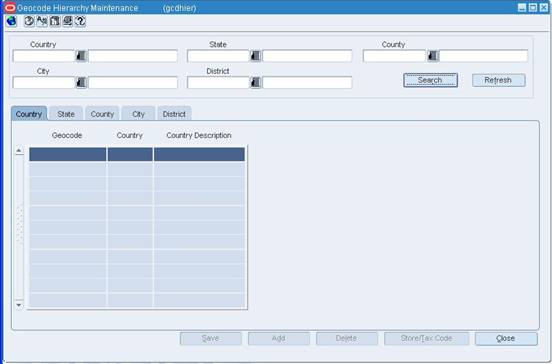

When you define sales tax information, you must first add geocodes to RMS. A geocode is a geographical region, such as a state or county, with its own tax codes. You can add geocodes for the following:
Countries
States
Counties
Cities
Districts

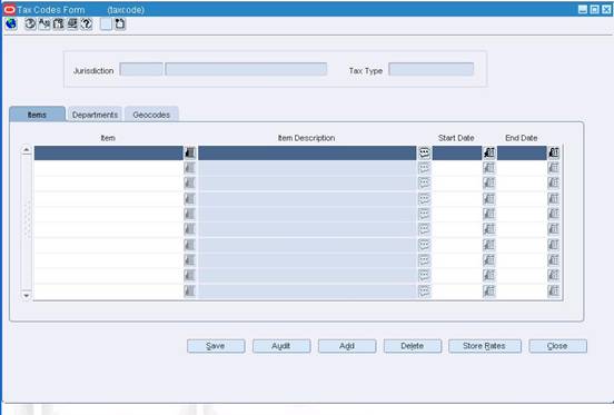

Click Item/Geocode. The Tax Codes Form window opens.
Select an item in the table on the Items tab.
Click Delete.
When prompted to delete the item, click Yes.
Click Close to close the window.
When prompted to save the changes, click Yes.
Navigate: From the main menu, select Control > Sales Tax > Tax Rate Maintenance > Edit. The Tax Hierarchy window opens.
On the Tax Jurisdictions tab, select a tax jurisdiction.
Click on the Tax Codes & Rates tab.
Select a tax type in the tax type table.
Click on the Department tab.
Select a department in the table.
Click Delete.
When prompted to delete the department, click Yes.

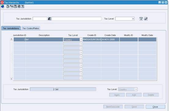

Click Add. The fields in the Apply area are cleared.
In the Tax Jurisdiction field, enter a unique ID for the tax jurisdiction in the first field and a description in the second field.
In the Tax Level field, select the tax level of the tax jurisdiction.
Click Apply. The tax jurisdiction is added to the table.
Click Close to close the window. When prompted to save the changes, click Yes.
Note: You cannot delete a tax jurisdiction that is part of an active tax code. |

Navigate: From the main menu, select Control > Sales Tax > Geocode Maintenance > Edit. The Geocode Hierarchy Maintenance window opens.
Click Search. The geocode tables and buttons are enabled.
Click Add.
In the Country field, enter the geocode for the country.
In the Country Description field, enter the description of the country.
Click on the State tab.
Click Add.
In the Country field, enter the geocode of the country, or click the LOV button and select a country.
In the State field, enter the geocode for the state.
In the State Description field, enter the description of the state.
Click on the County tab.
Click Add.
In the State field, enter the geocode of the state, or click the LOV button and select a state.
In the County field, enter the geocode for the county.
In the County Description field, enter the description of the county.
Click on the City tab.
Click Add.
In the County field, enter the geocode of the county, or click the LOV button and select the county.
In the City field, enter the geocode for the city.
In the City Description field, enter the description for the city.
Click on the District tab.
Click Add.
In the City field, enter the geocode of the city, or click the LOV button and select the city.
In the District field, enter the geocode for the district.
In the District Description field, enter a description for the district.

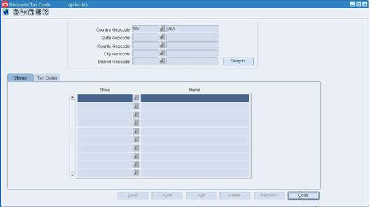

Click Store/Tax Code. The Geocode Tax Code window opens.
On the Stores tab, select the store.
Click Delete.
When prompted to delete the store, click Yes.
Click Add.
In the Store field, enter the ID of the store, or click the LOV button and select a store.
Click on the Tax Codes tab.
Select the tax code.
Click Delete.
Click the Tax Codes tab.
Click Add.
In the Tax Jurisdiction field, click the LOV button and select a tax code.
in the Start Date field, enter the date on which the tax code is valid for the geocode, or click the calendar button and select a date.
Click Add Code.
In the Tax Type field, select the type of tax.
Click Add Rate.
In the Tax Rate field, enter the tax rate.
In the Start Date field, enter the date on which the tax rate is effective, or click the calendar button and select the date.
When applicable, enter the date on which the tax rate ends in the End Date field, or click the calendar button and select the date.
Note: Tax rates for the same tax type cannot have overlapping start and end dates. |
Click the Department tab.
Click Add.
In the Department field, enter the ID of the department, or click the LOV button and select a department.
In the Start Date field, enter the date on which the tax code is effective for the department, or click the calendar button and select a date.
When applicable, enter the date on which the tax code ends in the End Date field, or click the calendar button and select the date.
Click Close to exit. When prompted to save the changes, click Yes.
Note: Tax codes for a department are applied when an item is sold at the department level. |
Click on the Geocodes tab.
Click Add.
To associate a country geocode with a tax code:
In the Country ID field, enter the geocode of the country, or click the LOV button and select a country.
To associate a state geocode with a tax code:
Associate geocode as described in step 4.
In the State ID field, enter the geocode of the state, or click the LOV button and select a state.
To associate a county geocode with a tax code:
Associate geocodes as described in steps 4 - 5.
In the County ID field, enter the geocode of the county, or click the LOV button and select a county.
To associate a city geocode with a tax code:
Associate geocodes as described in steps 4 - 6.
In the City field, enter the geocode of the city, or click the LOV button and select a city.
To associate a district geocode with a tax code:
Associate geocodes as described in steps 4 - 7.
In the District field, enter the geocode of the district, or click the LOV button and select a district.
Click Add.
In the Item field, enter the item number, or enter a partial description of the item and click the LOV button to select an item.
In the Start Date field, enter the date on which the tax code is effective for the item, or click the calendar button and select a date.

Click Add.
In the Tax Juris ID field, enter the ID of the tax jurisdiction, or click the LOV button and select the tax jurisdiction.
In the Start Date field, enter the date on which the tax code becomes effective, or click the calendar button and select the date.
When applicable, enter the date on which the tax code end in the End Date field, or click the calendar button and select the date.
Enter search criteria as desired to make the search more restrictive.
Click Search. The tax jurisdictions that match the search criteria appear on the results table.
Select a tax jurisdiction. Click the Tax Code Rates tab in order to display the tax code level with which you want to work.
When prompted to save any changes, click Yes to save or No to close without saving.

The Geocode Tax Code window allows you to associate stores and tax codes with a geocode. You also can delete stores and tax codes from geocodes.
The association of the tax codes and stores with a geocode determines which tax codes are effective at a specific store. You associate stores with a geocode. You then associate the tax codes with a geocode. As a result, all of the tax codes associated with a geocode are effective at all of the stores associated with a geocode.
You cannot delete active tax codes from a geocode. A tax code is active after it has been sent to the point of sale system through a batch process. The tax code information is sent to the point of sale system two days before the tax code is effective at a store.
If you do not specify an end date for the relationship between a geocode and a tax code, the association remains active as long as the tax code is active.
See "View Stores Associated with a Geocode" in the Foundation Data chapter
See "View Tax Codes Associated with a Geocode" in the Foundation Data chapter
The Geocode Hierarchy Maintenance window allows you to add, delete, and view geocodes at several levels. A geocode is a geographical region, such as a state or county, with its own tax codes. You can add geocodes for the following:
Countries
States
Counties
Cities
Districts
Once you have added geocodes to RMS, you can then associate stores and tax codes with the geocode. A store can be associated with only one geocode. Multiple tax codes can be associated with multiple geocodes. The tax codes of a geocode are active at the stores of the geocode. At the store, an item derives its tax rates from the tax codes that it shares with the store.
Geocodes can be uploaded into RMS using a standard batch program.
