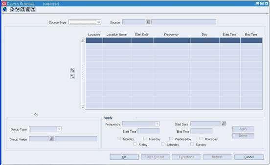

Add a Delivery Schedule at the Store or Warehouse Level
Navigate: From the main menu, select Action > Organizational Hierarchy. The Organization Hierarchy Main Form window opens. Select Store on the tree structure. The stores appear on the table. Select a store and click Edit. The Store Maintenance window opens. From the Options menu, select Delivery Schedule. The Delivery Schedule window opens.
or
Navigate: From the main menu, select Action > Organizational Hierarchy. The Organization Hierarchy Main Form window opens. Select Warehouse on the tree structure. The warehouses appear on the table. Select a warehouse and click Edit. The Warehouse Maintenance window is displayed. From the Options menu, select Delivery Schedule. The Delivery Schedule window opens.
or
Navigate: From the main menu, select Control > Supplier > Maintenance. The Supplier Search window opens. Search for and retrieve a supplier site. The Supplier Maintenance window opens. From the Options menu, select Delivery Schedule. The Delivery Schedule window opens.
Figure 11-3 Delivery Schedule Window
In the Source Type field, select the type of source for the delivery schedule.
  1. In the Source field, enter the ID of the supplier or source warehouse, or click the LOV button and select the supplier or warehouse.
  2. In the Group Type field, select the type of grouping mechanism or location for the delivery schedule.
  3. In the Group Value field, enter the ID of the grouping mechanism or location for the delivery schedule, or click the LOV button and select a grouping mechanism or location.
    You can also use the Organizational Hierarchy Tree to navigate to the grouping mechanism or location to which you are adding a delivery schedule. The Group Type and Group Value fields are filled in automatically.
  4. In the Frequency field, select how often you want the supplier to deliver to the locations.
  5. In the Start Date field, enter the date on which the delivery schedule is effective.
  6. In the Start Time field, enter the time that the delivery is scheduled to begin at the location.
  7. In the End Time field, enter the time that the delivery is scheduled to end at the location.
  8. To select the delivery day for a delivery schedule:
    • If the frequency is every day, all the days of the week are selected automatically for the delivery schedule.
    • If the frequency is every week, select the day of the week.
      You can select more than one delivery day if the frequency is every week.
    • If the frequency is every two or more weeks, select the day of the week.
    • Click Apply.

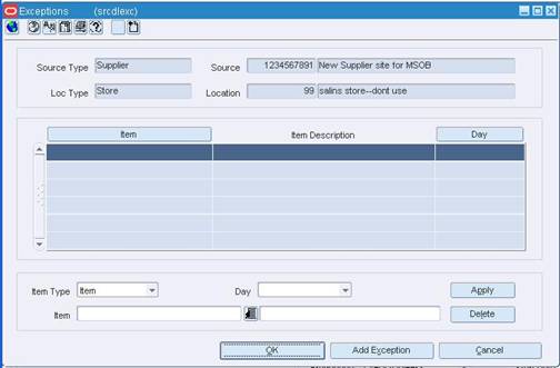

  9. To add an exception to a delivery:
    1. Click Exceptions. The Exceptions window opens.
      Figure 11-4 Exceptions Window
      Exceptions Window
    2. Click Add Exceptions to enable the next available line.
    3. In the Item Type field, select Item or Item List.
    4. In the Day field, select the day on which you do not want the item or item list delivered.
    5. In the Item field, enter the item number or the ID of the item list, or enter a partial description and click the LOV button to select the item or item list.
    6. Click Apply.

Add a Delivery Schedule for a Supplier
Navigate: From the main menu, select Control > Supplier. The Supplier Search window opens. Search for and retrieve a supplier site in Edit mode. The Supplier Maintenance window opens.
or
If the Financials module is installed, from the main menu, select Control > Supplier > Maintenance from the main menu. Search for and retrieve a supplier site in Edit mode. The Supplier Maintenance window opens. From the Options menu, select Delivery Schedule. The Delivery Schedule window opens.
Figure 11-5 Delivery Schedule Window
  1. In the Group Type field, select the type of grouping mechanism or location for the delivery schedule.
  2. In the Group Value field, enter the ID of the grouping mechanism or location for the delivery schedule, or click the LOV button and select a grouping mechanism or location.
  3. In the Frequency field, select how often you want the supplier to deliver to the locations.
  4. In the Start Date field, enter the date on which the delivery schedule is effective.
  5. In the Start Time field, enter the time that the delivery is scheduled to begin at the location.
  6. In the End Time field, enter the time that the delivery is scheduled to end at the location.
  7. To select the delivery day for a delivery schedule:
    1. If the frequency is every day, all the days of the week are selected automatically for the delivery schedule.
    2. If the frequency is every week, select the day of the week. You can select more than one delivery day.
    3. If the frequency is every two or more weeks, select the day of the week.
    4. Click Apply.
  8. To add an exception to a delivery:
      Figure 11-6 Exceptions Window
      Exceptions Window
    6. Click Apply.
    7. Click OK to exit the Exceptions window.

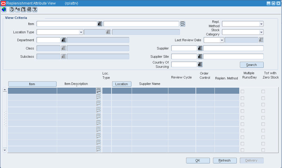

Replenishment Attribute View Window [rplattrv]
The Replenishment Attribute View window allows you to search for replenishment information for items by various criteria. You can view results of your search by criteria of each replenishment method, delivery schedules, packs on replenishment, or you can create your own custom view.
  • See "View Replenishment Attributes for Multiple Items" in the Item Maintenance chapter

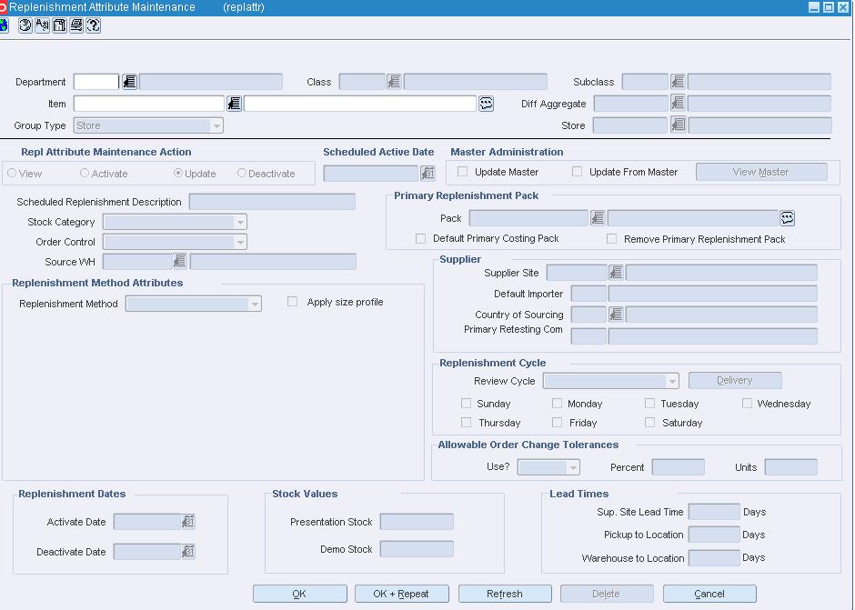

Add Replenishment Attributes to an Item or Item List
Navigate: From the main menu, select Items > Items. The Item Search window opens. Search for and retrieve an item in Edit mode. The Item Maintenance window opens. On the Options list, select the Replenishment option. The Replenishment Attribute Maintenance window opens.
or
Search for and retrieve an item list in Use mode. The Item List Header window opens. From the Options menu, select Create Mass Item Change > Replenishment. The Replenishment Attribute Maintenance window opens.
Figure 11-9 Replenishment Attribute Maintenance Window
  1. In the Group Type field, select the group type.
  2. In the Group Type Value field, enter the ID of the group or location, or click the LOV button and select a group or location.
  3. In the Replenishment Attribute Maintenance Action area, select Activate.
  4. In the Scheduled Active Date field, select the date the new replenishment attributes become active.
    For a single item, leave the field blank to make the replenishment attributes effective immediately.
  5. In the Master Administration area, select:
    • Update Master to update the master replenishment attributes with the replenishment attributes you are adding.
    • Update From Master to update the replenishment attributes with the attributes recorded on item master.
  6. In the Stock Category field, select the method by which the item is sourced and delivered to the stores.
  7. In the Order Control field, select how purchase orders are created for the item.
  8. In the Source WH field, enter the ID of the warehouse from which the item is sent, or click the LOV button and select a warehouse.
Select a Replenishment Method
  1. In the Replenishment Method field, select the replenishment method for the item.
  2. Enter the replenishment parameters in the associated replenishment fields.
Specify the Replenishment Dates
  1. In the Activate Date field, enter the date on which the replenishment attributes are effective for the item, or click the calendar button and select the date.
  2. In the Deactivate Date field, enter the date on which the replenishment attributes are no longer effective for the item, or click the calendar button and select the date.
Define the Primary Replenishment Pack
  1. Enter the pack ID number that identifies the pack, or click the LOV button and select the replenishment pack.
  2. Select the Default Primary Costing Pack to indicate the pack is the costing pack for replenishment.
  3. Select Remove Primary Replenishment Pack to indicate the primary replenishment pack is removed.
Specify the Supplier for the Replenishment of the Item
  1. In the Supplier field, enter the ID of the supplier for the item, or click the LOV button and select a supplier.
  2. In the Country of Sourcing field, enter the code of the country of origin, or click the LOV button and select a country.
Define the Replenishment Cycle
  1. In the Review Cycle field, select the frequency that the item is reviewed for replenishment.
  2. To select the day on which the item is reviewed:
    • If the review cycle is every day, all the days of the week are selected automatically for the delivery schedule.
    • If the review cycle is every week, select the days of the week. You may select more than one day.
  3. To view the Delivery Schedule for the item, click Delivery. The Delivery Schedule window opens.

Define Allowable Order Change Tolerances
Order change tolerances do not apply to replenishment transfers.
  1. In the Use? field, select whether replenishment order quantities can be changed.
  2. To define the amount of change allowed:
    • In the Percent field, enter the percentage by which you can change the order quantity.
    • In the Units field, enter the amount by which you can change the order quantity.
Define Stock Values
  1. In the Presentation Stock field, enter the quantity of presentation stock for the item.
  2. In the Demo Stock field, enter the quantity of the demonstration stock for the item.
    This field is not required when you are adding replenishment attributes for an item at a warehouse.
Specify the Lead Times for the Item
  1. In the Supplier Lead Time field, enter the number of lead days the supplier needs.
  2. In the Pickup to Location field, enter the number of days it takes for the item to reach the store or warehouse.
    This field is required for direct to store and cross-docked items.
  3. In the Warehouse to Locn field, enter the number of days it takes for the item to reach the store.
    This field is required for cross-docked and warehouse stocked items.
  4. Click OK to save your changes and close the window.
Replenishment Attribute Maintenance Window [replattr]
The Replenishment Attribute Maintenance window allows you to add, edit, and view the replenishment parameters for an item/item list and location or for an item/item list and location group. In addition to setting replenishment parameters, you can also:
  • Select the stock category.
  • Indicate the type of order control used for the item at the location selected.
  • Select the supplier for the item.
  • Determine the replenishment review cycle.
To view more information on these topics, see also:

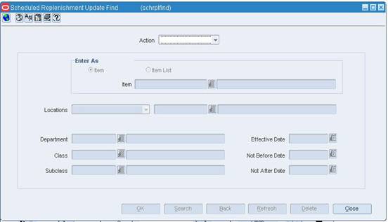

Search for Scheduled Replenishment Attributes
Navigate: From the main menu, select Items > Replenishment Scheduled Update. The Scheduled Replenishment Update Find window opens.
or
From the main menu, select Items > Items. The Item Search window is displayed. Search for and retrieve an item in Edit or View mode. The Item Maintenance window opens. From the options list, select Replenishment. The Replenishment Attribute Maintenance window opens.
Figure 11-11 Scheduled Replenishment Update Find Window
  1. In the Action field, select either Edit or View.
  2. Enter additional criteria as desired to make the search more restrictive.
  3. Click Search. The Scheduled Replenishment Update Find window displays the items that match the search criteria.
  4. Select a task:
    • To perform another search, click Refresh or Back.
    • To display the deal information, select a record and click OK. The Replenishment Attribute Maintenance window is displayed.
  5. Click Close to close the window.

Review Items on Replenishment
Navigate: From the main menu, select Items > Replenishment > Edit. The Replenishment Attribute View window opens.
Figure 11-13 Replenishment Attribute View Window
  1. Enter as much information as necessary to limit the search.
  2. Click Search. Results appear on the table.
  3. To perform a new search, click Refresh.
  4. To display alternate information pertinent to replenishment, from the view menu, select an applicable view.
  1. Click Delivery. The Delivery Schedule window opens.
  9. If the frequency is every day, all the days of the week are selected automatically for the delivery schedule.
  10. If the frequency is every week, select the day of the week.
  11. If the frequency is every two or more weeks, select the day of the week.
  12. Click Apply.
  13. To add an exception to a delivery:
    1. Click Exceptions. The Exceptions window is displayed.
    6. Click Apply.
    7. Click OK to save your changes and close the window.
  14. Click OK to save your changes and close the window.

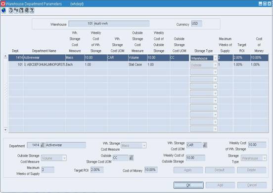

Add Investment Buy Attributes to a Warehouse
Navigate: From the main menu, select Actions > Organizational Hierarchy. The Organization Hierarchy Main Form window opens. Select Warehouse on the tree structure. The warehouses appear in the table. Select a warehouse and click Edit. The Warehouse Maintenance window is displayed.
In a multi-channel environment: From the Options menu, select Virtual Warehouse. The Virtual Warehouse Maintenance window opens. From the Options menu, select Warehouse Department Parameters > Edit. The Warehouse Department Parameters window opens.
In a single channel environment: From the Options menu, select Warehouse Department Parameters > Edit. The Warehouse Department Parameters window opens.
Figure 11-14 Warehouse Department Parameters Window
  1. In the Apply area, enter the department ID, or click the LOV button and select a department.
  2. In the Wh. Storage Cost Measure, select the warehouse storage cost measure.
    To enter the system control information for investment buy, click Default. The Wh. Storage Cost UOM, the Weekly Cost of Warehouse Storage, the Outside Storage Cost UOM, the Weekly Cost of Outside Storage, the Storage Type, the Maximum Weeks of Supply, the Target ROI, and the Cost of Money are filled in.
  3. In the Wh. Storage Cost UOM, select the unit of measure if appropriate.
  4. In the Weekly Cost of Warehouse Storage field, enter the weekly cost of warehouse storage.
  5. In the Outside Storage Cost Measure, select the outside storage cost measure.
  6. In the Outside Storage Cost UOM, select the unit of measure if appropriate.
  7. In the Weekly Cost of Outside Storage field, enter the weekly cost of outside storage.
  8. Enter the Maximum Weeks of Supply, Target ROI, and Cost of Money.
  9. Click Apply to enter the information into the table. This information will be used in investment buy calculations.
  10. Click OK to save your changes and close the window.

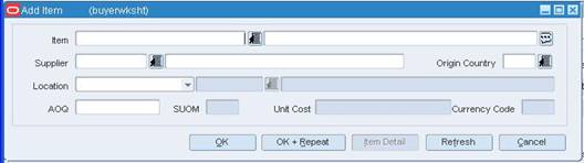

Add an Item to the Buyer Worksheet
Navigate: From the main menu, select Ordering > Buyer worksheet > Edit. The Buyer Worksheet opens.
  1. Click Add Item. The Add Item window opens.
    Figure 11-16 Add Item Window
    Add Item Window
  2. Enter the ID of the item, or click the LOV button and select the item.
  3. Enter the ID of the supplier, or click the LOV button and select the supplier.
  4. Enter the ID of the country of sourcing, or click the LOV button and select the country of sourcing.
  5. In the location field, select the location type. Enter the ID of the location, or click the LOV button and select the location.
  6. In the AOQ field, enter the adjusted order quantity.
  7. Modify the unit cost in the unit cost field, if required.
  8. Click OK to add the item to the buyer worksheet, or click OK+Repeat to add the item to the buyer worksheet and add a new item.
  9. When prompted to requery, click Yes.

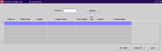

Add an Item to an Existing PO from the Buyer Worksheet
Navigate: From the main menu, select Ordering > Buyer worksheet > Edit. The Buyer Worksheet opens. Filter the Buyer Worksheet to retrieve items
  1. In the Details area, select the check box next to the items you want to add to the PO.
  2. Click Add to PO. The Purchase Order List window opens.
    Figure 11-17 Purchase Order List Window
  3. Enter the PO number that you would like to add the item to, or leave the field blank to display a list of valid PO's. Click Search.
  4. Select the PO to which you wish to add the item.
  5. Click Add to PO.
    Note: Once an item is added to a PO, it can no longer be edited from the Buyer Worksheet module.
  6. Click Yes to add the item to the PO.
