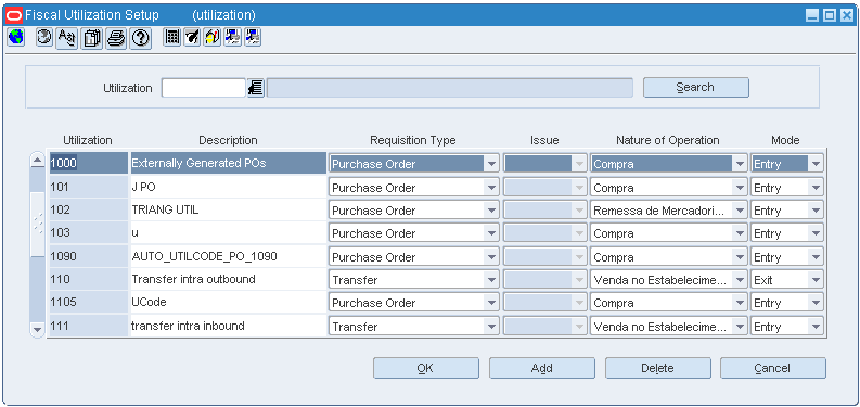

To add a Utilization Code, do the following:
Navigate: From the RMS Start Menu, select Fiscal Management, then Fiscal Configuration.
In the Contents Of Fiscal Configuration, select Fiscal Utilization.
In the Contents Of Fiscal Utilization window, click Edit. The Fiscal Utilization Setup window appears.
Note: Click View in the Contents Of Fiscal Utilization window to view the fiscal utilization codes. In the View mode, the multi-record block is non-editable, and the Add and Delete buttons are disabled. |
On the Fiscal Utilization Setup window, click Add. A highlighted blank row appears.
Enter the Utilization Code, and Description. The Utilization Code is the unique identifier for each utilization. The Description column describes the fiscal utilization.
Select the Requisition Type from the list in the Req.Type column. The requisition types are: Purchase Order, Transfer, Return to Vendor, Return Merchandise Authorization, Stock Out, PO for Rural Producer, InterCompany Transfers, Repairing, Return NF, and Sales.
Select the Issue from the list in the Issue column. The issue types are: Issue or Include. The drop-down is enabled if the Requisition Type is either, Direct NF or Free from NF. The drop-down value of Issue indicates that the utilization code is relevant for cases wherein the Retailer is issuing the NF. When utilization codes classified as Issue are used for StandAlone NF creation, the Fiscal number, Serial, and Sub Serial Number fields are populated based on Location sequencing Logic. The drop-down value Include, indicates that the NF is issued by an external system. StandAlone NFs using utilization code classified as Include will have a mode type of entry and it allows for manual entry of the Fiscal number information.
Specify the Nature of Operation.
Enter the mode of operation. The Mode is either Entry or Exit.

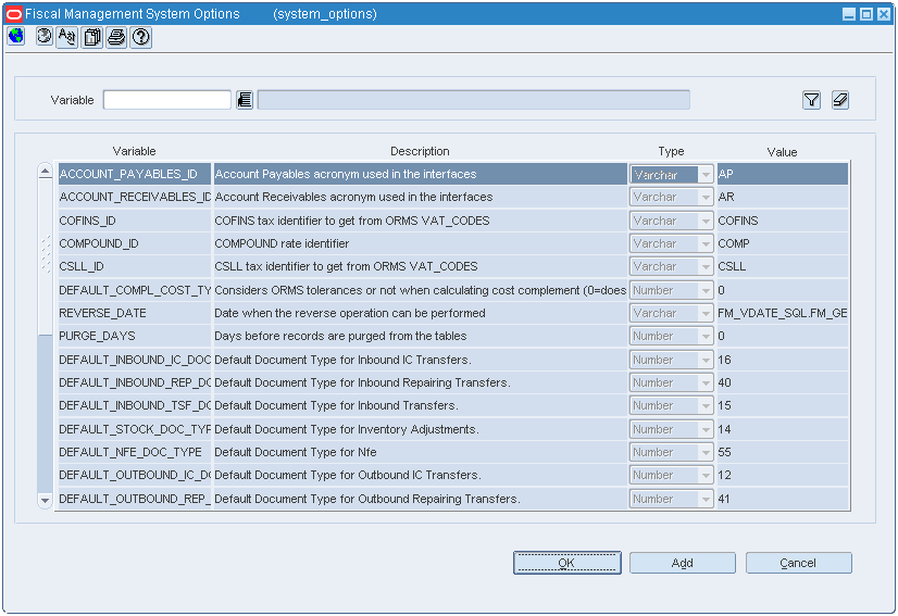

These system options help in the successful functioning of the fiscal management system.
The system options, and their descriptions are given below.
Table 2-4 Fiscal Management System Options
| System Option | Description |
HOUR_FORMAT |
Format to represent fields of hour |
PURGE_DAYS |
Days before records are purged from the tables |
ORIGIN_CST_IND |
Default Origin Code and CST Type for ICMS tax situation |
DOC_TYPE_PO |
Default fiscal doc type code (example: 1 - Nota Fiscal - Modelo 1, 1A) |
PERCENT_FORMAT |
Percentage Field Format |
NUMBER_FORMAT |
Value Field Format |

To set up the System Options, do the following:
Navigate: From the RMS Start Menu, select Fiscal Management, then select System Setup.
In the Contents Of System Setup window, select System Options.
In the Contents Of System Options window, click Edit. The System Options window appears.
Click the Variable field LOV to view the description and variables.
Click Add. A new row is displayed.
Note: Adding parameters will not have any impact on the system functionality. |
Enter the details in the Variable and Description fields.
Select the Type from the list.
Enter the details in the Value field.
Click OK to exit the window.

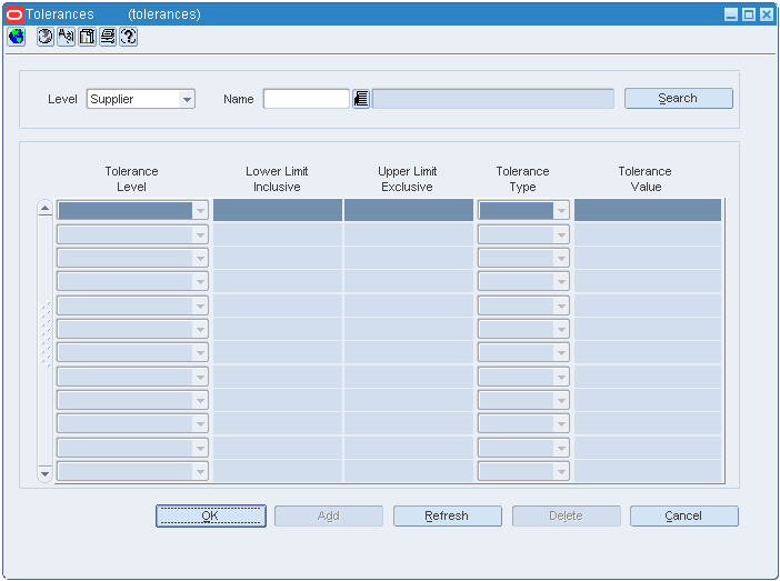

Tolerance is the variance allowed between a NF and the requisition document, and also within a NF. If the NF is within tolerances, then the NF can be considered matched (without discrepancy). ORFM supports the following three types of tolerances:
Cost Tolerance: Use it when comparing the unit cost of the item on the PO as against the unit cost of the item on the NF.
Quantity Tolerance: Use it when matching the quantity ordered, against the quantity provided in NF for each item.
Calculation Tolerance: Use it to avoid the NFs from going into discrepancies due to rounding or truncation issues.
Note: The cost, and quantity tolerances can be set in the Tolerance Maintenance screen of the ORFM, and calculation can be set as a system variable. |
To set up the tolerances, do the following:
In the Contents Of System Setup window, select Tolerances.
In the Contents Of Tolerances window, click Edit. The Tolerances window appears.
In the Tolerances window, the list in the Level field has two values – Supplier, and Company. Select the level applicable.
The Name field displays the list of all the Supplier names or Company names based on the level selected. Select the supplier, or the company name.
Click Search. The existing tolerances for the supplier or company is displayed in the multi-record block. If there are no tolerances for the selected level, the following message is displayed: "Query caused no records to be retrieved".
If there are tolerances for the selected values, the following parameters are displayed in the multi-record block:
Tolerance Level – Choose from Line Quantity, and Line Cost.
Lower Limit Inclusive – The lower limit for the range. This value is included in the range.
Upper Limit Exclusive – The upper limit for the range. This value is excluded from the range.
Tolerance Type – Select the Requisition Document Tolerance Type from the list. The list includes Percentage or Value.
Tolerance Value – Enter the tolerance value for matching between the NF and the requisition document of the NF.
Click OK to save the changes.
The other options available on the window includes:
Click Add to add a new row in the multi-record block.
Click Delete to delete the selected row from the multi-record block.
Click Refresh to clear the filter criteria, and the data in the multi-record block.
Click Cancel if you do not want to save the changes that you have entered.
Note: Select View mode in the Contents Of Tolerances window to view the tolerances. The Add and Delete button in the Tolerances window are disabled. |

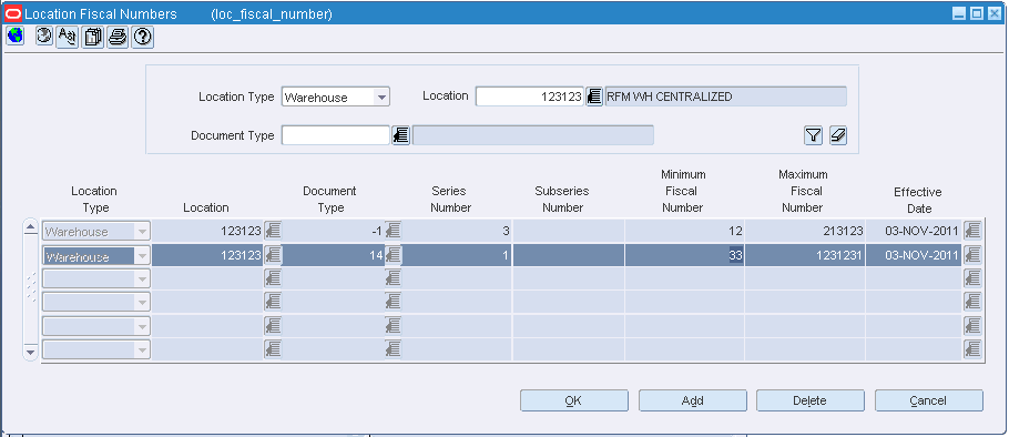

Location Fiscal Numbers are numbers assigned to a store/warehouse. In Brazil, the sequence of NF document numbers are controlled and should be correctly followed during the NF issuing process.
Each location controls its own sequence based on the following fields:
Documentation Type
Serial/Sub-serial
Sequence
Effective Date
Any transaction that involves that particular store/warehouse should contain the fiscal numbers falling within a particular range.
To add fiscal numbers, do the following:
Navigate: From the RMS Start Menu, select Fiscal Management, then System Setup. From System Setup, select Fiscal Numbers.
In the Contents Of Fiscal Numbers window, click Edit. The Location Fiscal Numbers window appears.
To add a number, select the store/warehouse from the Location LOV. Click Add. In the multi-record block, a row is highlighted as shown.
Assign values to Location, Document Type, Series Number, Subseries Number, Minimum Fiscal Number, Maximum Fiscal Number, and Effective Date.
Select the row that you want to delete in the Location Fiscal Numbers window.
Click Delete. The following message appears:
Click Yes to delete the row.
In the Contents Of Fiscal Numbers window, click View. The Location Fiscal Numbers window appears.
In the View mode, the Add, and the Delete button are disabled. By default, the Location Fiscal Numbers displays the locations, and their fiscal numbers.
Select the location type from the Location Type list. The Location field is highlighted after selecting the location type.
Select the location from the Location LOV.
Click the filter icon. Based on the filter criteria, the multi-record block displays the Location Type, the Location, and the values associated with the Document Type, Series Number, Subseries Number, Minimum Fiscal Number, Maximum Fiscal Number, and Effective Date.
