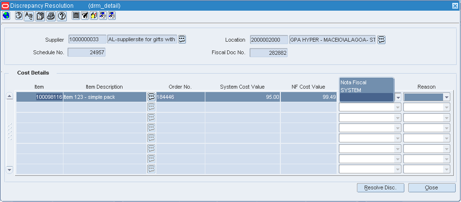

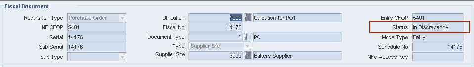

If the NF and the PO does not match, the NF is in discrepancy. You can identify the following discrepancies with the ORFM application:
Unit Cost Discrepancy for each item in the NF
Quantity Discrepancy for each item in the NF

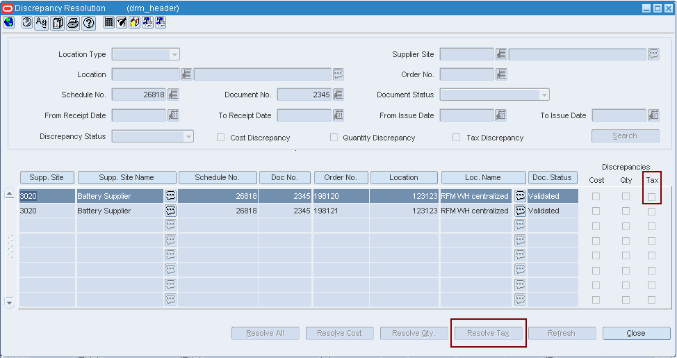

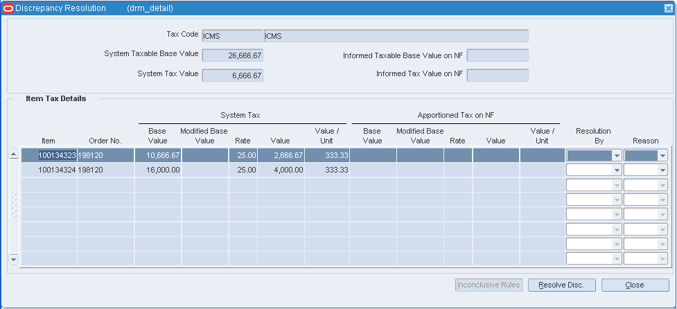

Tax Discrepancy happens between system (tax details from TaxWeb Tax Rules) and NF.

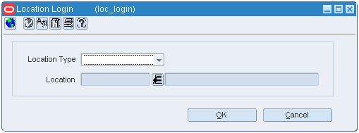

Navigate: From the RMS Start Menu, select Fiscal Management, then Login of Location. The Location Login window is displayed.
In the Location Login window, select the store or warehouse for receiving/issuing the fiscal document. Click the Location LOV to obtain the list of stores or warehouses. Select the location, and click OK.

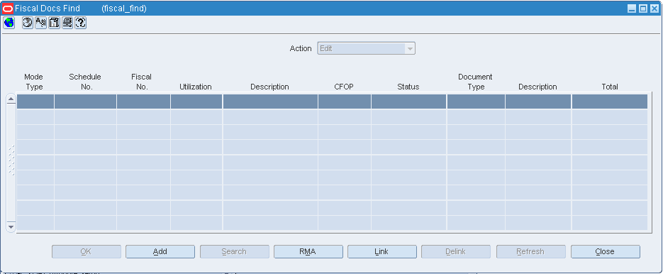

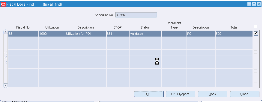

Click Fiscal in the Receiving/Issue Schedule window. The Fiscal Docs Find window is displayed. This screen displays all the NFs linked to that schedule.
In the Fiscal Docs Find screen, click Add. The Fiscal Documents window is displayed.

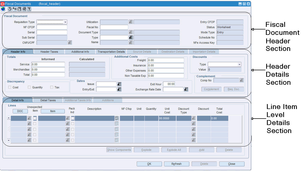

The Fiscal Documents window is divided into three sections – Fiscal Document Header, Header Detail, and Line Item Level Detail.
In the Fiscal Document Header section, enter the details as given in the table.
Table 3-2 Fields in the Fiscal Document Header Section
| Field | Description |
Requisition Type |
Select Purchase Order Requisition Type for the PO receiving transaction from the drop-down list. |
Utilization |
This field is enabled only when the Requisition Type is entered. Select the Utilization from the list that is specific to the PO operation. |
Entry CFOP |
This field is populated by the tax integration. The Entry CFOP is used for the fiscal bookkeeping and Public System of Digital Bookkeeping or SPED. This field is non-editable. Note: SPED (Sistema Público de Escrituração Digital) is a digital file composed of a group of bookkeeping registers of fiscal documents and other information that the fiscal authorities of Brazilian government are interested in. |
NF CFOP |
Enter the value for NF CFOP. CFOP is the Operations and Service-Providing Fiscal Code. |
Fiscal No |
Enter the fiscal number. If the system option DI_NF_SERIAL_GENERATION_IND is Y for a DI NF, then this field and series number are not enabled. It is generated using the location sequencing functionality of ORFM. |
Status |
Contains the possible status of the NF. When you are entering the details in the system, the status of NF is Worksheet. The NF has to be in Worksheet status to edit or cancel it. The other statuses are as follows:
Serial |
Enter the serial number for the NF. |
Document Type |
Select the document type for the PO from the Document Type LOV. |
Mode Type |
This field is populated from the Receiving/Issue Schedule screen. This field displays Entry for PO Receiving, and Exit for outbound operations. |
Sub Serial |
Enter the sub-serial number of the NF. |
Type |
This is an external entity type from which NF is received. You can select any one of the Type from the Type LOV. The Type LOV includes Supplier Site, Store, Warehouse, Company, Customer, Bank, Agent, Freight forwarder, Importer, Broker, Factory, Consolidator, Applicant, Consignee, Manufacturer, Distributor, Wholesaler. Expense Vendor, Import Authority, Escheat –State, Escheat-Country, External Finisher, Discharge Port, Lading Port, Entry Port, Return Center, Bill to Location, LC to Location, Routing Location, Clearing Zone. |
Schedule No |
This field is populated from the Receiving/Issue Schedule screen. It could be the number of the schedule receiving or the number of the schedule issuing. |
CNPJ/CPF |
CNPJ/CPF – Cadastro Nacional da Pessoa Jurídica (CNPJ) is the company code. Cadastro de Pes (CPF) is the personal code of the sender/receiver. This field is dimmed on the NF form. It takes the CNPJ/CPF number of the value in Type and Name fields in the form. For example, if Type = SUPP, Name/Supplier Site = 1000001010, the CNPJ number of the supplier site is displayed in the CNPJ/CPF field. Note:WAC will be updated for all the receiving location which have the same CNPJ, during PO/Transfer. |
Name |
Based on the Type, the user enters the values in this field. For example, if the Type is supplier, this field will have the supplier site value. |
NFe Access Key |
This field is not applicable for PO Receiving. Used to search NF-e. |

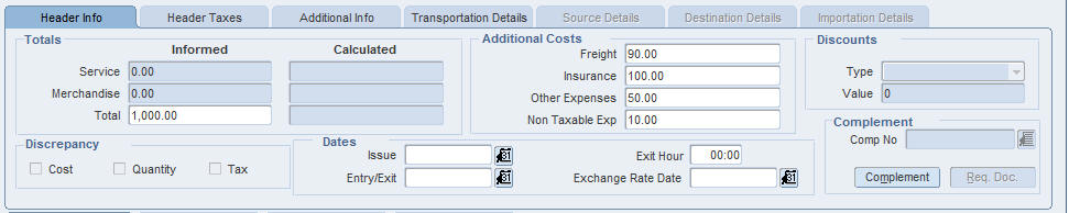

In the Header Details section, enter the following details – Header Info, Header Taxes, Additional Info, Transportation Details, Source Details, Destination Details, and Importation Details.
Figure 3-5 shows the Header Info Tab and the fields and description are provided in Table 3-3.
Table 3-3 Fields in the Header Info Tab
| Fields | Description |
Totals |
Informed and Calculated Service, Informed and Calculated Merchandise, and Informed and Calculated Total. Enter the details in each field. The Calculated Costs is obtained from the system. |
Additional Costs |
Freight, Insurance, Other Expenses, and Non Taxable Exp. When processing complementary NF for Freight, only these fields are enabled. |
Discounts |
Select Percentage or Value from the Type list. Enter the value in the Value field. |
Discrepancy |
Three check boxes, one each for Cost, Quantity and Tax are present. If the NF is in cost discrepancy, then the check box for Cost is selected. Likewise for Quantity and Tax. |
Dates |
Enter the Issue date, Entry/Exit date, Exit Hour of the NF, and Exchange Rate Date. Entry/Exit: The Entry/Exit date is updated to the date and time when the schedule is submitted to warehouse management system/store inventory management system for the physical receipt of merchandise. Exchange Rate Date: The Exchange Rate Date is introduced to support the multi currency functionality. For example, when you inform a PO NF for receiving, if the PO currency is different from NF currency, the exchange rate date keyed in will be considered for conversion into BRL on the NF. If left blank, the order approval will be considered. |
Complement |
Click Complement in the Header tab to link another NF (one that complements the main NF). In the ORFM application, the complement button is used for the following purposes:

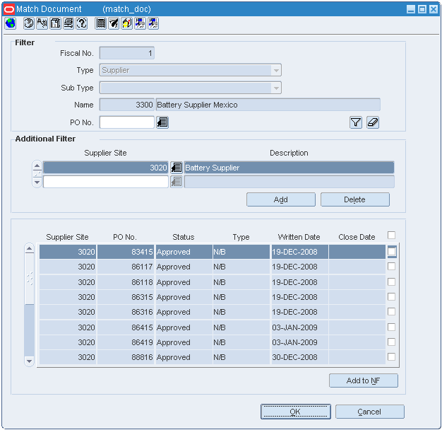

Req. Doc. |
Click Req. Doc. to view all the all the POs for the given supplier. For more details, refer to Step 8. |
Note: The Exchange Rate Date is a nullable field. For example, when informing PO NF values, if this field is null then the PO approval date is considered for all exchange rate calculations. |

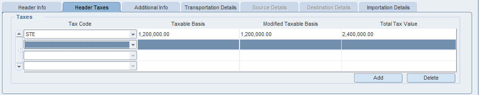

Figure 3-6 shows the Header Taxes Tab and the fields and description are provided in Table 3-4.
Table 3-4 Fields in the Header Taxes Tab
Tax Code |
The tax code that are part of the Brazilian tax system are present in the list. Select the tax code from the list. |
Taxable Basis |
Enter the taxable basis. |
Modified Taxable Basis |
This column displays the changed/modified taxable basis. This value flows from the external tax engine. In Brazil, some items are eligible to a tax rule that modifies the taxable basis. The tax rate for such items is applied on the modified taxable basis. |
Total Tax Value |
Enter the value. After entering the value for one tax code, click Add to enter additional details. In case, you want to delete any record, select the entry, and click Delete. |

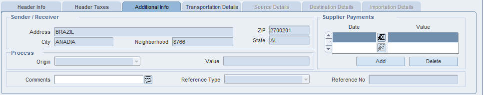

Figure 3-7 shows the Additional Info Tab and the fields and description are provided in Table 3-5.
Table 3-5 Fields and Description of Additional Info Tab
Sender/Receiver |
In this block, the following fields of the sender/receiver are auto populated:
These fields are taken from the Supplier/Supplier Site Address, City, and so on for a PO. |
Supplier Payments |
In this block, enter the following details for the supplier payments:
Click Add to add additional details. Click Delete in case you want to delete a record. |
Process |
In this block, select the Origin from the list. The Process list includes the following values:
In the Value field, enter the value. These fields meet SPED requirements. |
Comments |
You can capture comments or general information regarding the purpose behind creation of the StandAlone NF. |
Reference Type |
This field serves as a descriptor for data (that is the number/code) captured in the Reference Number field. The Reference Type list includes PO, Transfer, Bill of Lading (BOL), Shipment, Allocation, Advance Shipping Notice (ASN), Sale, Return, RTV, Mastersaf Tax Rules (MRT), Other. |
Reference No. |
This field supports entry of text or alphanumeric/numeric codes of transactions that the StandAlone NF might wish to associate/reference. |

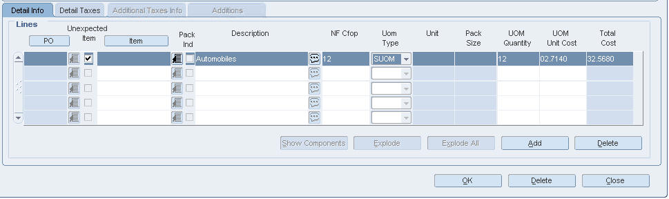

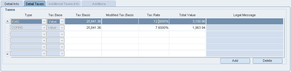

In the Line Item Level Details section, the detailed information of the purchase order (PO) and the items are displayed.
You can populate the Detail Info section of PO in the following three ways:

Click PO in the Detail Info tab of the Item Level Details section. Select the PO details from the list, or enter the PO details.
Figure 3-10 shows the Detail Info Tab and the fields and description are provided in Table 3-8.
Table 3-8 Fields and Description of the Detail Info Tab

Note: You can also view the Unit of Measurement (UOM) type by selecting UOM from the View menu. |
Figure 3-11 shows the Detail Info UOM View and the fields and description are provided in Table 3-9.
Table 3-9 Fields and Description of the Detail Info Tab UOM View
PO |
Enter the Purchase Order (PO) number. |
Unexpected Item |
Check this field if the item does not belong to any PO. |
Item |
Enter the item or items that are part of the purchase order. |
Pack Ind |
Enter the packet item indicator that are part of the purchase order. |
Description |
Enter the description of the item. |
NF Cfop |
This field displays the CFOP code from TaxWeb Tax Rules. |
UOM Type |
UOM type provides an option to associate an appropriate NF based UOM to an item. Select the UOM type from the following list:
Unit |
The unit cost of the item. Unit displays the corresponding SUOM if user selects UOM type as SUOM, Case, or Pallet. |
Pack Size |
Enter the pack size applicable. You are not allowed to update the pack size during NF entry. |
UOM Quantity |
Enter the UOM quantity applicable. |
UOM Unit Cost |
Enter the UOM unit cost applicable. |
Total Cost |
Enter the total cost applicable. |
Note: You cannot modify the Item or PO details in the default view that are modified in the UOM view. |
Note: You can search for an Item using the Vendor Product Number (VPN). See Searching using Vendor Product Number in the Fiscal Documents window for more information on searching for an Item using the VPN. |
Click the Req. Doc. button in the Header Details section. The Match Document window appears.
An example of the Match Document window is given below.
In the Match Document window, all the open POs of that particular supplier are displayed.
To include the PO details in the NF, do the following:
In the Additional Filter section of the Match Documents window, you can select POs from different supplier sites of the same supplier.
Click Add in the Additional Filter section of the Match Documents window to view the POs from different supplier sites of that particular supplier in the multi-record block.
Select one or more requisition documents from the list.
Click Add to NF. The item level information from those POs is defaulted on the NF. This saves significant data entry efforts.

In the Detail Taxes tab, enter the tax details for the item.
Table 3-10 Fields and Description of the Detail Taxes Tab
Type |
Indicates the type of tax such as ICMS, COFINS, and so on. |
Tax Base |
Indicates whether the tax is value-based or percentage-based. |
Tax Basis |
The basis for calculating the taxes. |
Modified Tax Basis |
Displays the modified or changed taxable basis. The external tax engine provides this basis, and this value is used for tax calculation. In Brazil, some items are eligible for a tax rule that modifies the taxable basis, mostly lower taxable basis. For such items, the tax rate is applied on the modified taxable basis. TaxWeb Tax Rules calculates the modified base and then calculates the tax values accordingly. |
Tax Rate |
The tax rate applied. |
Total Value |
The informed total value for the tax. |
Legal Message |
The legal message associated with the tax code at the line level. |
Note: If you enter detail level taxes, you have to enter the detail level taxes for each item which are on the Item Detail grid.The Totals on the Detail Taxes tab has to match the Header tax information within the tolerance level. |
See Figure 3-13 for an example of the Detail Taxes tab.

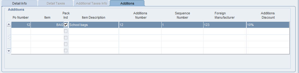

Note: Additions tab is enabled for Direct Import NF. |
Figure 3-14 shows the Additions Tab and the fields and description are provided in Table 3-11.

Navigate: From the RMS Start Menu, select Fiscal Management. In the Contents Of Fiscal Management, select Receiving/Issue. In the Contents Of Receiving/Issue, click Edit. The Receiving/Issue Schedule window appears.
Click Fiscal in the Receiving/Issue Schedule window. The Fiscal Docs Find window appears. This screen displays all the NFs linked to that schedule.
Click Link to link another NF to the schedule. The Fiscal Docs Find window appears.
Enter the query criteria in the Fiscal Docs Find window and execute the query. All NFs meeting the query criteria are displayed in the Fiscal Docs Find window.
Note: You can search for an item using fiscal number, or the VPN. See Searching using Vendor Product Number in the Fiscal Docs Find window for more information on searching for an Item using the VPN. |
In the Fiscal Docs Find window, check the NF to be linked to the schedule, and click OK. The Fiscal Docs Find window displays the list of NFs linked to the schedule.
Note: Click OK + Repeat to add another NF to the schedule. |

In this approach, the NF status is set to In Discrepancy if any discrepancy exists after validation.
You cannot submit the NF for receiving until all the discrepancies are resolved, and hence physical receiving before discrepancy resolution is not possible. Only after all the discrepancies are resolved, will the NF status change to Validated, and you can submit the NF for receiving.
The Fiscal Docs Find displays the status of NF as In Discrepancy as shown below:
If there is quantity, cost or tax discrepancy, the Fiscal Documents window displays the status of NF as In Discrepancy.
In the Header area of the Fiscal Documents window, the check box is selected for the discrepancy that is present on the NF as shown in Figure 3-20.

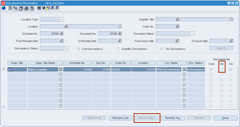

In the centralized discrepancy resolution process, the quantity discrepancy is resolved at the receiving location or at the centralized location. The cost and tax discrepancies may not be resolved, but the nota fiscal will be in Validated status. The process to resolve quantity discrepancy is given below.
In order to resolve quantity discrepancy, do the following:
From the Options menu in the Fiscal Documents window, select Discrepancy Resolution. The Discrepancy Resolution window appears.
As highlighted in Figure 3-21, the check box for Qty is selected to indicate quantity discrepancy.
Note: It is not necessary for the all the discrepancies to exist together. |
Click Resolve Qty in the Discrepancy Resolution window to resolve only quantity discrepancy. The Discrepancy Resolution window displays the quantity details.
In the Discrepancy Resolution window, the list in the Resolution Action field has two options – System or Nota Fiscal. Select one of the options. Click Resolve Disc.
Note: Depending on the system options set, ORFM decides the action to be taken for discrepancy resolution.For example, in case the system option is set to System, the Nota Fiscal option is disabled. You have to select System to resolve the discrepancy. |
The message – "Selected Resolution Action will be applied to all the discrepant records. Are you sure you want to continue?" is displayed. Click Yes. You are returned to the Discrepancy Resolution window. Notice that the check box for quantity is not selected, and the Resolve Qty button is disabled as highlighted in Figure 3-23.
Click OK. You are returned to the Fiscal Documents window. The status of the Nota Fiscal is changed to Validated, if no other discrepancies exist.

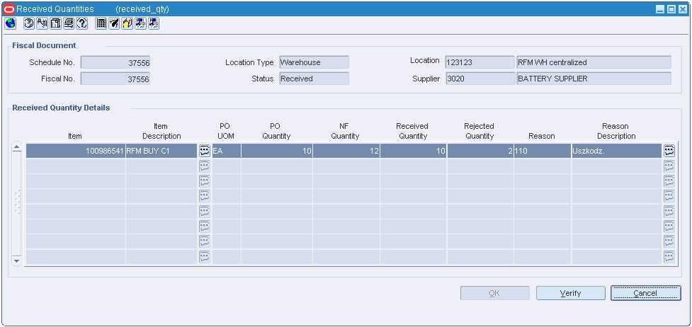

Since there is a quantity discrepancy, you have to review the received quantities, before the nota fiscal can be approved. From the Options menu, select Verify Received Qty. The Received Quantities window appears.
In the Received Quantities window, click Verify.
In this window, review the quantity of merchandise received. After reviewing the quantity of merchandise received, the status of the NF changes to Approved if there are no pending discrepancies to be resolved.
A correction document is generated, depending on what you have selected while resolving the quantity.

In order to resolve cost discrepancy, do the following:
From the Options menu in the Fiscal Documents window, select Discrepancy Resolution. The Discrepancy Resolution window is displayed.
As shown in Figure 3-26, if there is cost, and tax discrepancy, the check boxes for Cost, and Tax are selected.
Click Resolve Cost in the Discrepancy Resolution window to resolve the discrepancy in cost.
The Discrepancy Resolution window displays the cost details. In this window, the list in the Resolution Action field has two options – System or Nota Fiscal. Select one of the options. Click Resolve Disc.
Note: Depending on the system options set, ORFM decides the action to be taken for discrepancy resolution.For example, in case the system option is set to System, the Nota Fiscal option is disabled. The list for resolution is disabled and the default method of resolution then becomes 'System'. |
The message – "Selected Resolution Action will be applied to all the discrepant records. Are you sure you want to continue?" is displayed. Click Yes. You are returned to the Discrepancy Resolution window. Notice that the check box for Cost is not selected, and the Resolve Cost button is disabled as highlighted in Figure 3-28.
Click OK. You are returned to the Fiscal Documents window. The status of the NF changes to Validated.
Click Close. You are returned to the Receiving/Issue Schedule window. From the Options menu, select Sub. for Recv.
After the items are received, the status of the nota fiscal changes to Received, if there are any overages/damages and under-receiving. Else, the status of NF changes to Approved.

In order to resolve tax discrepancy, do the following:

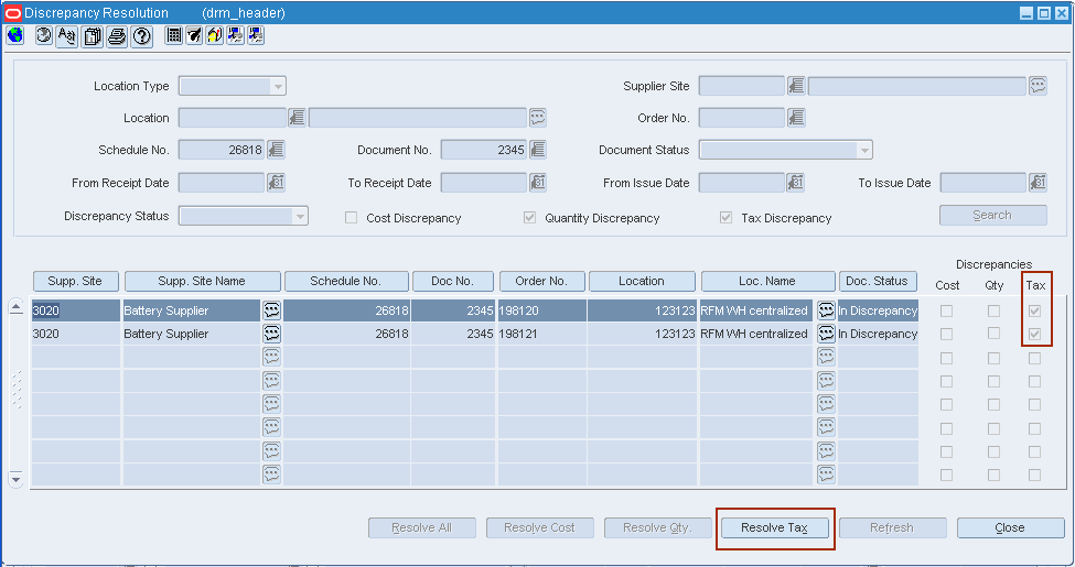

From the Options menu, select Discrepancy Resolution. The Discrepancy Resolution window is displayed.
Click Resolve Tax in the Discrepancy Resolution window. The system and informed tax are displayed in the Discrepancy Resolution window.
The system tax includes:
Base Value – The basis for calculation of the tax
Modified Base Value – Contains the taxable basis changed by external tax engine for tax calculation. This happens when a tax rule modifies the taxable basis, mostly in the form of a lower taxable basis. It reflects the taxable basis the tax rate is actually applied on by external tax engine
Value – The total value
The informed tax includes
Base Value – Informed calculated basis for the tax
Modified Base Value – The changed basis, which flows from the external tax engine. This value is applicable for only certain items that are eligible for a tax rule, which modifies the basis on which the tax rate is calculated.
Value – The informed total value for the tax
In this Discrepancy Resolution window, click Item Details. The Item Tax Details is displayed in the Discrepancy Resolution window.
Table 3-16 Item Tax Details Fields and Description
Tax Code |
The tax code returned by the external tax engine |
System Taxable Base Value |
The total basis on which the tax is calculated |
System Tax Value |
The total tax value returned calculated by the tax engine |
Informed Taxable Base Value on NF |
The total taxable basis apportioned to the line level by the application |
Informed Tax Value on NF |
The total taxable value apportioned to the line level by the application |
Item Tax Details Section |
Item |
The merchandise number |
Order No |
The purchase order number |
Base Value |
System Tax – The basis used while calculating the tax Apportioned Tax on NF – The apportioned tax basis value calculated for the fiscal line using the header tax basis values |
Modified Base Value |
System Tax – Modified Base Value is applicable to items that are eligible to a tax rule that modifies the taxable basis Apportioned Tax on NF – Modified apportioned tax basis value calculated for the fiscal line using the modified header tax basis values. |
Rate |
System Tax – The tax rate at the item level Apportioned Tax on NF – The apportioned tax rate calculated at the fiscal line level |
Value |
System Tax – The system tax value of the individual item Apportioned Tax on NF – The apportioned tax value calculated for the fiscal line using the header tax value |
Value/Unit |
System Tax – The unit tax amount calculated Apportioned Tax on NF – The apportioned unit tax amount |
Resolution By |
The resolution can be either as per the System or as per the Nota Fiscal |
Reason |
The reason for the resolution action (optional) |
In the Resolution By field, click the list, and select from resolve by either System or Nota Fiscal. Click Resolve Disc.
Note: Depending on the system options set, ORFM decides the action to be taken for discrepancy resolution.For example, in case the system option is set to System, the Nota Fiscal option is disabled. The list for resolution is disabled and default method of resolution is set as 'System'. |
The message – "Selected Resolution Action will be applied to all the discrepant records. Are you sure you want to continue?" is displayed. Click Yes. You are returned to the Discrepancy Resolution window. Click Close.
Note: If more than one component of the tax is in discrepant state, then the Discrepancy Resolution window displays the details of all the tax components. Follow the procedure listed in steps three to five to resolve the tax discrepancy. |
In the Discrepancy Resolution window, notice that the check box for Tax is not selected, and the Resolve Tax button is disabled as highlighted in Figure 3-33. The Status of the Nota Fiscal is changed to Validated.
Click Close in the Discrepancy Resolution window. You are returned to the Fiscal Documents window. The status of the NF is changed to Validated.
Click OK in the Fiscal Documents window. The Fiscal Docs Find window appears. The status of the NF is displayed as Validated.

Navigate: From the RMS Start Menu, select Fiscal Management, then select Contents Of Fiscal Management.
In Contents Of Fiscal Management, select Login of Location. The Location Login window appears.
In the Location Login window, select the store or warehouse of the main supplier. Click the Location LOV to obtain the list of stores or warehouses. Select the location and click OK.
Click Add in the Fiscal Docs Find window. The Fiscal Documents window appears. Enter the Utilization code for triangulation.
Enter the other values in the Fiscal Documents window. The NF is created in the Worksheet status.
Click OK. You are returned to the Fiscal Docs Find window. The Fiscal Docs Find window displays the NF that is created in the worksheet status.

In the Fiscal Docs Find window, click Add.

After you enter the Utilization as Comp NF for Merchandise and Non-Merchandise, in the Header Details of the Fiscal Documents window, the Service and Merchandise Cost fields are disabled. Requisition Doc button is disabled.
The Additional Costs fields that include Freight, Insurance, and Other Expenses are enabled. In the Line Item Detail section, the fields in the Detail Info tab and Detail Taxes tab are disabled.
Enter the expenses incurred for freight and insurance in their respective fields. If other expenses are present, enter the details in the Other Expenses field.
The Totals in the Header Details section is also enabled.

After you enter the Utilization as Comp NF for Cost/Tax Correction, in the Header Details of the Fiscal Documents window, the Service and Merchandise Cost fields are disabled. Requisition Doc button is disabled.
