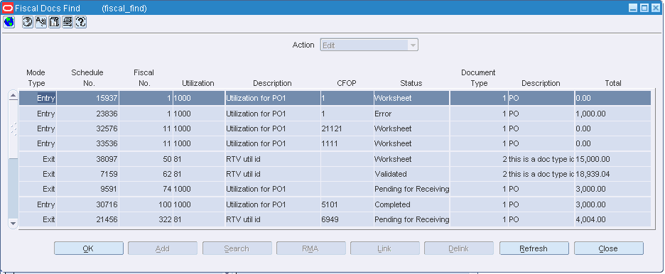

In the Fiscal Docs Find window, the Action field has a list, which contains the following:
Table 7-1 Fields in the Fiscal Docs Find window

To search the Fiscal Documents, do the following:
In the Fiscal Docs Find window, select Edit from the Action field.
After entering the search criteria, click Search. The Fiscal Docs Find window appears. All the NFs that meet search criteria are displayed.
Select the NF and click OK. The Fiscal Documents window appears. Here you can view and edit the NF details.
The following buttons are enabled only when the Fiscal Docs Find window is accessed through Schedule window:
Add – Click Add to add NF details in the Fiscal Document window.
RMA – Click RMA to add NF information to the schedule, when customer has returned the merchandise.
Link – Click Link to link an NF to a schedule.
Delink – Click Delink to remove an NF from a schedule.
Click Refresh to return to the previous window and enter the criteria again.
Click Close to exit the window. You are returned to the Fiscal Docs Find window.
