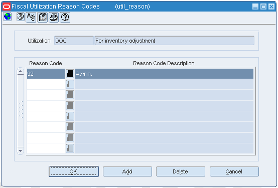

The Reason Code is created by the retailer for inventory adjustment and repairing operations. It is used to identify returns and can be configured in the ORFM system.
Note: A utilization can have any number of Reason Codes attached to it. However, the Reason Code cannot be attached to utilization if the Reason Code is already attached to any other Utilization ID. The Reason Code LOV shows only the Reason Codes that are not attached to any type of utilization ID. |
To associate Reason Code with the Utilization Code, do the following:
Navigate: From the RMS Start Menu, select Fiscal Management, then select Fiscal Configuration.
On the Fiscal Utilization Setup window, click the Options menu.
Note: This option is enabled only if the Requisition Type selected for the Utilization Code is Inventory Adjustment (Stock). |
Select the inventory adjustment for which you want to add the Reason Code. From the Options menu, select Reason Code. The Fiscal Utilization Reason Codes window appears.
Click Add. In the highlighted row that appears, select the reason code from the list.
Click OK. The reason code is associated with the inventory adjustment.
To delete the reason code, do the following in the Fiscal Utilization Codes Reason Codes window:
Select the reason code that you want to delete. Click Delete in the Fiscal Utilization Codes Reason Codes window. A message appears. Click Yes to delete the reason code.
Click OK to exit the window.

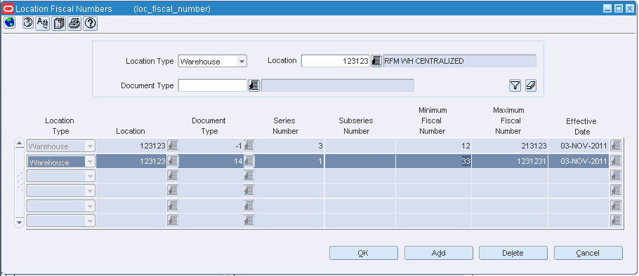

Location Fiscal Numbers are numbers assigned to a store/warehouse. In Brazil, the sequence of NF document numbers are controlled and should be correctly followed during the NF issuing process.
Each location controls its own sequence based on the following fields:
Documentation Type
Serial/Sub-serial
Sequence
Effective Date
Any transaction that involves that particular store/warehouse should contain the fiscal numbers falling within a particular range.
To add fiscal numbers, do the following:
Navigate: From the RMS Start Menu, select Fiscal Management, then System Setup. From System Setup, select Fiscal Numbers.
In the Contents Of Fiscal Numbers window, click Edit. The Location Fiscal Numbers window appears.
To add a number, select the store/warehouse from the Location LOV. Click Add. In the multi-record block, a row is highlighted as shown.
Assign values to Location, Document Type, Series Number, Subseries Number, Minimum Fiscal Number, Maximum Fiscal Number, and Effective Date.
Select the row that you want to delete in the Location Fiscal Numbers window.
Click Delete. The following message appears:
Click Yes to delete the row.
In the Contents Of Fiscal Numbers window, click View. The Location Fiscal Numbers window appears.
In the View mode, the Add, and the Delete button are disabled. By default, the Location Fiscal Numbers displays the locations, and their fiscal numbers.
Select the location type from the Location Type list. The Location field is highlighted after selecting the location type.
Select the location from the Location LOV.
Click the filter icon. Based on the filter criteria, the multi-record block displays the Location Type, the Location, and the values associated with the Document Type, Series Number, Subseries Number, Minimum Fiscal Number, Maximum Fiscal Number, and Effective Date.
