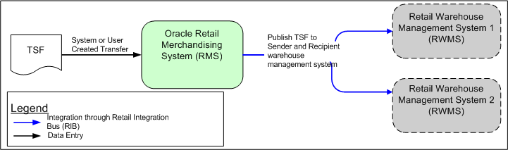

Transfer Creation
If a warehouse-to-warehouse transfer (or allocation) is initiated in RMS, the transfer request flows to RWMS (Sending Location and the Receiving Location) through RIB.
Figure 4-4 Warehouse to Warehouse Transfer Creation
The sender warehouse and the recipient warehouse may run on the same instance or different instances of RWMS. If both warehouses run on the same instance of RWMS, RWMS-1 and RWMS-2 in the above image would be the same.
If a warehouse-to-warehouse transfer is initiated in RWMS, it flows to RMS and the other RWMS through RIB. If the RMS-initiated transfer is modified in RWMS-1, the modifications flow back to RMS and the other RWMS.

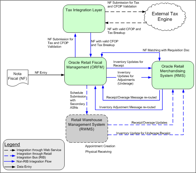

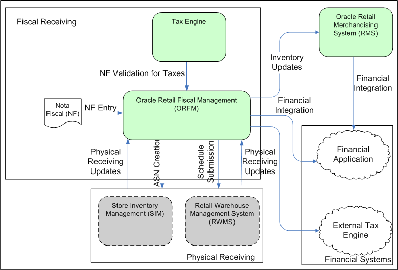

Nota Fiscal – Receiving and Issuing
The Nota Fiscal receiving (inbound) and issuing (outbound) are controlled within ORFM and all integration with RMS, RWMS, and SIM is based on the physical movement of the products.
Nota Fiscal Receiving
When ORFM is enabled, SIM and RWMS are not allowed to physically receive any inventory prior to fiscal receiving (that is, inbound Nota Fiscal processing) is completed in ORFM. After physical receiving in SIM or RWMS, the inventory in RMS is not updated until the fiscal receipt and physical receipt comparison is completed in ORFM and any discrepancy is resolved.
Figure 4-14 outlines the ORFM business process for inbound operations.
Figure 4-14 Inbound Process Flow
process_flow
The inbound process flow is as follows:
  1. Enter the Nota Fiscal (NF) in the Oracle Retail Fiscal Management (ORFM) system.
  2. When the shipment arrives at the warehouse or the store, create a schedule and enter the NFs received.

  5. After validation, send the schedule to the Warehouse Management System (RWMS), and Store Inventory Management (SIM). After physical receiving, RWMS and SIM publish the receipt updates to ORFM to complete the NF receiving process.
  6. After NF processing is complete, ORFM calls RMS to update inventory and WAC.
  7. Send the transaction data in RMS and ORFM to a financial application. For fiscal reporting purposes, send the NF data in ORFM to the fiscal reporting system like TaxWeb.
Because the Nota Fiscal contains taxation information, ORFM calls the tax engine for calculations during the receiving and issuing of a Nota Fiscal.

ORFM and RWMS
RWMS is integrated with the ORFM through RIB for the below business transactions:
PO Receiving
  • ORFM publishes the Appointment Quantity based on the NF details to RWMS
  • WMS schedules the Appointment based on the above information
  • WMS can over-receive/under-receive during physical receipt. The over-receipt is through new overage screen in RWMS
  • The receipt information with the damaged and overage details are published by RWMS to ORFM and ORFM to RMS
Transfer Receiving
  • WMS and ORFM subscribes to the ASN information from the sourcing location
  • After the ASN is processed in ORFM, a secondary ASN is published to the warehouse receiving the transfer
  • The warehouse will receive against the secondary ASN and the receipt information is interfaced to ORFM through RIB
Brazil requirements are strict for receiving exactly what is on the NF. ORFM provides delivery information to RWMS, from which the user creates receiving appointments. The ability to alter appointment quantities is not available based on system parameter configuration. Validation exists to compare the appointment quantities with the quantities supplied by ORFM. Users can split items as needed by altering case pack sizes, but the totals must match with ORFM. The System Configuration Parameter -- appt_update_allowed should be set to N to disallow the appointment quantities being updated during receiving.
Requirements for each appointment are grouped into the same unique schedule number provided by ORFM. That schedule number is added to the appointment table and is searchable by users.
