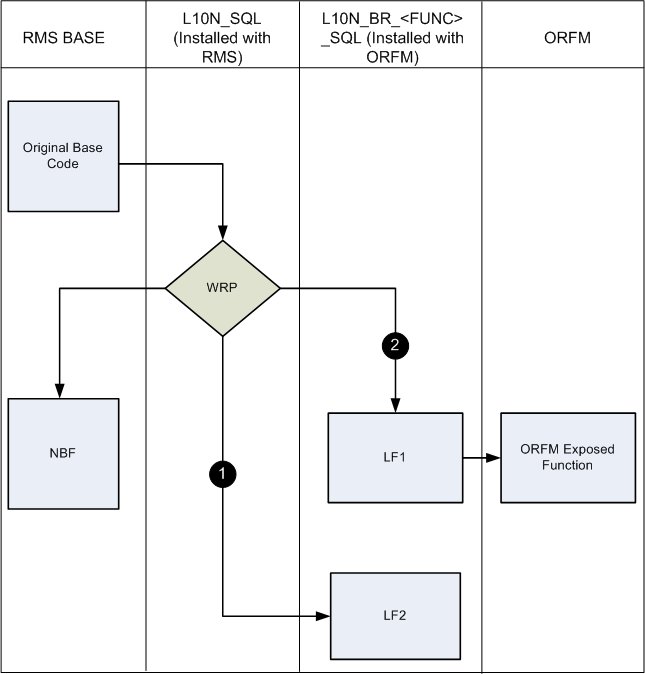

Decoupling RMS and ORFM Batch
Identical processes that are performed differently in RMS and ORFM have been separated using a process called decoupling. This allows installation of RMS without installing any (or a minimal portion) of the ORFM system. This means that direct reads and writes to the ORFM tables and views from RMS are avoided.All processes involving localization are encapsulated within a localization wrapper package. The decoupling between RMS and ORFM is controlled in that wrapper package.

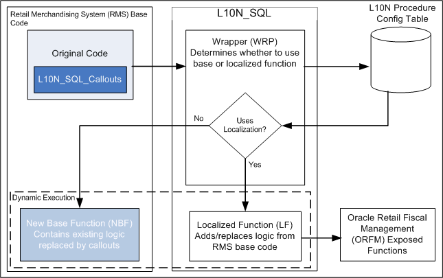

Dynamic Function Calls
ORFM and RMS utilize dynamic function calls to decouple. This method uses a configuration table to determine which function or procedure, either base or localized code, is dynamically executed.
Figure 3-1 Dynamically Executed Decoupling
There are five components in the dynamic call approach:
  1. The original code – This is the base code that does the callout to the localization layer.
  2. L10N_SQL wrapper (WRP) – This function decides whether to use the base code or the localized version of the code.
  3. L10N configuration table – This table contains the procedure name to be executed per localized instance.
  4. New base function (NBF) – This function contains the existing logic from the original code replaced by callouts to the localization layer.
  5. Localized function (LF) – This contains the necessary procedures to carry out the localization tasks. This may contain actual calls to ORFM functions.
