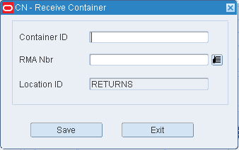

Receive Container
You can return a new container by scanning a generic container ID with a mandatory RMA nbr. The container is assumed to be received at the location for the Return WIP. Once received, the container and its associated RMA nbr and other details are populated in the header block.
  1. On the Electronic Return Processing window, click Receive Container. The Receive Container window opens.
    Figure 12-2 Receive Container window
    Surrounding text describes Figure 12-2 .
  2. Enter the container ID in the Container ID field.
  3. Enter the RMA number in the RMA Nbr field or select from the LOV.
  4. Click Save.

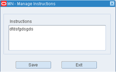

Manage Instructions
If any instructions have been downloaded against the pending return (RMA), the Instructions link is enabled.
  1. On the Electronic Return Processing window, click Instructions. Any instructions available are displayed

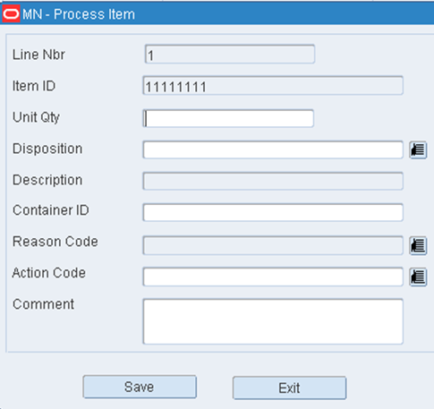

Process Item
This link is enabled only when none of the Select checkboxes are checked.
  1. On the Electronic Return Processing window, click the Process Item link. The Process Item window opens.
    Figure 12-4 Process Item window
    Surrounding text describes Figure 12-4 .
  2. Enter the enabled fields:
    • Line Nbr/Item ID: Pre-populated details of the selected line number and item ID.
    • Unit Qty: The user can enter a valid value to set the number of units of the item being processed.
    • Disposition: The user can select the disposition of the inventory once processed - either sellable or non-sellable. This determines the status of the container into which the merchandise is processed - I or N, respectively. Two items cannot be added to the same container, if they are non-saleable but have a different disposition.
    • Description: Description of the selected disposition code.
    • Container ID: The user can scan the return received container (only if the selected disposition is non-sellable). Or the user can choose to scan a generic container to receive the merchandise as either non-sellable or sellable. In case the user scans an existing I status container, it is not required to be the same RMA nbr. however, it is required that in the case of multiple items on the same container, each of the items should have a forward unit pick.
    • Reason Code: Pre-populated field with the reasons for the return downloaded from OMS. In the case of more than one reason, the word Multiple is displayed but the user can click on the icon next to the field to view all the individual reasons.
    • Action Code: The user must select only one action code from the LOV. Action Code is mandatory and signifies the action taken (or to be taken) against the line item being processed. If the business chooses to have no action code, a dummy value such as NONE may be created for an action code, to be used whenever desired.
    • Comment: The user can choose to enter free-form text as comments in this field.
  3. Click Save. The records are processed and published to OMS using the RETURNS_UPLOAD table.

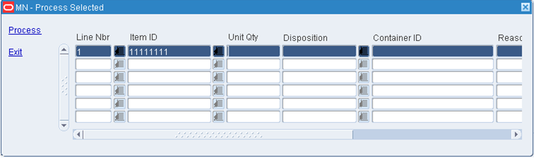

Process Selected
  1. Select a minimum of one checkbox from the RMA block and click Process Selected link to process all the selected items in a single instance.
  2. The Process Selected window opens with all the selected details pre-populated.
    Figure 12-5 Process Selected window
    Surrounding text describes Figure 12-5 .
  3. Enter the unit quantity in the Unit Quantity field.
  4. Select a disposition using the LOV in the Disposition field.
  5. Scan the container ID in the Container ID field.
  6. Select the Reason Code, Action Code and insert a Comment.
  7. Click Process.

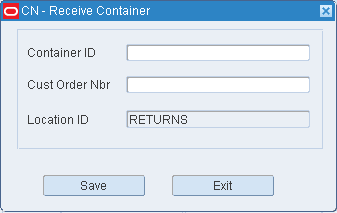

Receive Container
  1. On the Paper Return Processing window, click Receive Container. The Receive Container window opens.
    Figure 12-7 Receive Container window
    Surrounding text describes Figure 12-7 .
  3. Enter the customer order number in the Cust Order Nbr field.
  4. Click Save.

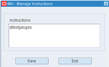

Manage Instructions
If any instructions have been downloaded against the pending return, the Instructions link is enabled.
  1. On the Paper Return Processing window, click Instructions. Any instructions available are displayed

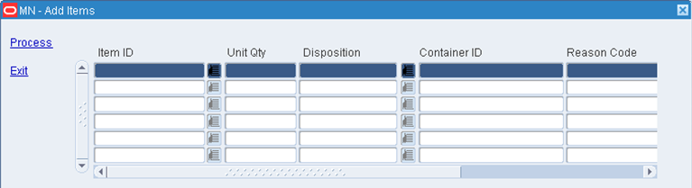

Add Items
  1. On the Paper Return Processing window, click Add Items. The Add Items window is displayed.
    Figure 12-10 Add Items window
    Surrounding text describes Figure 12-10 .
  2. Enter the following information:
    • Item ID: Scan any item ID present in the system. If the item has not been marked as Returnable in the item master, a warning message is displayed to the user while adding the item on the window. The message can be overridden.
    • Unit Qty: Enter the unit quantity of the item to be processed against a certain disposition/reason/action code.
    • Disposition: Select a code which determines whether the item will be processed as Inventory or Non-saleable. Two items cannot be added to the same container, if they are non-saleable, but have different disposition.
    • Container ID: The user must scan a container ID. It can either be the N status return received container for the same customer order number or a generic container. In case the user scans an existing I status container, it is not required to be of the same customer order number. However, it is required that in the case of multiple items on the same container, each of the items should have a forward unit picking location associated with it.
    • Reason Code: The user can click on the LOV next to the field, and select one or more reason codes, which describe the reasons for the return of the line item.
    • Action Code: The user must select only one action code from the LOV. The Action Code is mandatory and signifies the action taken (or to be taken) against the line item being processed. If the business chooses to have no action code, a dummy value such as NONE may be created for an action code, to be used whenever desired.
  3. Click Process. The records are processed and published to OMS.
  4. Click Exit to roll back the changes.

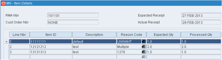

Item Detail
  1. On the Return Information Inquiry screen, click Item Details. The detailed information about all the items expected to be returned are displayed on the Item Detail window.
    Figure 12-12 Item Detail window
    Surrounding text describes Figure 12-12 .
  2. Following information is displayed:
    • Header block
      • RMA_nbr (populated for electronic returns, otherwise NONE)
      • Customer Order Number (populated for paper returns, otherwise NONE)
      • Expected and actual receipt
    • Detail block
      • Line Number: The sequence number of the item on the return.
      • Item ID: Item ID of the item on the return.
      • Description: Description of the item on the return.
      • Reason Code: Reason for the return of the item. If multiple reasons have been selected, the word Multiple is displayed. The user can click on the LOV next to the reason code field to view all the reason codes associated with the item return.
      • Expected Unit Qty: The number of units of the item expected against the return.
      • Processed Unit Qty: The number of units of the item which have been processed in the system (either as non-saleable, or saleable) and are part of the DC's inventory (available or non-available).

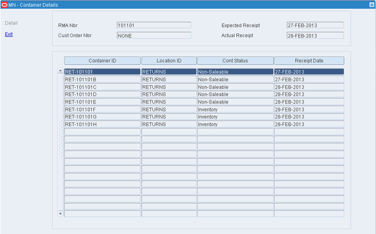

Container Detail
  1. On the Return Information Inquiry screen, click Container Details. The Container Details screen opens with detailed information about all the containers (processed or non-processed) against the selected return.
    Figure 12-13 Container Details window
    Surrounding text describes Figure 12-13 .
  2. The Container Details screen has the following information:
    • Header block
    • Detail block
      • Container ID: All of the container IDs associated with the selected return are displayed.
      • Location ID: Current location of the container.
      • Container Status: The current container status. It can either be Inventory or Non-saleable.
      • Receipt Date: The date the container was received at the return receiving screen or in the case of an Inventory container, when the items were processed into a generic I status container.

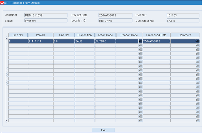

  3. You can view details of each container by using the Detail link on the window. This link is enabled only for containers which have at least one item associated to them through return processing. For containers which have no item associated with them, the link is disabled.
    Select a container with item details associated with it, and click the Detail link. The Processed Item Details window opens with a header and detail block.
    Figure 12-14 Processed Item Details window
    Surrounding text describes Figure 12-14 .
    The header block has the following information:
    • Container: The selected container ID.
    • Status: Status of the container.
    • Receipt Date: Receipt date of the container.
    • RMA_nbr/cust_order_nbr: RMA_nbr/cust_order_nbr against which the container was received/processed.
    The detail block has the following information:
    • Line Nbr: The sequence number of the item on the selected return.
    • Item ID: This displays the items present in the selected container.
    • Unit Qty: Unit quantity of the item present in the container.
    • Disposition: Disposition of the inventory selected at the time of processing. If the container is in N status after processing, there can only be one disposition across items.
    • Action Code: Action code added to the line item record while processing the return. There can be multiple records for the same item on the container with different action codes.
    • Processed Date: The date when the item was associated to the container through the Return processing operation.
    • Comments: Displayed, if the user adds any comments while processing the item into the container.
  4. Click the Exit button to return to the previous screen.

Manage Instructions
If the selected record has the Instructions field checked, the Instructions link is enabled
  1. On the Return Information Inquiry window, click Instructions. Any instructions available are displayed
    Figure 12-15 Manage Instructions window
    Surrounding text describes Figure 12-15 .

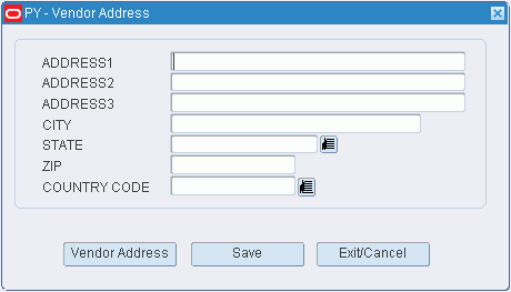

  2. To enter an address for the vendor:
    1. Click Vendor Address. The Vendor Address window opens.
      Figure 12-17 Vendor Address window
      Surrounding text describes Figure 12-17 .
    2. Enter the ship-to address of the vendor or click Vendor Address and select the address.
    3. Click Save to save any changes and close the Vendor Address window.
