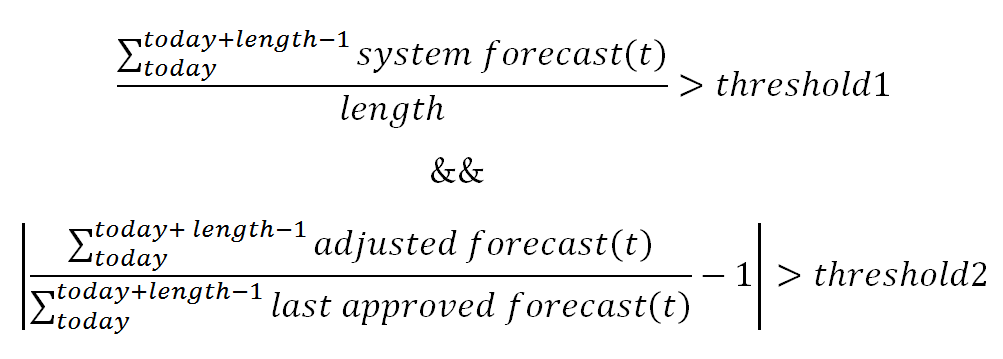

Forecast versus Recent Sales
Usually it is not expected that demand values differ very much from period to period. This also implies that the forecast magnitude generally is in line with the magnitude of the most recent sales. There are exceptions to this case. For instance, when an item enters a season, the forecast is probably higher than the sales in periods leading to the season. Or when an item is towards the end of the season, the forecast will be lower than sales in peak periods. For these exceptions, you can be alerted to review the forecast, rather than automatically approving it.
This alert a batch alert, and can be used for forecast approval.
Alert Expression
Where length, threshold1, and threshold2 are adjustable parameters.
Surrounding text describes calc_fvrs160.png.
The calculation expression for this alert involves thresholds which can be adjusted in the Alert Thresholds task.Threshold1 allows filtering out time series by rate of sales. For instance, if it is set to 1, the alert expression is only run for time series that sell at least one item per week. The reason is that we don't want the user to be overwhelmed by reviewing item/store/week information for low sellers. Threshold2 defines how different the forecast and the recent sales may be before they get alerted. For instance, if threshold2=0.1, a difference of 10% is considered acceptable, but everything above will trigger the alert, and the time series is not approved.
The alert is mostly relevant for the baseline level. The reason is that there can be large differences in recent sales versus forecast due additional demand coming from past or upcoming promotions.
The calculations are not performed for the entire forecast horizon, but rather by the number of periods determined by the length parameter. The reason is that the forecast horizon can sometimes be very long (52 weeks) and average demand over such a long time period can not be used as in-season versus out of season rate of sales.

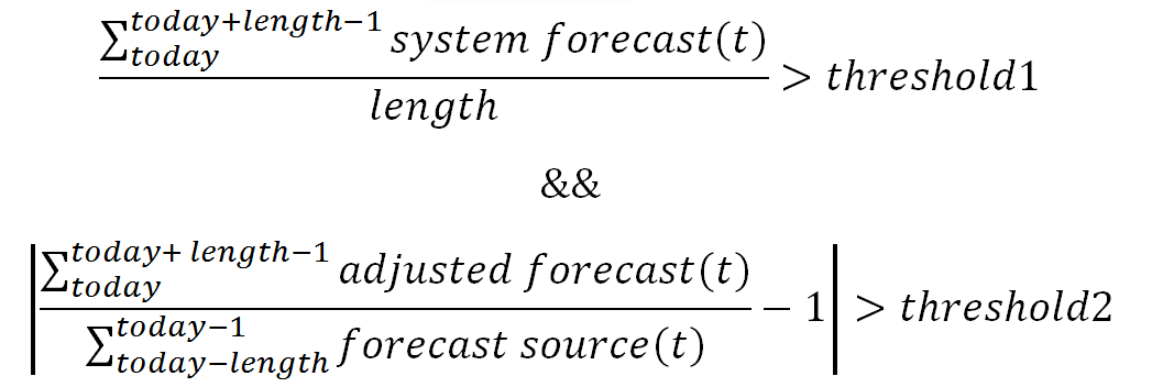

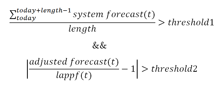

Current Forecast versus Last Approved Forecast
Typically RDF Cloud Service generates forecasts weekly. Every week, new sales data is loaded and the forecast is regenerated. While the latest data points are expected to make the forecast more accurate, it is not expected that the difference in forecasts generated in two consecutive weeks to vary too much. If the forecasts differ, you are alerted to review the forecasts.
This alert is both a batch and a workbook alert.
Alert Expression
For the batch alert
Surrounding text describes calc_cfvlafba160.png.
For the real time alert:
Surrounding text describes calc_cfvlafrta160.png.
The batch alert does not have a time component, while the real time alert is time-phased.
The calculation expression for this alert involves thresholds which can be adjusted in the Alert Thresholds task.Threshold1 allows filtering out time series by rate of sales. For instance, if it is set to 1, the alert expression is only run for time series that sell at least one item per week. The reason is that we do not want the user to be overwhelmed by reviewing item/store/week information for low sellers. Threshold2 defines how different the two forecasts may be before they get alerted. For instance, if threshold1=0.1, a difference of 10% is considered acceptable, but everything above will trigger the alert, and the time series is not approved.The values of Threshold1, and Threshold2 are the same for both batch and real time alerts.
This alert is relevant for both baseline and causal forecasts.
Summation of forecasts are not performed over the entire forecast length. If the forecast horizon is very long, the user may only be interested in periods closer to the forecast generation date, and not want to check periods far out. This can be controlled by the length parameter

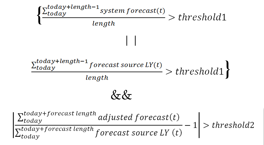

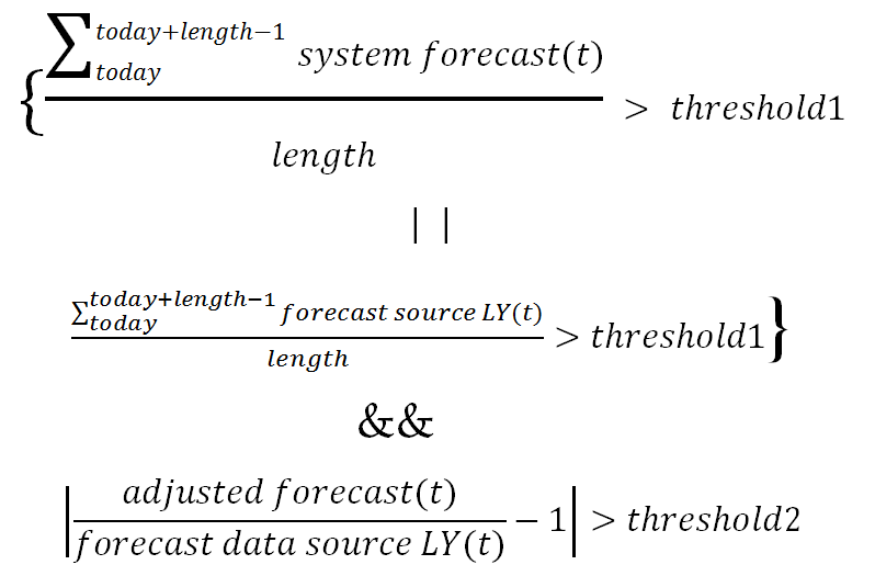

Forecast versus Last Year Sales
The most reliable forecasts are generated from data that has a repeatable pattern year over year. However, this is not always the case. A change in business strategy, merchandise reclassifications, new items can all lead to changing selling patterns over time.
To detect possible changes in selling patterns, the following alert will compare the last year's sales volume with the forecasted sales volume. If they are different by an adjustable percent, the alert is triggered.
Alert Expression
Where length,threshold1, and threshold2 are adjustable parameters.
For the batch alert:
Surrounding text describes cs_calc_fcvslyba160a.png.
Surrounding text describes cs_calc_fcvslyrta160.png.
The calculation expression for this alert involves thresholds which can be adjusted in the Alert Thresholds task.First, we compare the average forecast and average sales last year to Threshold1. If Threshold1= 1, we make sure to run the alert only for item/stores that sell on average at least one per week. If the average is not too low, we proceed comparing the current adjusted forecast to the sales last year. If they are very different (defined by Threshold2), the user is alerted to review the forecast.
The alert is mostly relevant for the baseline level. The reason is that there can be large differences in last year sales versus forecast due additional demand coming from past or upcoming promotions.
Summation of forecasts are not performed over the entire forecast length. If the forecast horizon is very long, the user may only be interested in periods closer to the forecast generation date, and not want to check periods far out. This can be controlled by the length parameter.

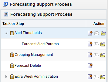

Alert Thresholds Workbook
To build the Alert Thresholds workbook, perform these steps:
  1. Click the New Workbook icon in the Alert Thresholds task in the Forecasting Support Process activity.
    Figure 14-1 Alert Thresholds Task
    Surrounding text describes Figure 14-1 .
