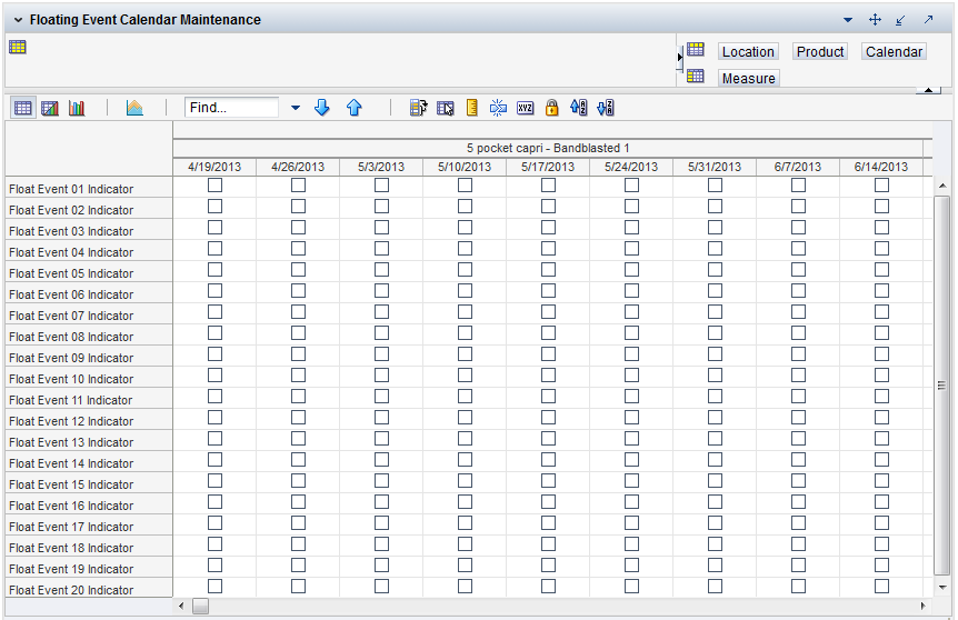

About Floating Events
When managing periods when events are active, RDF has the Floating Events Admin Workbook. Its one worksheet lists the events and you have the ability to flag periods when certain product/location combinations are active during an event.
A possible task scheduled to run before forecast generation is managing events and holidays, which may heavily impact a retailer's business. Some annual events such as Easter occur at a slightly offset week of the year from year to year. RDF needs to have some control over how these floating events and holidays will be managed along the time dimension so that their impact is not forecasted in the wrong time period. A lift associated with the event needs to be calculated, so it can be applied to the correct periods in the forecast horizon.
Management of this issue causes customers the pain, time and cost of configuring their data as this happens every year. This is a basic retail system requirement that the system should be able to address.
In a RDF causal implementation, an annual event that does not occur in the same period every year, but has a spike in demand associated with it, is handled by associating a causal factor to it. The system then determines the associated lift, and applies it to the relevant point in time in the forecast horizon.
In a RDF implementation, where there is no causal, these events still exist. For instance, an increase for sales leading to Easter will happen even if there is no promotion specifically associated with Easter (chocolate bunnies sell more during Easter even though they are not specifically promoted). And because it does not happen in the same time period every year, the Easter spike will appear randomly any time in March or April. The spike is baked in the seasonality of each item/store, making its prediction, timing, and magnitude; inaccurate at best.
RDF is able to handle such situations, not only through its causal capabilities, but also for baseline forecasting.
To do that, a set of events has to be defined. This usually happens at configuration time. Then, a user has to flag the periods where an event was active in the past (history) and in the future (forecast horizon). Once the dates are set up, the effect of the event is estimated based on past instances, and applied in the forecast horizon if the flag is active.

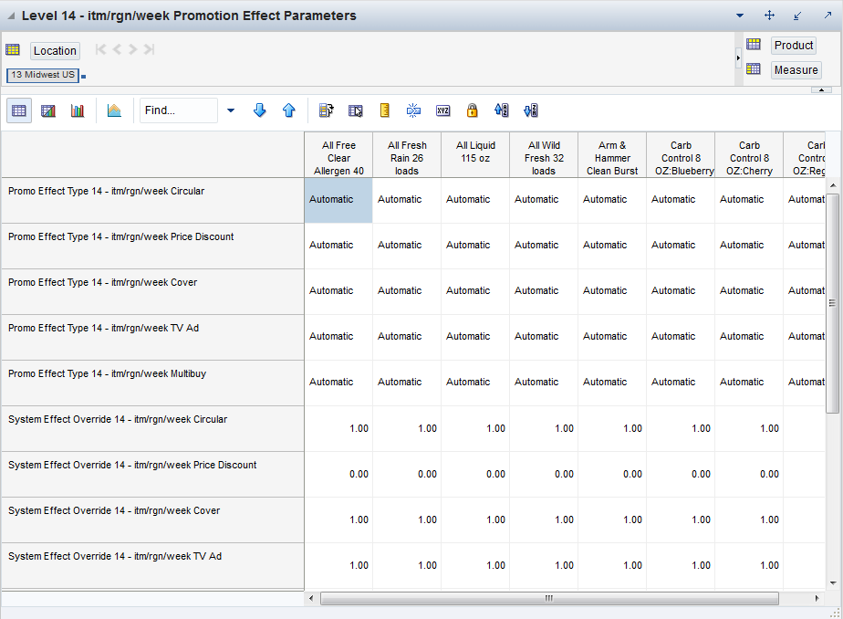

  1. Build a Promo Effect Maintenance Workbook.
    1. In the Final Promotion Effect Parameters View PromoEffects view, review the System Calculated Effect.
    2. If the System Calculated Effect is to be modeled using a method other than Automatic, edit thePromo Effect Type.
    3. If you choose to adjust the system-calculated effect, adjustments can be made to the System Effect Override. You must also set the Promo Effect Type to Override All or Override Future Only.

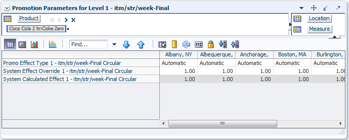

  1. Build a Promo Effectiveness/ Results Workbook.
  2. In the Promotion Parameters View, review the System Calculated Effect and edit the System Effect Override then select Calculate to recalculate the Future Forecast.
Changes to the Promo Effectiveness/ Results Workbook cannot be committed; however, this task is useful for:

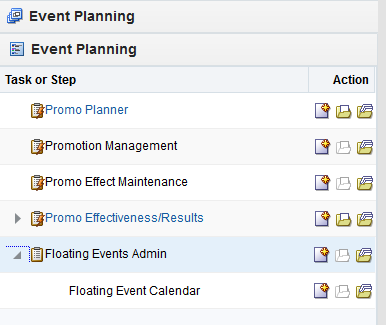

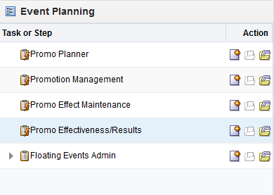

Table 13-1 lists the Promote tasks, workbooks, and views in the Event Planning activity.
Table 13-1 Promote Tasks, Workbooks, and Views
Task Workbook and Steps Views
Promo Planner Task
Allows you to specify when certain promotional events were active in the past, and when they are active in the future.
Promo Planner Workbook
Promotions View
Promotion Management Task
Allows you to enable and disable promotions for causal forecast levels and to specify whether promotions can have a negative effect.
Promotion Management Workbook

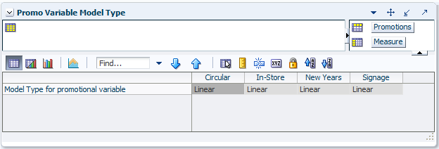

Promo Variable Model Type View
Promotion Enable View

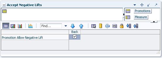

Accept Negative Lift View
Promo Effect Maintenance Task
Allows you to review the system-calculated promotional lift effects, edit these effects, and determine how changes are factored into the promotional model.

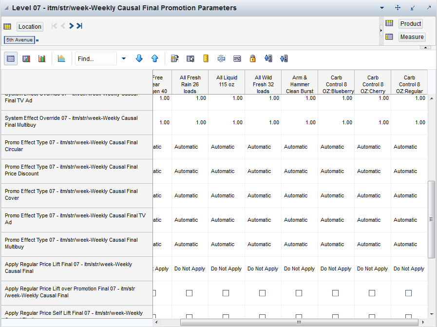

Promotion Effect Parameters Views

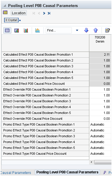

Promotion Effectiveness Task
In addition to all tasks that can be performed in the other Promo workbooks, the user can perform what-if, evaluate the promotional forecast and commit the parameters.
Promotion Effectiveness Workbook
Promotional Parameters Step
Default Causal Parameters View
Final Level Causal Parameters View
Pooling Levels Causal Parameters View
Promotional Forecast Step

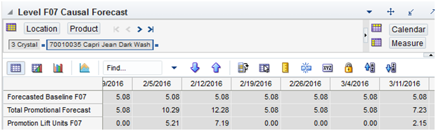

Causal Forecast View
Promotion Model Type View
Promotion Calendar View
Promo Effectiveness/ Results Task
The Promo Effectiveness/ Results task is a historical and future view to the effects of a planned promotion.
This task has these views:
In this task, you view the promotional forecast. There is also the ability to analyze the effects on the forecast if a promotion does or does not occur. This analysis is performed by turning a promotional event or attribute on or off for dates in the future plans, and/or by modifying the Simulated Effect. This task is intended for simulation and analysis purposes only. There is no Commit functionality.
Changes to the Promo Effectiveness/ Results task cannot be committed back to the master database; however, this task is useful for reporting on the performance of past promotions and simulating the effects of future promotions to support more accurate promotional modeling.

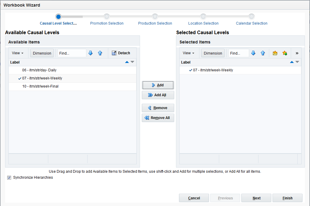

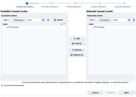

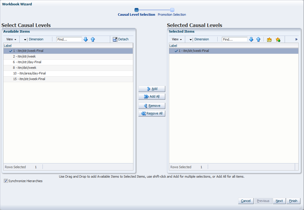

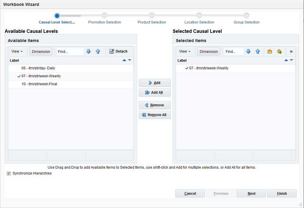

  2. The Workbook wizard opens. Select the causal level and click Next.
    This wizard only displays the causal final levels for selection.
    Figure 13-2 Workbook Wizard: Causal Level
    Surrounding text describes Figure 13-2 .

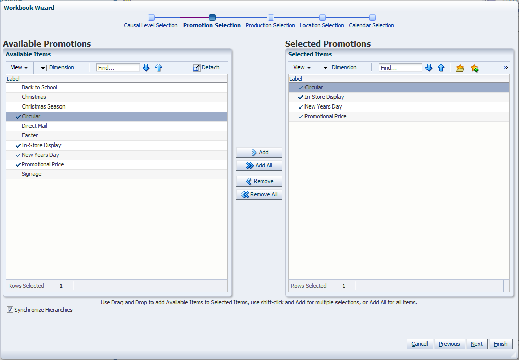

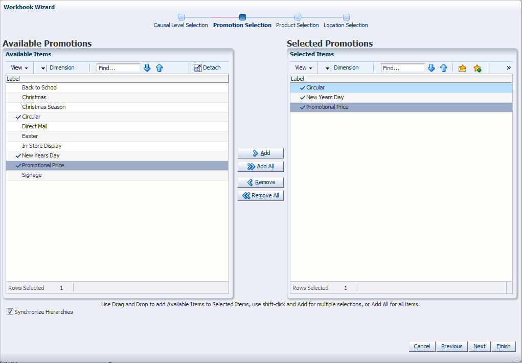

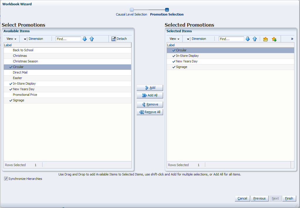

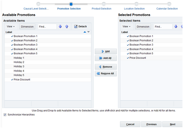

  3. Select the promotions to include and click Next.
    If RDF detects cross-promotional effects for your selected causal level, then RDF uses those promotions and the wizard skips to "Workbook Wizard: Select Products".
    Figure 13-3 Workbook Wizard: Select Promotions
    Surrounding text describes Figure 13-3 .

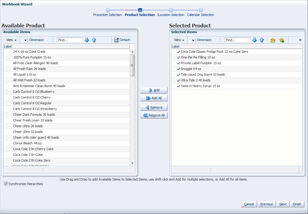

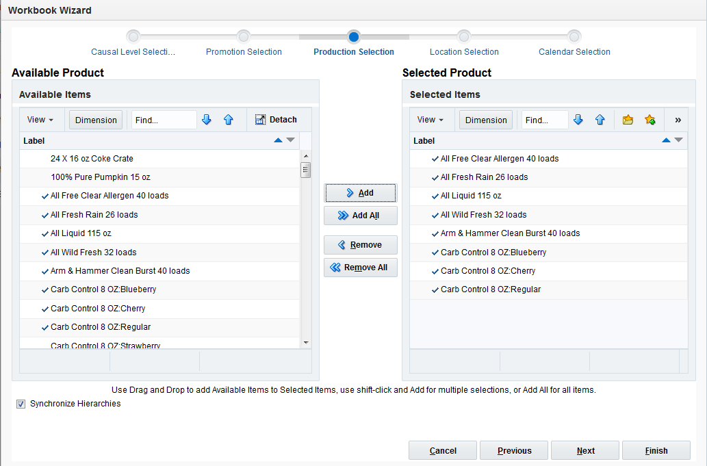

  4. Select the products to include and click Next.
    Figure 13-4 Workbook Wizard: Select Products
    Surrounding text describes Figure 13-4 .

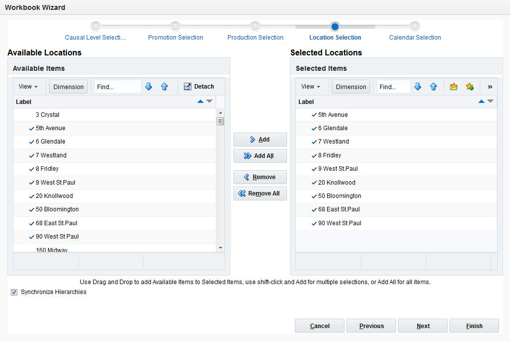

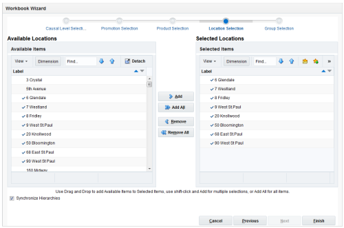

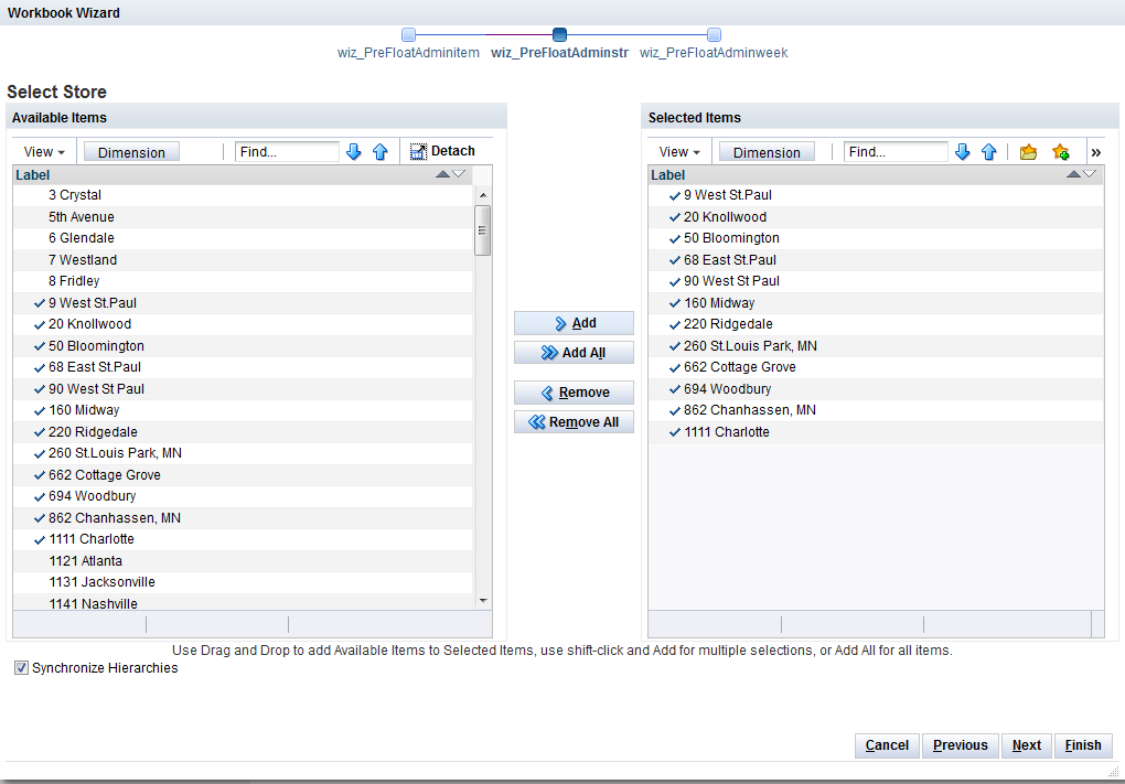

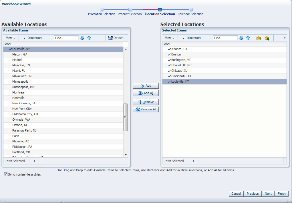

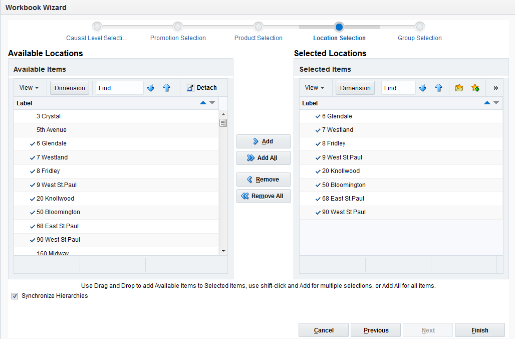

  5. Select the locations and click Next.
    Figure 13-5 Workbook Wizard: Locations
    Surrounding text describes Figure 13-5 .

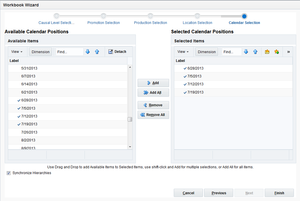

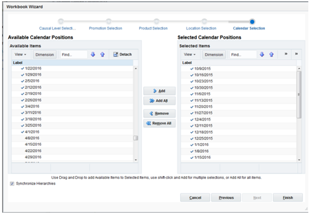

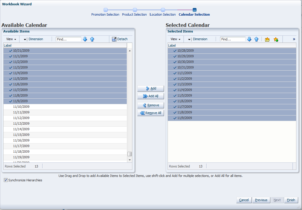

  6. Select the days you want to work with and click Finish.
    Figure 13-6 Workbook Wizard: Select Calendar Positions
    Surrounding text describes Figure 13-6 .
The Promotion Model Type view allows you to review the model type.
Figure 13-7 Promotion Model Type View
Surrounding text describes Figure 13-7 .
Measures: Promotion Model Type View
The Promotion Model Type view contain the following measure:
Model Type for Promotional Variable
This measure stores the model type for the selected promotion variables. The choices are exponential and linear. An exponential model type is displayed if the promotion type is exponential. A linear model type is displayed when the promotion types are Real or Boolean.
For additional information, see "Promotion Variables".

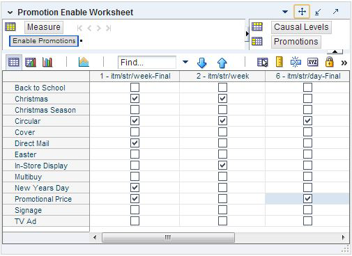

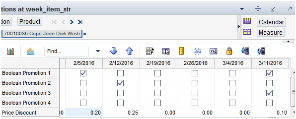

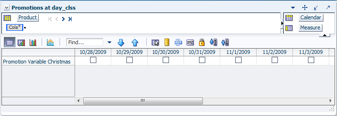

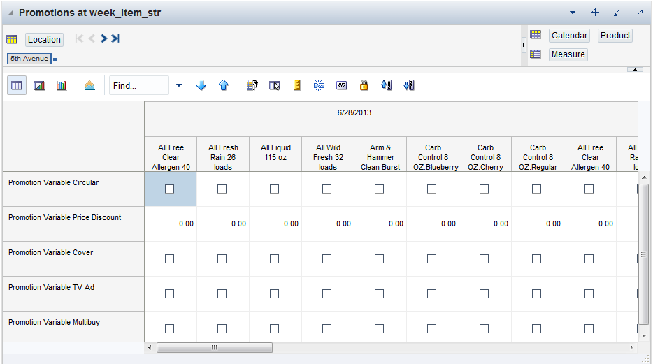

Promotion View
The Promotion view allows you to review and enable or disable promotions for item/locations for desired periods. Once the changes in the promo calendar have been made, click Calculate to update the forecast values in the Promotion Forecast view.
The promotions must be enabled for the chosen causal level.Note that multiple Promotions views are possible. Namely, there is one view for every distinct promotion intersection. Promotions with identical intersections are displayed in the same view.
Figure 13-8 Promotion View
Surrounding text describes Figure 13-8 .
Measures: Promotion View
The Promotions view contain the following measure:
Promotion Variables
Promotion Variables are defined as either Boolean, Exponential, or Real types during the configuration process in the Promote Plug-In. Refer to the Oracle Retail Demand Forecasting Configuration Guide for additional details on configuring the Promote solution.

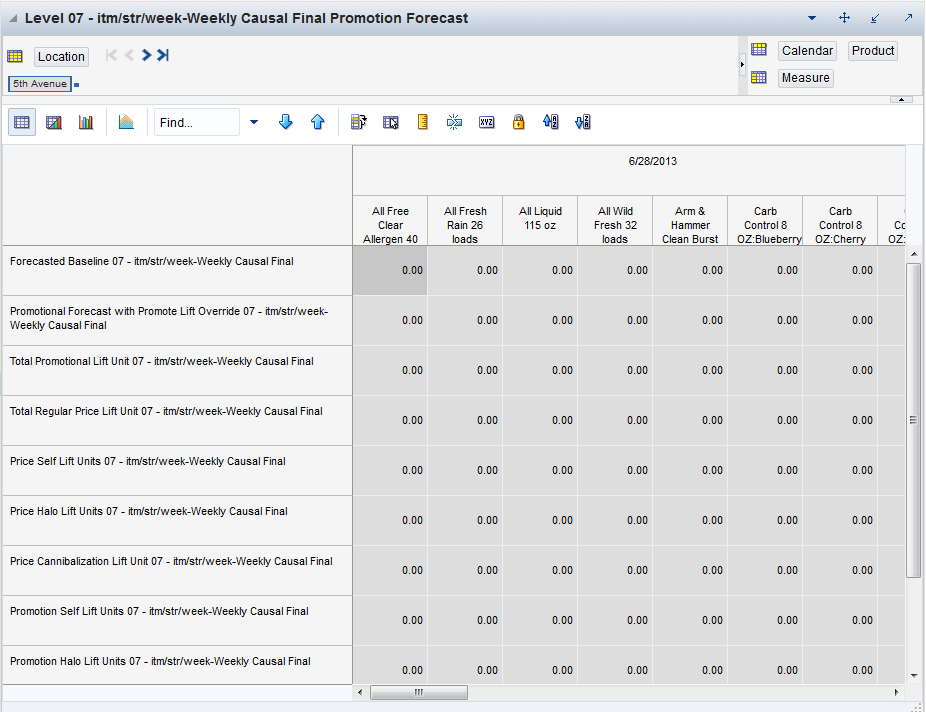

Promotion Forecast View
The Promotion Forecast view allows you visibility to all components of the forecast, like Self, Halo, and Cannibalization effects for both regular price changes, as well as promotions. This is the place the user reviews the impact of the promo-related parameters set in the Promotions and Promotion Parameters views. The process of changing parameters, re-generating the promo forecast, and reviewing the impact in this view, implements the promotional what-if functionality.
Figure 13-9 Promotion Forecast View
Surrounding text describes Figure 13-9 .

Promo Planner Task
In order to correlate deviations from the seasonal forecast with the occurrence of historic promotion events, the system needs visibility as to when these events were active. The system must also be informed of dates on which the status of upcoming promotion events will again be on, so the anticipated promotion effects can be built into the forecasting model.
The Promo Planner task allows you to indicate to the system when certain events were active in the past and when they is active in the future. All promotional events should be represented as accurately as possible so the modeling routine can more precisely detect correlations between event occurrences and changes in sales values.
The Promo Planner task consists of as many views as are necessary to represent all unique dimensional intersections associated with the promotion events contained in the task. A separate view is constructed for each of the required intersections. For example, promotion events such as Advertisement and Gift with Purchase may be loaded at the item/store/week intersection, while an event such as Christmas is loaded at the [Day] level.
In this setup, the Advertisement and Gift with Purchase promotions would appear on one view, and Christmas would appear on another. Whenever a hierarchy is not included in the base intersection (as in the case of the Christmas promotional event) the event is assumed to apply to all positions in the undefined hierarchy. Thus, Christmas is assumed to apply to all products and all locations, but only to the Day-level calendar positions specified in the Promotions View.
This task has this view:
To build the Promo Planner workbook, perform these steps:
  1. Click the New Workbook icon in the Promo Planner task in the Event Planning activity.

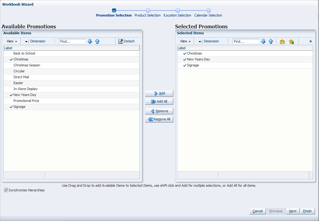

  2. The Workbook wizard opens. Select the promotion events to include and click Next.
    Figure 13-12 Workbook Wizard: Select Promotions
    Surrounding text describes Figure 13-12 .

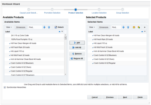

  3. Select the products to include and click Next.
    Figure 13-13 Workbook Wizard: Select Products
    Surrounding text describes Figure 13-13 .
  4. Select the locations to include and click Next.
    Figure 13-14 Workbook Wizard: Select Location
    Surrounding text describes Figure 13-14 .
  5. Select the days you want to work with and click Finish
    Figure 13-15 Workbook Wizard: Select Days
    Surrounding text describes Figure 13-15 .
The Promo Planner workbook is built.
Promotions View
The Promotions view allows you to view and edit the on/off information associated with each configured promotional event. This view provides an interface in which you can specify the time periods (and possibly products or locations) for which certain promotional variables are active.
Figure 13-16 Promotions View
Surrounding text describes Figure 13-16 .
Measures: Promotions View
The Promotions view contains the following measures:
Promotion Variables
Promotion Variable Type is defined through setting both Data Type and Model Type during the configuration process in the Promote Plug-in. The Promotion Variable Type includes Boolean, Exponential, and Real. The following table explains how Promotion Variable Type is defined through Data Type and Model Type settings.
When the Type is And the Model is Then the Promotion Variable Type is
Boolean Linear Boolean
Real Linear Real
Real Exponential Exponential
The Data Type includes Boolean and Real types. The Model Type includes Linear and Exponential types. When Data Type is set to Boolean, the Promotion Variable Type is Boolean. When Data Type is set to Real and the Model Type is set to Linear, the Promotion Variable Type is Real. If Data Type is set to Real and the Model Type is set to Exponential, the Promotion Variable Type is Exponential.Refer to the Oracle Retail Demand Forecasting Configuration Guide for additional details on configuring the Promote solution.
Promotion Variable Type Description
Boolean A check in a given cell indicates that the associated promotion event's status is on (or 100% of the lift effect applies) for that intersection. If no check is indicated, the event's status is off.
Boolean promotions can be enabled together with other types of promotions at the same time.
Exponential Real numbers are expected in the cells. The value specified here is used in an exponential model which is an input to the stepwise regression sub-routine.
A typical example of a metric modeled as exponential is the percent price change. Note how the percent price change can be positive (price increase) or negative (price decrease).
Exponential promotions can be enabled together with Boolean promotions at the same time. However, they can not be enabled together with Real promotions.
Real Non-negative values are expected in the cells.
A value of 0 indicates that the event's status is off. A value greater than 0 will act as a weight when calculating the effects during the stepwise regression.
Real promotions can be enabled together with Boolean promotions at the same time. However, they can not be enabled together with Exponential promotions.

To build the Promotion Management workbook, perform these steps:
  1. Click the New Workbook icon in the Promotion Management task in the Event Planning activity.
    Figure 13-17 Promotion Management Task
    Surrounding text describes Figure 13-17 .
    Figure 13-18 Workbook Wizard: Select Causal Level
    Surrounding text describes Figure 13-18 .
The Promo Variable Model Type view allows you to view the model type for the selected promotion variables.
Figure 13-20 Promo Variable Model Type View
Surrounding text describes Figure 13-20 .
Measure: Promo Variable Model Type View
The Promo Variable Model Type view contains the following measure:
The Promotion Enable view allows you to enable or disable a promotion for the causal forecast levels. The Promotion Enable view is built at the hierarchy intersections of the promotion variables and the causal levels selected during the wizard process.
Figure 13-21 Promotion Enable View
Surrounding text describes Figure 13-21 .
Measures: Promotion Enable View
The Promotion Enable view contains the following measure:
Enable Promotions
This is a read/write Boolean measure. The Enable Promotions measure allows you to enable a subset of promotions for a certain causal forecast level. It defaults to True for all causal forecast levels.
Exponential promotions and Real promotions can not be enabled at the same time for the same level. In another word, Real promotions and Exponential promotions are not valid combinations. The valid promotion combinations are Boolean and Exponential promotions, as well as Boolean and Real promotions.
Each promotion's type is defined in the Configuration Tool. For additional information, see "Promotion Variables".
The Accept Negative Lift view allows you to specify whether a promotion is allowed to have negative effect. The Promotion Enable view is built at the hierarchy intersections of the promotion variables selected during the wizard process.
Figure 13-22 Accept Negative Lift View
Surrounding text describes Figure 13-22 .
Measures: Accept Negative Lift View
The Accept Negative Lift view contains the following measure:
Promotion Allow Negative Lift
This is a read/write Boolean measure. The Promotion Allow Negative Lift measure allows you to specify whether a promotion is allowed to have negative effect. When this measure is set to False for a promotion, the forecast engine does not allow that promotion to have any negative lift (Effect < 1). It defaults to True for all promotions.

  2. The Workbook wizard opens. Select the causal final level and click Next.
    Figure 13-24 Workbook Wizard: Causal Level
    Surrounding text describes Figure 13-24 .
  3. Select the promotion events to include and click Next.
    Figure 13-25 Workbook Wizard: Select Promotions
    Surrounding text describes Figure 13-25 .
  4. Select the products you want to work with and click Next.
    Figure 13-26 Workbook Wizard: Select Products
    Surrounding text describes Figure 13-26 .
  5. Select the locations you want to work with and click Finish.
    Figure 13-27 Workbook Wizard: Select Locations
    Surrounding text describes Figure 13-27 .
The Promo Effect Maintenance workbook is built.
The Promotion Effect Parameters view allows you to view and modify the system-calculated effects of a given promotion at the causal source level.There is one view for every causal source level.
Changes that are committed in the Promo Effect Maintenance task are not incorporated into the forecast until another forecast is generated in RDF batch forecast process.
Figure 13-28 Promotion Effect Parameters View
Surrounding text describes Figure 13-28 .
Measures: Promotion Effect Parameters View
The Promotion Effect Parameters view contains the following measures:
Promo Effect Type
Causal variable types define how causal variables are treated in the causal model-fitting process (which includes a call to the lower-level regression engine) and the forecast generation process where the model is used to extend the forecast over the forecast horizon. Table 13-3 lists the options.
The System Calculated Effect is a read-only measure indicating the lift effect generated by the system.
The user-specified lift effect. This user-entered effect is active if used in conjunction with the Override All and Override Future Only Promotion Effect Types. Otherwise, it equals 1.00.
Table 13-2 Promo Effect Types
Causal Variable Type Description
Automatic
The inclusion of the Promo Effect is decided by regression. If the Promo Effect is found to be significant on the training set, it is included in the model. Otherwise, it is rejected. Automatic is the system default Promotion Effect Type.
Forced In
The Promo Effect is forced in to the model, thus regression is not given a choice to reject even if the effect is considered insignificant by regression. As a result, we will always return an effect even if it has a negative impact to the demand forecast.
Disabled
The variable is excluded from the model, hence no effect is returned either.
Override All
This type allows you to specify a causal effect that is used during the forecasting process. For Promo Effects specified as Override All, you also specify the corresponding causal effect in the Promotion Effect Override. The causal engine de-causalizes the training data using the user-specified effect. During forecast generation, the user-specified effect is used to determine the causal forecast. Therefore, you must change the Promotion Effect Type when this user-specified effect is no longer to be used.
This type allows you to specify a causal effect that is used during the forecasting process. For Promo Effects specified as Override Future, you also specify the corresponding causal effect in the Promotion Effect Override. The calculated effect is not written back to the effects measure, but it is used to de-causalize the data. During forecast generation the calculated effect is ignored, and, instead, the user-specified effect is used to produce a causal forecast. Therefore, you must change the Promotion Effect Type when this user-specified effect is no longer to be used.
Override from Higher Level
This promotion type is used in conjunction with the Causal Higher Intersection set in the Forecast Administration Workbook. If the Causal Higher Intersection is not specified, no promotional effect is calculated. It allows the system to use the geometric mean of causal effects computed from product/location combination in the same group (the intersection level specified in the Causal Higher Intersection during system setup) for product/location combinations for which from sales history alone a causal effect is unable to be computed for that Promo Effect. The way the system handles this, is by having the override effects measure filled in with higher-level effects for those variables specified as Override Higher Level. During forecast generation the effect calculated as average of low level effects is used to produce a causal forecast. Note that if no effects are found for any of the product/locations in the Causal Higher intersection group, then the system uses the geometric mean of causal effects calculated from all Product/Locations as the override effect being passed in.
Automatic Boolean
If the promotion variable is always be set to 0.00 or 1.00 (meaning inactive or active, respectively), this type produces the same results as the Automatic type; however, Automatic Boolean improves the performance (speed) of the forecasting engine during the batch run of the forecast.
The Promotion Parameters view allows you to view and modify the system-calculated effects of a given promotion.
Figure 13-29 Promotion Parameters View
Surrounding text describes Figure 13-29 .
Measures: Promotion Parameters View
The Promotion Parameters view contains the following measures:
Promo Effect Type
Blended Promo Effect
This measure is registered for each promotion. This is the value for the promotion effect that was used to create the forecast if no override is specified. Depending on the administration and maintenance settings it can be one of the following:
  • Item/store calculated effect
  • Source (pool) calculated effect
  • A combination of the two. The way the two effects are combined can also be determined by the user by specifying a blending parameter.
Table 13-3 Promo Effect Types

To build the Floating Events Admin workbook, perform these steps:
  1. Click the New Workbook icon in the Floating Events Administration task in the Event Planning activity.
    Figure 13-30 Floating Events Administration Task
    Surrounding text describes Figure 13-30 .

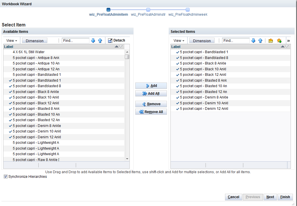

  2. The Workbook wizard opens. Select the specific products that you want to view and click Next.
    Figure 13-31 Workbook Wizard: Products
    Surrounding text describes Figure 13-31 .
  3. Select the specific stores that you want to view and click Next.
    Figure 13-32 Workbook Wizard: Stores
    Surrounding text describes Figure 13-32 .

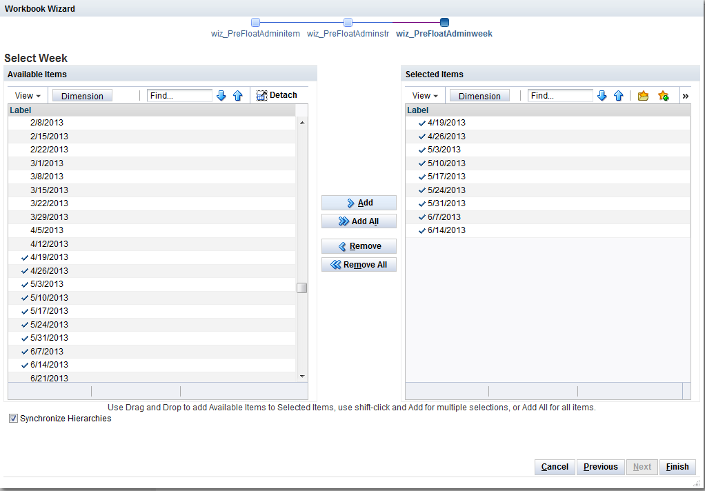

  4. Select the weeks you want to work with and click Finish.
    Figure 13-33 Workbook Wizard: Select Weeks
    Surrounding text describes Figure 13-33 .

Floating Event Calendar Maintenance View
The Floating Event Calendar Maintenance view allows you to flag periods when certain product/location combinations are active during an event.
Figure 13-34 Floating Event Calendar Maintenance View
Surrounding text describes Figure 13-34 .
Measures: Floating Event Calendar Maintenance View
The Floating Event Admin view contains the following measures:
Float Event Indicator (01-20)
These measures, numbered 1-20, allow you to flag up to 20 float events as active in history or to be active in the future.

  1. Click the New Workbook icon in the Promotion Effectiveness task in the Event Planning activity.
    Figure 13-35 Promotion Effectiveness Task
    Surrounding text describes Figure 13-35 .
    Figure 13-36 Workbook Wizard: Causal Level
    Surrounding text describes Figure 13-36 .
    Figure 13-37 Workbook Wizard: Select Promotions
    Surrounding text describes Figure 13-37 .
    Figure 13-38 Workbook Wizard: Select Products
    Surrounding text describes Figure 13-38 .
  5. Select the locations you want to work with and click Next.
    Figure 13-39 Workbook Wizard: Select Locations
    Surrounding text describes Figure 13-39 .
  6. Select the periods you want to work with and click Finish.
    Figure 13-40 Workbook Wizard: Select Weeks
    Surrounding text describes Figure 13-40 .
The Promotion Effectiveness workbook is built.
This view includes all the information available in the Final Level Causal Effect Parameters in the Promo Effect Maintenance workbook.
Figure 13-41 Final Level Causal Parameters View
Surrounding text describes Figure 13-41 .
Additionally there are a few measures (shown in Figure 13-41) that when used together with the ones in Figure 13-42 give total flexibility to you to generate the causal forecast you want.
All of these measures are described and are available for editing in the Forecast Administration workbook.
Figure 13-42 Additional Measures for the Final Level Causal Parameters View
Surrounding text describes Figure 13-42 .
This view includes all the information available in the Pooling Level Causal Effect Parameters in the Promo Effect Maintenance workbook
Figure 13-43 Pooling Levels Causal Parameters View
Surrounding text describes Figure 13-43 .
The Promotional Forecast step has several views:
The Causal Forecast view allows you visibility to the baseline and promotion lifts components of the forecast. This is the place you review the impact of the promo-related parameters set in the Promotions and Promotion Parameters views. The process of changing parameters, re-generating the promo forecast, and reviewing the impact in this view, implements the promotional What-if functionality.
Figure 13-44 Causal Forecast View
Surrounding text describes Figure 13-44 .
Measures: Causal Forecast View
The Causal Forecast view contains the following measures:
Forecasted Baseline
The Forecast Baseline is a forecast generated on past sales data that contains no promotions (that is, normal demand given no causal effects).
Promotion Lift Units
This measure displays the total effect that promotions can have on an item's sales units. It includes the effects of all the promotions active for that time period, as well as the price effect.
Total Promotional Forecast
This measure displays the sum of the baseline and the promotion lift.
For additional information, see "Promotion Variables."
The Promotions view allows you to review and enable or disable promotions for item/locations for desired periods. Once the changes in the promo calendar have been made, click Calculate to update the forecast values in the Promotional Forecast view.
Figure 13-46 Promotion Calendar View
Surrounding text describes Figure 13-46 .
Measures: Promotion Calendar View
The Promotion Calendar view contains the following measure:
Promotion Variables
