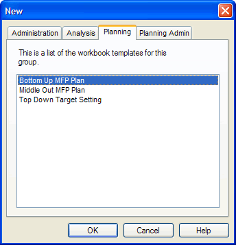

To open a Bottom Up MFP Plan workbook:
  1. Select New from the File menu, or click the New button in the toolbar.
  2. On the Planning tab, select Bottom Up MFP Plan and click OK.

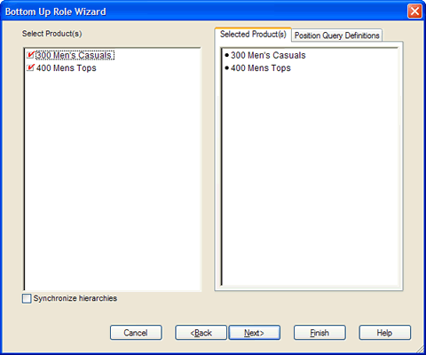

  3. The Product Selection step appears. Select the departments you want to examine and click Next.

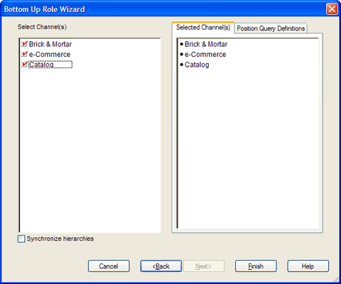

  4. The Location Selection step appears. Select the channels you want to examine and click Next.
    Figure 5-3 Bottom Up MFP Plan Wizard: Location Selection

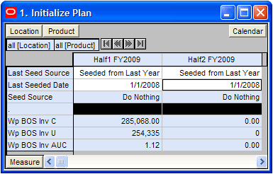

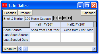

With this worksheet, you can choose to seed your plan with Last Year (Ly) or Adjusted Last Year data to create a demand curve on which to spread the new plan's initial targets. Or, you can instead choose to not seed the plan, which allows you to create a plan that is not influenced by last year's performance.
In the example above, both the Half1 FY2010 and Half2 FY2010 halves have been selected to be seeded with Ly data.

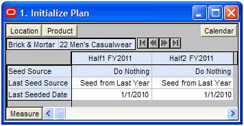

As shown in Figure 5-5, only the 300 Men's Casuals department of the Brick & Mortar channel has been selected to be seeded. This means that the other departments have not been selected to be seeded yet. To seed the next department in the Product hierarchy within the Brick & Mortar channel, perform the following steps:

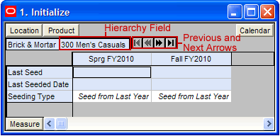

  1. Click within the hierarchy field that you want to change, as shown in Figure 5-6.
  2. Click the Next or Previous arrow, as shown in Figure 5-6.
    Figure 5-6 Changing a Hierarchy Dimension with Page Arrows
  3. The next dimension in the hierarchy appears. Note that the Seeding Type measure is now set to Do Nothing.
  4. Choose the seeding type for one or more halves.
  5. Click the Next arrow to view and seed the next dimension.

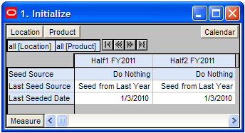

After you have seeded, the worksheet is refreshed and the Last Seed Source and Last Seeded Date measures contain the type and date of the last seed, as shown in Figure 5-9.
Figure 5-9 Seeded Working Plan

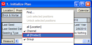

If you want to seed several locations and several products at once, you may want to change the dimension of the hierarchies shown in the worksheet.
The default setting of the Initialize Plan worksheet is set to show the Calendar hierarchy at the half dimension, the Location hierarchy at the channel dimension, and the Product hierarchy at the division dimension.
To change the hierarchy dimension shown in the worksheet, perform the following steps:
  1. Right-click the hierarchy tile of the hierarchy dimension you want to change.
    Figure 5-10 Hierarchy Tiles
  2. The right-click context menu appears. Select the dimension of the hierarchy that you want to appear, as shown in Figure 5-11.
    If you want to view more than one dimension at a time in the worksheet, select multiple dimensions.
    Figure 5-11 Seeding Several Dimensions at Once
  3. Deselect the dimensions that you do not want to appear.
    In Figure 5-12, Channel and Group were deselected and all[Location] and all[Product] were selected instead.
    Figure 5-12 Seeding All Locations and All Products

After you have seeded, the worksheet is refreshed and the Last Seed and Last Seeded Date measures contain the type and date of the last seed.
Figure 5-15 Seeded Working Plan

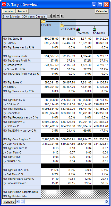

After you have seeded, review the department targets that the middle out user has created for you. The purpose of reviewing the targets is so that you can understand the goal that your plan should meet.
Since you develop subclass targets and that is level of the Product hierarchy that the worksheet defaults to, you must first change the Product hierarchy so that you can see the department level data instead of subclass data.

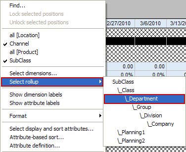

To change the level of the Product hierarchy that is visible in the worksheet, perform the following steps:
  1. Right-click the Product dimension tile.
  2. In the right-click context menu, click Select rollup and choose Department. This enables the department level to be visible in the worksheet.
    Figure 5-18 Changing the Rollup
  3. Right-click and deselect Class. Right-click again and deselect Subclass. This hides the class and subclass data.
    Figure 5-19 Changing the Dimension Selection
The worksheet is refreshed and the data in the MO Tgt measures is visible. Now you can review the department targets.
Figure 5-20 Target Overview Worksheet
The Target Overview worksheet contains the middle out target (MO Tgt) measures as well as last year (Ly) measures.
Use this worksheet to compare the MO Tgt measures to the corresponding Ly measures. By understanding how the middle out targets compare to last year's metrics, you can better understand what your plan needs to achieve.
All measures in the Target Overview worksheet are read-only. The measures that you edit are in other worksheets.

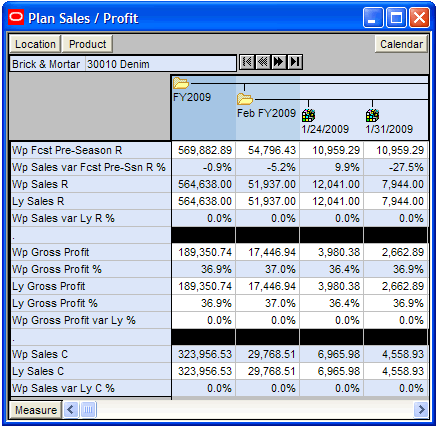

After you have seeded the groups and reviewed the middle out department targets, you can develop the sales and profit targets for the classes and subclasses within those departments using the Plan Sales and Profit worksheet.
Use the following best practices to plan the sales and profit.
  1. Review and compare the total sales to the forecast.
  2. Enter the planned sales in the Wp Sales R measure.
    Figure 5-22 Plan Sales and Profit Worksheet
  3. Enter the gross profit by editing either the Wp Gross Profit or Wp Gross Profit % measure.
  4. Enter the sales cost in the Wp Sales C measure.

Table 5-3 Plan Sales and Profit Worksheet Measures
Measure Description
Wp Fcst Pre-Season R
The preseason forecast.
Wp Sales var Fcst Pre-Ssn R%
The planned preseason sales variance forecast.
Wp Sales R
The planned sales retail value.
Ly Sales R
Last year's sales retail value.
Wp Sales var Ly R%
The planned sales retail variance to last year expressed as a rate.
Wp Gross Profit
The planned gross profit value.
Wp Gross Profit %
The planned gross profit expressed as a rate.
Ly Gross Profit
Last year's gross profit value.
Ly Gross Profit %
Last year's gross profit value expressed as a rate.
Wp Gross Profit var Ly R%
The planned variance between the target gross profit value and last year's actual gross profit, expressed as a percentage of last year.
Wp Sales C
The planned sales cost.
Ly Sales C
Last year's actual sales cost.
Wp Sales var Ly C %
The planned variance between the target sales cost value and last year's actual sales cot, expressed as a percentage of last year.

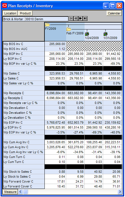

The Receipts / Inventory tab contains one worksheet, the Plan Receipts / Inventory worksheet.
Plan Receipts / Inventory Worksheet
After you have developed the sales and profit plan, develop a receipts and inventory plan that can support the sales and profit plan. The purpose of this step is to ensure that you have a receipt and inventory plan that supports the sales that you are projecting.
Like the Plan Sales and Profit Worksheet, the Plan Receipts / Inventory worksheet contains several Ly metrics that you can reference when setting your targets. There are also additional measures for adjusting your inventory targets. Note that the adjustments you made to the Wp Sales R measure in the Plan Sales and Profit worksheet are visible in this worksheet if you have calculated.
Use the following best practices to plan the receipts and inventory.
  1. Ensure that you have set the beginning of season (BOS) inventory in the Initialize Plan worksheet in the Getting Started tab. The BOS measures must be set before planning the receipts and inventory. To set the BOS measures, see the Setting Beginning of Season Inventory.
  2. Plan the receipt flow and then evaluate the average inventory and turn.
  3. Adjust the Wp Stock to Sales C measure accordingly. These adjustments affect the receipts for both the current month and prior month. However, the total plan period receipts do not increase or decrease; they only shift from month to month.

The following table lists the measures available on this worksheet.
Table 5-4 Plan Receipts / Inventory Worksheet Measures
Measure Description
Wp BOS Inv C
The planned beginning of season inventory cost.
Wp BOS Inv AUC
The planned beginning of season average unit cost.
Wp BOP Inv C
The planned beginning of period inventory cost. The period can be a week, month, or any other calendar period.
Ly BOP Inv C
Last year's beginning of period inventory cost. The period can be a week, month, or any other calendar period.
Wp BOP Inv var Ly C %
The planned variance between the target beginning of period inventory cost and last year's actuals, expressed as a percentage of last year.
Wp Sales C
The planned sales cost value.
Ly Sales C
Last year's sales cost value.
Wp Sales var Ly C %
The planned sales cost variance to last year, expressed as a rate.
Wp Receipts C
The planned receipt cost.
Ly Receipts C
Last year's receipt cost.
Wp Receipts var Ly C %
The planned variance between the target receipt cost and last year's actual receipt cost, expressed as a percentage of last year.
Wp Devaluation C
The planned devaluation cost.
Wp Devaluation C %
The planned devaluation cost rate.
Ly Devaluation C %
Last year's devaluation cost rate.
Wp EOP Inv C
The planned end of period inventory cost. The period can be a week, month, or any other calendar period.
Ly EOP Inv C
Last year's end of period inventory cost.
Wp EOP Inv var Ly C %
The planned variance between the target end of period inventory cost and last year's actual end of period cost, expressed as a percentage of last year.
Wp Cum Avg Inv C
The planned average cumulative inventory turns (cost). It is cumulated from the start week of the workbook.
Ly Cum Avg Inv C
Last year's cumulative average inventory value (cost), corresponding to the start week of the workbook until the current week.
Wp Cum Avg Inv var Ly C %
The planned variance between the target cumulative average inventory cost and last year's actuals, expressed as a percentage of last year.
Wp Cum Turn C
The planned cumulative inventory turns (cost). It is cumulated from the start week of the workbook.
Ly Cum Turn C
Last year's cumulative inventory turns (cost).
Wp Stock to Sales R Ratio
The planned ratio of the BOP inventory to the sales for the same period.
Ly Stock to Sales R Ratio
Last year's ratio of the BOP inventory to the sales for the same period.
Wp Forward Cover R
The planned number of weeks of forward cover for the period. Using the retail values sales of future weeks, this measure indicates how many weeks of sales can be fulfilled with the ending inventory of the period.
Ly Forward Cover R
Last year's forward cover for the period.

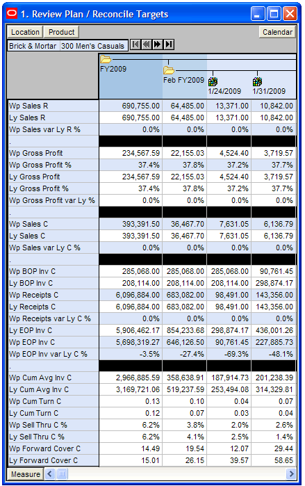

The Review Plan / Reconcile to Targets tab has one worksheet, the Review Plan / Reconcile Targets worksheet.
Review Plan / Reconcile Targets Worksheet
After you have created a plan, compare your plan to the middle out targets to see if you meet the goals created by the middle out user.
Use the default measure profile to the review the plan in total. Use the Reconcile to MO Targets measure profile to reconcile your plan to the middle out targets. When using this profile, set the calendar hierarchy to month.
Figure 5-24 Review Plan / Reconcile Targets Worksheet

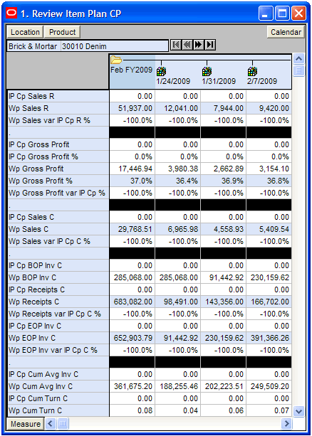

Review Item Plan CP Worksheet
There are three measure profiles for which you can use to compare your current plan:
  • Review Item Plan CP Unit Plan
  • Review Item Plan CP Value Plan
  • Default
Figure 5-25 Review Item Plan CP Worksheet

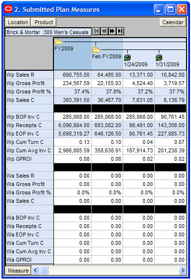

Submitted Plan Measures
Use the Submitted Plan Measures worksheet to compare your Wp to the Wa you may have already submitted. This allows you to identify the differences between the two versions after you have submitted the plan for approval.
The Submitted Plan Measures worksheet has four different measure profiles:
  • Review Submitted Plan to Current Plan
  • Review Submitted Plan to Original Plan
  • Submitted Plan Value and Unit Measures
  • Default
Figure 5-28 Submitted Plan Worksheet: Default Measure Profile

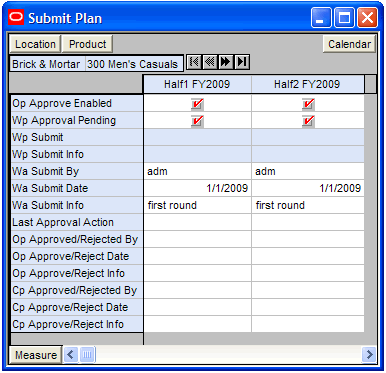

Submit Plan Worksheet
When you are ready to submit your working plan to the middle out user for approval, use the Submit Plan worksheet.
When the Op Approve Enabled measure is selected, you can submit a plan for the Op version. This measure is set by an administrator in the Enable OP Approval administration workbook. The administrator can select or deselect this option at any time. If the administrator deselects it during the in-season, you will not be able to submit a plan for the Op. The administrator may choose to do this after the planning process has been finalized in order to lock down the Op. If this occurs, you will be unable to submit a plan for the Op and the middle out user will be unable to approve a plan for the Op.
Figure 5-29 Submit Plan Worksheet
To submit the working plan, perform the following steps:
  1. Select what you want to submit the working plan to using the Wp Submit measure. Options are Submit Op Only, Submit Cp Only, or Submit Op and Cp.
  2. Optional: Enter information about the working plan in the Wp Submit Info measure.
  3. When finished, select the Submit option in the Planning Actions menu.
    Figure 5-30 Planning Actions Menu: Submit
  4. A success message appears. Click OK to close it.
    Figure 5-31 Success Message: Submit and Commit
As a result of the submit option running, the Wp Submit and Wp Submit Info measures are cleared and the Wp Approval Pending check box is checked. The Wa Submit By, Wa Submit Date, and Wa Submit Info measures are populated. In addition, your working plan is copied into a Waiting for Approval (Wa) plan.
Figure 5-32 Successfully Submitted Plan
