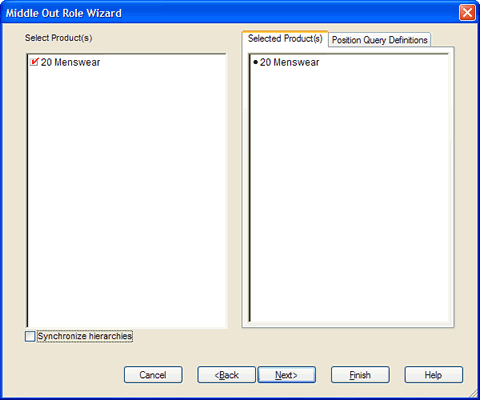

  3. The Product Selection step appears. Select the divisions you want to examine and click Next.
    Figure 4-2 Middle Out MFP Plan Wizard: Product Selection

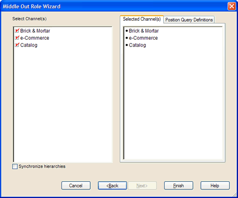

  4. The Location Selection step appears. Select the channels you want to examine and click Next.
    Figure 4-3 Middle Out MFP Plan Wizard: Location Selection

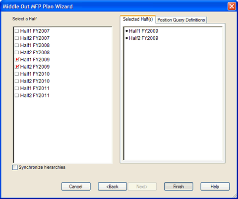

  5. The Calendar Selection step appears. Select the halves you want to examine and click Finish.
    Figure 4-4 Middle Out MFP Plan Wizard: Calendar Selection

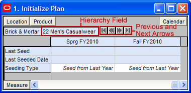

As shown in Figure 4-5, only the 22 Men's Casualwear group of the Brick & Mortar channel has been selected to be seeded. This means that the other product groups have not been selected to be seeded yet. To seed the next department in the Product hierarchy within the Brick & Mortar channel, perform the following steps:
  1. Click within the hierarchy field that you want to change, as shown in Figure 4-6.
  2. Click the Next or Previous arrow, as shown in Figure 4-6.

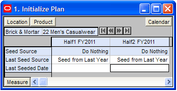

  3. The next dimension in the hierarchy appears. Note that the Seeding Type measure is now set to Do Nothing.
  4. Choose the seeding type for one or more halves.
  5. Click the Next arrow to view and seed the next dimension.
  6. When you have selected all the data you want to seed, click Seed in the Planning Actions menu.
    Figure 4-7 Planning Actions Menu: Seed
  7. A confirmation message appears, stating that the data has been successfully seeded. Click OK.
    Figure 4-8 Seeding Success Message
After you have seeded, the worksheet is refreshed and the Last Seed Source and Last Seeded Date measures contain the type and date of the last seed, as shown in Figure 4-9.
Figure 4-9 Seeded Working Plan

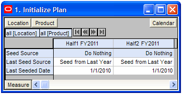

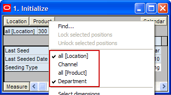

Seeding Several Dimensions at Once
If you want to seed several locations and several products at once, you may want to change the dimension of the hierarchies shown in the worksheet.
The default setting of the Initialize Plan worksheet is set to show the Calendar hierarchy at the half dimension, the Location hierarchy at the channel dimension, and the Product hierarchy at the department dimension.
To change the hierarchy dimension shown in the worksheet, perform the following steps:

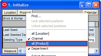

  1. Right-click the hierarchy tile of the hierarchy dimension you want to change.
    Figure 4-10 Hierarchy Tiles
  2. The right-click context menu appears. Select the dimension of the hierarchy that you want to appear, as shown in Figure 4-11.
    If you want to view more than one dimension at a time in the worksheet, select multiple dimensions.
    Figure 4-11 Seeding Several Dimensions at Once
  3. Deselect the dimensions that you do not want to appear.
    In Figure 4-12, Channel and Department were deselected and all[Location] and all[Product] were selected instead.
    Figure 4-12 Seeding All Locations and All Products

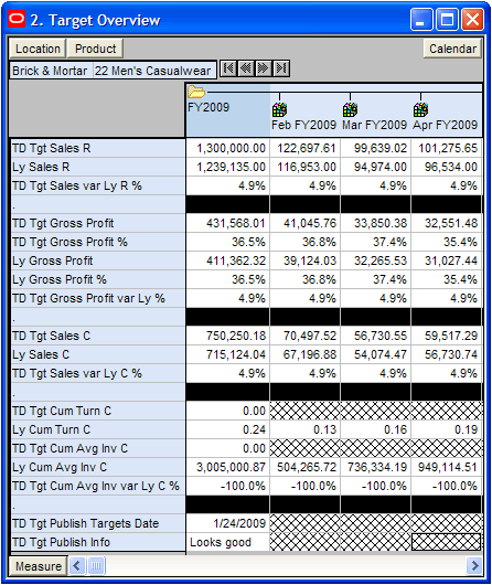

After you have seeded the groups, use the Target Overview worksheet to review the targets created by the top down user to understand the goal that your plan should meet.
The top down targets are at the group level, but the worksheet shows the department level by default. To see the targets, change the level of the Product hierarchy from department to group. To see the TD Tgt Publish Date and Info measures, change the level to division and include year in the Calendar rollup.
Figure 4-18 Target Overview Worksheet
The Target Overview worksheet contains the top down target (TD Tgt) measures as well as last year (Ly) measures.
Use this worksheet to compare the TD Tgt measures to the corresponding Ly measures. By understanding how the top down targets compare to last year's metrics, you can better understand what your plan needs to achieve.
All measures in the Target Overview worksheet are read-only. The measures that you edit are in other worksheets.

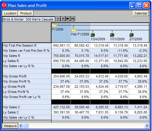

After you have seeded the groups and reviewed the top down group targets, you can plan the sales and profit targets for the departments within those groups using the Plan Sales and Profit worksheet.
The top down user plans top down targets at the month level. As the middle out user, you should use those targets to create more detailed targets at the week level. This allows you to create a weekly EOP plan that has more accurate average inventory and turn-over plans.
Use the following best practices to plan the sales and profit.
  1. Review and compare the total sales to the forecast.
  2. Enter the planned sales in the Wp Sales R measure.
    Figure 4-20 Plan Sales and Profit Worksheet
  3. Enter the gross profit by editing either the Wp Gross Profit or Wp Gross Profit % measure.
  4. Enter the sales cost in the Wp Sales C measure.

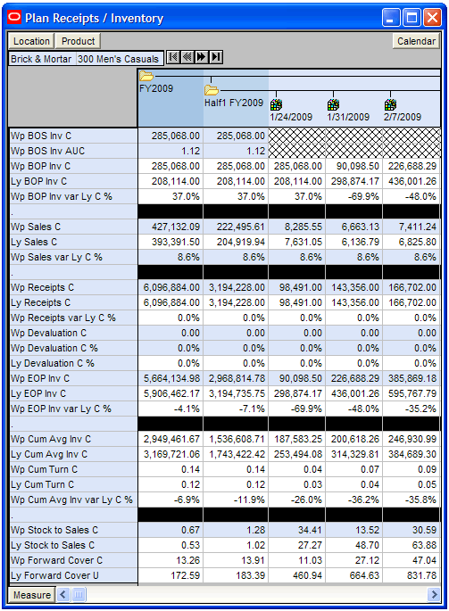

The Receipts / Inventory tab contains one worksheet, the Plan Receipts / Inventory worksheet.
Plan Receipts / Inventory Worksheet
After you have developed the sales and profit plan, develop a receipts and inventory plan that can support the sales that you are projecting in the sales and profit plan.
Like the Plan Sales and Profit Worksheet, the Plan Receipts / Inventory worksheet contains several Ly metrics that you can reference when setting your targets. There are also additional measures you can use to adjust your inventory targets. Note that the adjustments you made to the Wp Sales R measure in the Plan Sales and Profit Worksheet are visible in this worksheet if you have calculated.
Use the following best practices to plan the receipts and inventory.
  1. Ensure that you have set the beginning of season (BOS) inventory in the Initialize Plan worksheet in the Getting Started tab. The BOS measures must be set before planning the receipts and inventory. To set the BOS measures, see the Setting Beginning of Season Inventory.
  2. Plan the receipt flow and then evaluate the average inventory and turn.
  3. Adjust the Wp Stock to Sales C measure accordingly. These adjustments affect the receipts for both the current month and prior month. However, the total plan period receipts do not increase or decrease; they only shift from month to month.
Figure 4-21 Plan Receipts / Inventory Worksheet
The following table lists the measures available on this worksheet.
Table 4-4 Plan Receipts / Inventory Worksheet Measures
Measure Description
Wp BOS Inv C
The planned beginning of season inventory.
Wp BOS Inv AUC
The planned beginning of season average unit cost rate. (The BOS Inv AUC must be planned to get the BOS Cost).
Wp BOP Inv C
The planned beginning of period inventory cost. The period can be a week, month, or any other calendar period.
Ly BOP Inv C
Last year's beginning of period inventory cost. The period can be a week, month, or any other calendar period.
Wp Sales C
The planned sales cost value.
Ly Sales C
Last year's sales cost value.
Wp Sales var Ly C %
The planned sales cost variance to last year, expressed as a rate.
Wp Receipts C
The planned receipt cost.
Ly Receipts C
Last year's receipt cost.
Wp Receipts var Ly C %
The planned variance between the target receipt cost and last year's actual receipt cost, expressed as a percentage of last year.
Wp Devaluation C
The planned devaluation cost.
Wp Devaluation C %
The planned devaluation cost rate.
Ly Devaluation C %
Last year's devaluation cost rate.
Wp EOP Inv C
The planned end of period inventory cost. The period can be a week, month, or any other calendar period.
Ly EOP Inv C
Last year's end of period inventory cost.
Wp EOP Inv var Ly C %
The planned variance between the target end of period inventory cost and last year's actual end of period cost, expressed as a percentage of last year.
Wp Cum Avg Inv C
The planned average cumulative inventory turns (cost). It is cumulated from the start week of the workbook.
Ly Cum Avg Inv C
Last year's cumulative average inventory value (cost), corresponding to the start week of the workbook until the current week.
Wp Cum Turn C
The planned cumulative inventory turns (cost). It is cumulated from the start week of the workbook.
Ly Cum Turn C
Last year's cumulative inventory turns (cost).
Wp Cum Avg Inv var Ly C %
The planned variance between the target average cumulative inventory turns (cost) and last year's actuals, expressed as a percentage of last year.
Wp Stock to Sales C
The planned ratio of the BOP inventory to the sales for the same period.
Ly Stock to Sales C
Last year's ratio of the BOP inventory to the sales for the same period.
Wp Forward Cover C
The planned number of weeks of forward cover for the period. Using the cost values sales of future weeks, this measure indicates how many weeks of sales can be fulfilled with the ending inventory of the period.
Ly Forward Cover C
Last year's forward cover for the period.
Now that you have developed your targets, continue to the Review Plan / Publish Targets Tab.

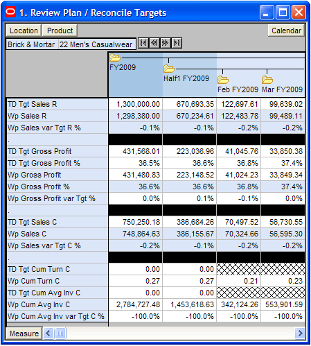

Review Plan / Reconcile Targets Worksheet
In this worksheet, review the targets created from previous worksheets. If you need to alter the targets shown in this worksheet, return to the worksheet where you created them and edit them there.
Use the default measure profile to the review the plan in total. Use the Reconcile to TD Targets measure profile to reconcile your plan to the top down targets. When using this profile, set the calendar hierarchy to month and product to group.
Figure 4-22 Review Plan / Reconcile Worksheet
If you are satisfied with the plan you have created, continue to the Publish Targets Worksheet.

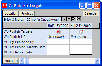

Publish and Commit Targets
Publishing and committing a target copies your middle out Wp measure information to the MO Tgt measures in your workbook.
To publish the targets, perform the following steps.
  1. Select the halves in the Wp Publish Targets measure that you want to publish.
  2. If needed, enter relevant information in the Wp Publish Info measure. This is optional.
  3. Repeat steps 1 and 2 for other locations and products if necessary.
  4. Click Publish Targets in the Planning Actions menu, as shown in Figure 4-24.
    Figure 4-24 Planning Actions Menu: Publish Targets
  5. A success message appears. Click OK to close it.
    Figure 4-25 Success Message: Publish Targets
The worksheet is refreshed and the Wp Publish Targets and Wp Publish Info measures are cleared. The MO Tgt measures in this worksheet are populated. These measures are described in detail in the following table.
Figure 4-26 Successfully Published Targets

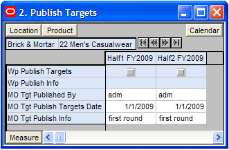

Table 4-5 Publish Targets Worksheet Measures
Measure Description
Wp Publish Targets
Use this measure to select the targets you want to publish.
Wp Publish Info
Use this measure to enter relevant target information. This measure is optional.
MO Tgt Published By
After a target is published, this measure displays the username of the person who published the targets.
MO Tgt Publish Targets Date
After a target is published, this measure displays the date that the target was published.
MO Tgt Publish Info
After a target is published, this measure displays the information that was entered in the Wp Publish Info measure.
After you have published your targets, the bottom up user can use your department targets to create their class and subclass plans. To learn about the bottom up user's role, see the Bottom Up: Preseason Planning chapter.
