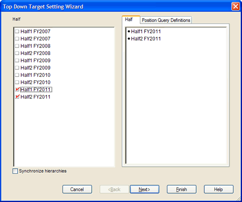

To open a Top Down Target Setting workbook:
Select New from the File menu, or click the New button in the toolbar.
On the Planning tab, select Top Down Target Setting and click OK.
The Product Selection step appears. Select the company you want to examine and click Next.
The Location Selection step appears. Select the channels you want to examine and click Next.
The Calendar Selection step appears. Select the halves you want to examine and click Finish.
The Top Down Target Setting workbook is built.

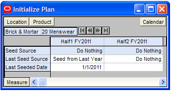

With this worksheet, you can choose to seed your plan with Last Year (Ly) or Adjusted Last Year (Adj Ly) data to create a demand curve on which to spread the new plan's initial targets. Or, you can instead choose to not seed the plan, which allows you to create a plan that is not influenced by last year's performance.
In the example above, the Half1 FY2011 half has been selected to be seeded with Ly data. The Half2 FY2011 half has been selected to not be seeded.
When seeding the plan, you can choose which information is seeded. For example, you can seed just one half or all halves in the workbook. You can also choose what locations and products to seed.
There are two ways you can seed. You can seed each dimension individually, or you can seed several dimensions at once by changing the hierarchy dimension shown in the worksheet.
As shown in Figure 3-5, only the 20 Menswear division of the Brick & Mortar channel has been selected to be seeded. This means that the other product divisions have not been selected to be seeded yet. To seed the next division in the Product hierarchy within the Brick & Mortar channel, perform the following steps:

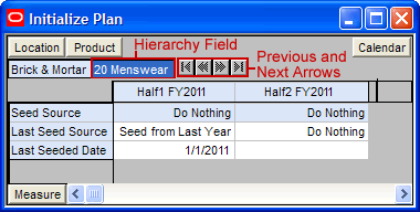

Click within the hierarchy field that you want to change, as shown in Figure 3-6.
Click the Next or Previous arrow, as shown in Figure 3-6.
The next dimension in the hierarchy appears. Note that the Seed Source measure is now set to Do Nothing.
Choose the seed source for one or more halves.
Click the Next arrow to view and seed the next dimension.
When you have selected all the data you want to seed, click Seed in the Planning Actions menu.
A confirmation message appears, stating that the data has been successfully seeded. Click OK.
After you have seeded, the worksheet is refreshed and the Last Seed Source and Last Seeded Date measures contain the type and date of the last seed, as shown in Figure 3-9.

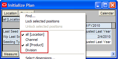

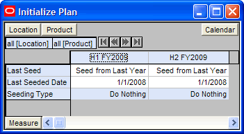

If you want to seed several locations and several products at once, you may want to change the dimension of the hierarchies shown in the worksheet.
The default setting of the Initialize Plan worksheet is set to show the Calendar hierarchy at the half dimension, the Location hierarchy at the channel dimension, and the Product hierarchy at the division dimension.

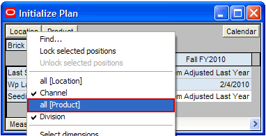

To change the hierarchy dimension shown in the worksheet, perform the following steps:
Right-click the hierarchy tile of the hierarchy dimension you want to change.
The right-click context menu appears. Select the dimension of the hierarchy that you want to appear, as shown in Figure 3-11.
If you want to view more than one dimension at a time in the worksheet, select multiple dimensions.
Deselect the dimensions that you do not want to appear.
In Figure 3-12, Channel and Division were deselected and all[Location] and all[Product] were selected instead.
After the hierarchies are at the dimension you want, select the Seed Source for each half.
When you have selected all the data you want to seed, click Seed in the Planning Actions menu, as shown in Figure 3-13.
After you have seeded, the worksheet is refreshed and the Last Seed Source and Last Seeded Date measures contain the type and date of the last seed.

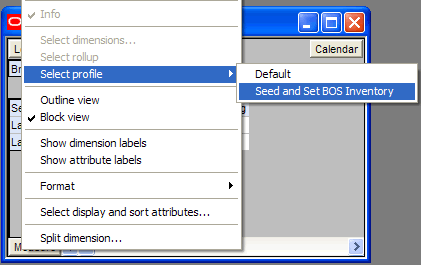

After you have seeded, set the Beginning of Season (BOS) inventory. By entering the BOS inventory that you project for the season, you can set the BOS markup for that inventory, which allows the BOS cost to be calculated.
To set the BOS, perform the following steps:
In the Initialize Plan worksheet, change the measure profile to Seed and Set BOS Inventory.
The worksheet is refreshed and the Seed and Set BOS Inventory measures are visible.
Change the calendar hierarchy rollup to year.
Enter data in the BOS Inv C measure.
Click Calculate.

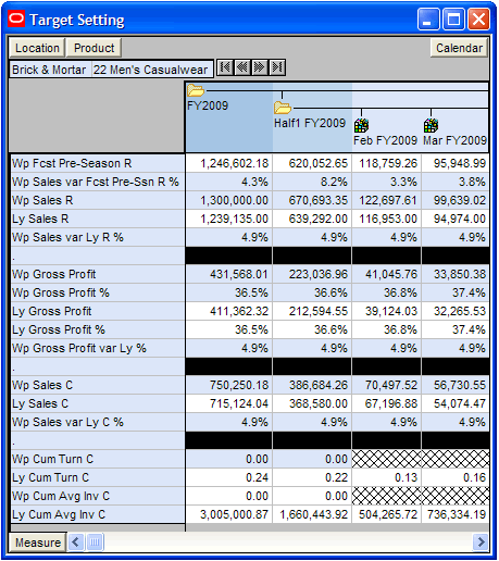

The Target Setting tab contains one worksheet, Target Setting.
After you have seeded the divisions, use the Target Setting worksheet to develop the sales and gross profit targets for groups within those divisions.
The following table lists the measures available on this worksheet.

To create the top down targets, perform the following steps:
Change the Calendar hierarchy so that year is displayed.
Enter the Wp Sales R that you are projecting. Use the Wp Fcst Pre-season R measure as a guide.
Plan the gross profit by editing either the Wp Gross Profit or Wp Gross Profit % measure.
Plan the cost by editing the Wp Sales C measure.
Enter the Wp Cum Turn C at the half level.
Note: The turn at the year is calculated by using the average inventory from the second half as the year average inventory. The turn for the year is calculated from the average inventory at the year level. |
Click Calculate to populate the Wp Cum Avg Inv C measure.

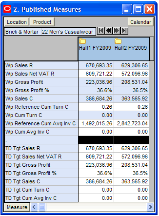

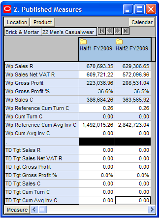

Use this worksheet to review the Wp measures before you publish them.
If the workbook has never been published, the top down target (TD Tgt) measures have no values, as shown in Figure 3-20. After the workbook has been published, these are populated, as shown in Figure 3-21.
