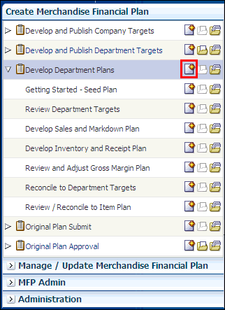

The bottom up user must complete these seven steps on the Develop Department Plans task in order to create the department plans and submit them for approval to the middle out user. To do this, the bottom up user must first build the workbook.
Building the Workbook
To build the bottom up role workbook, perform the following steps.
  1. Click the Create New Workbook icon in the Develop Department Plans task.
    Figure 5-2 Create New Workbook Icon

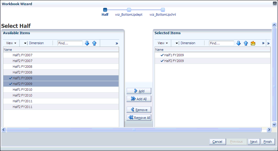

  2. The workbook wizard opens at the Calendar Selection step. Select the halves that you want to plan and move them to the Selected Items box. Click Next.
    Figure 5-3 Workbook Wizard: Calendar Selection

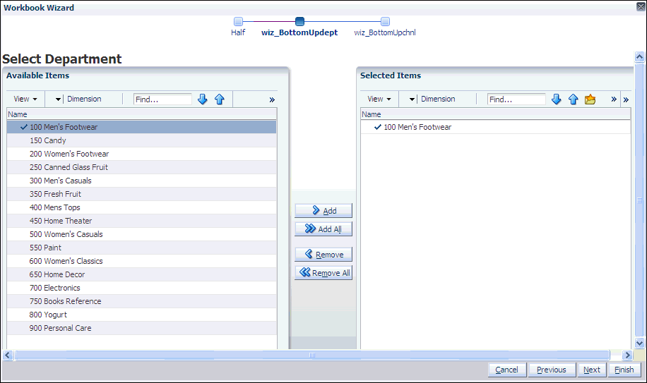

  3. The Product Selection step of the workbook wizard is displayed. Select the department you want to plan and move it to the Selected Items box. Click Next.
    Figure 5-4 Workbook Wizard: Product Selection

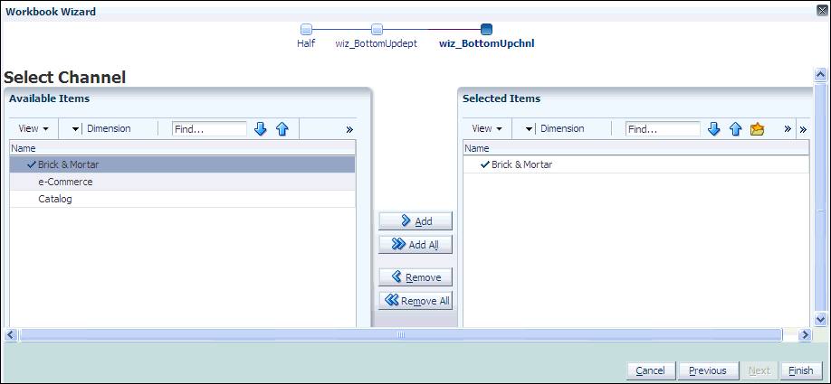

  4. The Location Selection step of the workbook wizard is displayed. Select the channels you want to plan and move them to the Selected Items box. Click Finish.
    Figure 5-5 Workbook Wizard: Location Selection
The Bottom Up Role workbook is built, and the Initialize view opens.

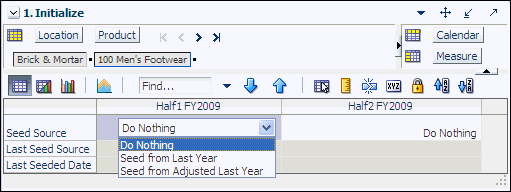

With this view, you can choose to seed your plan with Last Year (Ly) or Adjusted Last Year (Adj Ly) data to create a demand curve on which to spread the new plan's initial targets. Or, you can instead choose to not seed the plan, which allows you to create a plan that is not influenced by last year's performance.
In the preceding example, both the Half1 FY2009 and Half2 FY2009 halves have been selected to be seeded with Ly data.
Seeding the Plan
When seeding the plan, you can choose which information is seeded. For instance, you can seed just one half or all halves in the task, as shown in Figure 5-6. You can also choose what locations and products to seed.
There are two ways you can seed. You can seed each level individually, or you can seed several levels at once by changing the dimension level shown in the view.

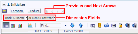

As shown in Figure 5-6, only the Brick & Mortar channel and the 100 Men's Footwear department have been selected to be seeded with Ly data. This means that the other Product departments have not been selected to be seeded yet. To seed the next department in the Product dimension within the Brick & Mortar channel, perform the following steps:
  1. Click within the dimension field that you want to change, as shown in Figure 5-7.
  2. Click the Next or Previous arrow, as shown in Figure 5-7.
    Figure 5-7 Changing a Dimension Level with Page Arrows
  3. The page refreshes and the next department in the Product dimension is displayed in the page edge. Note that the Seed Source measure is no longer populated.
  4. Select the half that you want to seed with Ly or Adj Ly data.
  5. Click the Next arrow to view and seed the next department.

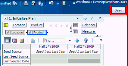

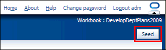

  6. When you have selected all the data you want to seed, click Seed in the top, right corner.
    Figure 5-8 Seed Button
  7. A confirmation message is displayed, stating that the data has been successfully seeded. Click OK.
    Figure 5-9 Seeding Success Message
After you have seeded, the view refreshes and the Last Seed Source and Last Seed Date measures contain the source and date of the last seed.

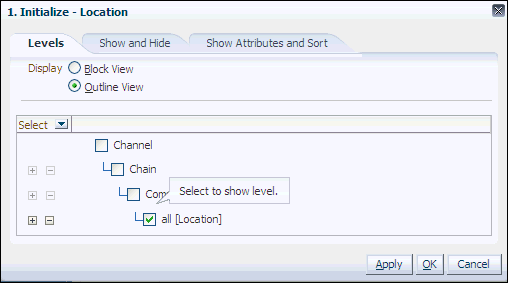

To change the dimension level shown in the page edge or grid, perform the following steps:
  1. Click the dimension tile of the dimension level you would like to change.
    Figure 5-10 Location Dimension Tile
  2. The dimension window is displayed. Select the level of the dimension that you want to appear in the page edge. If you want to view more than one level at a time in the page edge or grid, select multiple levels. In Figure 5-11, Channel was deselected and all [Location] was selected instead.
    Figure 5-11 Location Dimension Window
  3. Click OK when finished.

  6. When you have selected all the data you want to seed, click Seed in the top, right corner, as shown in Figure 5-12.
    Figure 5-12 Seeding Several Levels at Once
  7. The view refreshes and the Last Seeded Source and Last Seed Date measures contain the source and date of the last seed. A confirmation message is displayed, stating that the data has been successfully seeded. Click OK.

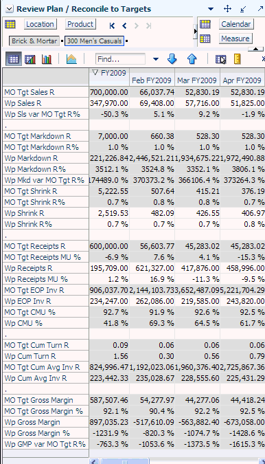

Review Department Targets
After you have seeded, you need to review the department targets that the middle out user has created for you. The purpose of reviewing the targets is so that you can understand the goal that your plan should meet.
Figure 5-16 Target Overview View
Since you develop subclass targets and that is level of the Product dimension that the view defaults to, you must first change the Product dimension so that you can see the department level data instead of subclass data.
To change the level of the Product dimension that is visible in the view, perform the following steps:
  1. Click the Product dimension tile. The 2. Target Overview - Product dialog window opens.
  2. On the Levels tab, select Department. This enables the department level to be visible in the view.
  3. Deselect Subclass. This hides the subclass level data.
  4. Click OK. The dialog box closes.
The view refreshes and the data in the MO Tgt measures is visible. Now you can review the department targets.
The Target Overview view contains the middle out target (MO Tgt) measures as well as last year (Ly) measures.
Use this view to compare the MO Tgt measures to the corresponding Ly measures. By understanding how the middle out targets compare to last year's metrics, you can better understand what your plan needs to achieve.
All measures in the Target Overview view are read-only. The measures that you edit are in other views.

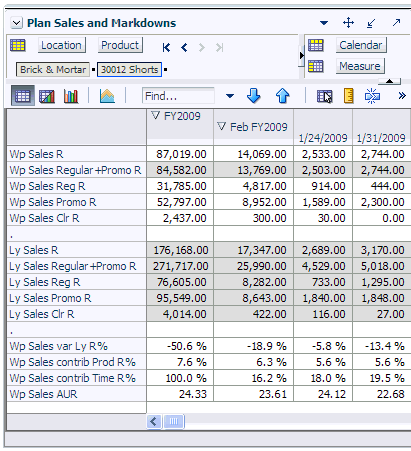

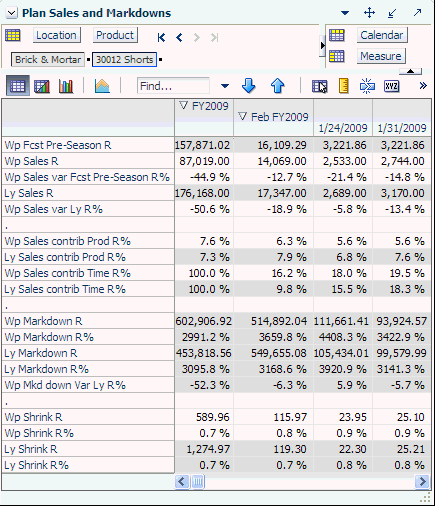

Develop Sales and Markdown Plan
After you have seeded the groups and reviewed the middle out department targets, you can develop the sales and markdown targets for the classes and subclasses within those departments using the Plan Sales and Markdowns view.
Use the following best practices to plan the sales and markdowns.
  1. Using the default measure profile, which is Sales and Markdowns, review and compare the total sales to the forecast.
  2. Change the measure profile to Sales by Type.
    Figure 5-18 Plan Sales and Markdowns View, Sales by Type Measure Profile
  3. In the Sales by Type measure profile, plan your sales by type. The sales types are regular (Reg), promotional (Promo), clearance (Clr), and regular and promotional (Reg + Promo).
    Since Sales and Markdowns are both planned at the type level, you must first complete the sales by type planning before you can plan the markdowns by type.
    Start by planning the regular sales. Then, using your marketing calendar as a guide, align the promotional sales to the calendar. Refer to the calendar again for the exit weeks for the products, and plan the clearance sales for those weeks.
    The planned figures for these sales types populates the Wp Sales R measure.

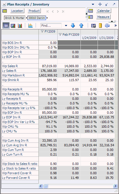

  4. Return to the Sales and Markdowns measure profile.
    Figure 5-19 Plan Sales and Markdowns View
  5. With the total Wp Sales R populated, you can adjust the total to your target while still maintaining the relationships between the different sales types.
  6. Plan the shrink with either the Wp Shrink R or Wp Shrink R% measure.

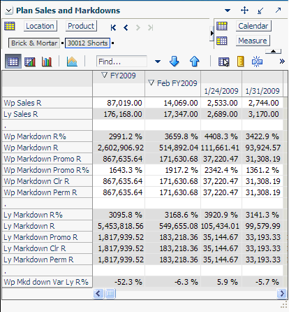

  7. Change the measure profile to Markdown by Type.
  8. In the Markdown by Type profile, edit the Wp Markdown Promo R% to adjust the Wp Markdown Promo Rate.
    Figure 5-20 Plan Sales and Markdowns View, Markdown by Type Measure Profile
The following table lists the measures available on the default measure profile of this view.
Table 5-3 Plan Sales and Markdowns View Measures
Measure Description
Wp Fcst Pre-Season R
The preseason forecast.
Wp Sales R
The planned sales retail value.
Wp Sales var Fcst Pre-Season R%
The planned preseason sales variance forecast.
Ly Sales R
Last year's sales retail value.
Wp Sales var Ly R%
The planned sales retail variance to last year expressed as a percentage.
Wp Markdown R
The planned markdown value.
Wp Markdown R%
The planned markdown value expressed as a percentage of total sales retail.
Ly Markdown R
Last year's markdown value.
Ly Markdown R%
Last year's markdown value expressed as a percentage of total sales retail.
Wp Markdown Var Ly R%
The planned variance between the target markdown value and last year's actual markdown, expressed as a percentage of last year.
Wp Shrink R
The planned shrink for the period. Shrink is loss due to reason such as damage or theft.
Wp Shrink R%
The planned shrink for the period, expressed as a percentage of total sales retail.
Ly Shrink R
Last year's actual shrink. Shrink is loss due to reason such as damage or theft.
Ly Shrink R%
Last year's actual shrink, expressed as a percentage of total sales retail.
After you have adjusted the sales and markdown plan, continue to the next step: Develop Inventory and Receipt Plan.

Like the Plan Sales and Markdowns View, the Plan Receipts/Inventory view contains several Ly metrics that you can reference when setting your targets. There are also additional measures for adjusting your inventory targets. Note that the adjustments you made to the Wp Sales R measure in the Plan Sales and Markdowns view are visible in this view if you have calculated.
Use the following best practices to plan the receipts and inventory.
  1. Ensure that you have set the beginning of season (BOS) inventory in the Initialize Plan view in the Getting Started tab. The BOS measures must be set before planning the receipts and inventory. To set the BOS measures, see Setting Beginning of Season Inventory.
  2. Plan the receipt flow and then evaluate the average inventory and turn.
  3. Review the Wp CMU % measure. Cumulative markup rate (CMU %) is a blend of the beginning of period (BOP) inventory retail and cost with the future receipt retail and receipt cost. The Wp CMU % directly affects the cost of goods sold (COGS), which then affects the gross margin.
  4. Adjust the Wp Stock to Sales R measure accordingly. These adjustments affect the receipts for both the current month and prior month. However, the total plan period receipts do not increase or decrease; they only shift from month to month.
Figure 5-21 Plan Receipts / Inventory View
The following table lists the measures available on this view.
Table 5-4 Plan Receipts / Inventory View Measures
Measure Description
Wp BOS Inv R
The planned beginning of period inventory in retail value. The period can be a week, month, or any other calendar period.
Wp BOS Inv IMU %
The planned markup percentage for the beginning of season inventory. (The BOS Inv IMU% must be planned to get the BOS Cost).
Wp BOP Inv R
Ly BOP Inv R
Last year's beginning of period inventory. The period can be a week, month, or any other calendar period.
Wp Sales R
Ly Sales R
Wp Markdown R
Wp Shrink R
Wp Receipts R
The planned receipt value.
Wp Receipts MU %
The planned receipts markup as a percentage of retail value.
Ly Receipts R
Last year's receipts.
Ly Receipts MU %
The actual receipt markup percentage for last year.
Wp Rec Var Ly R%
The variance between the planned receipts and last year's actual receipts, expressed as a percentage of last year.
Wp EOP Inv R
The planned end of period inventory. The period can be a week, month, or any other calendar period.
Ly EOP Inv R
Last year's end of period inventory. The period can be a week, month, or any other calendar period.
Wp CMU %
The planned cumulative markup percent, cumulated from the start week of the task.
Ly CMU %
Last year's cumulative markup percent, cumulated for the same period last year, corresponding to the start week of this task until the current week.
Wp Cum Avg Inv R
The planned cumulative average inventory value, expressed in retail value, cumulated from the start of the season.
Ly Cum Avg Inv R
Last year's cumulative average inventory value (retail), cumulated for the same period last year, corresponding to the start week of the task until the current week.
Wp Cum Turn R
The planned cumulative inventory turns (retail). It is cumulated from the start week of the task.
Ly Cum Turn R
Last year's cumulative inventory turns (retail). It is cumulated from the same week last year, corresponding to the first week in the task.
Wp Stock to Sales R Ratio
The planned ratio of the BOP inventory to the sales for the same period.
Ly Stock to Sales R Ratio
Last year's ratio of the BOP inventory to the sales for the same period.
Wp Forward Cover R
The planned number of weeks of forward cover for the period. Using the retail values sales of future weeks, this measure indicates how many weeks of sales can be fulfilled with the ending inventory of the period.
Ly Forward Cover R
Last year's forward cover for the period.
After you have created an achievable receipts and inventory plan, continue to the Review and Adjust Gross Margin Plan to see if your sales and inventory plans achieve the gross margin goal you have been given.

Reconcile to Department Targets
After you have created a plan, compare your plan to the middle out targets to see if you meet the goals created by the middle out user.
Use the default measure profile of the Review Plan/Reconcile to Targets view to the review the plan in total. Use the Reconcile to MO Targets measure profile to reconcile your plan to the middle out targets. When using this profile, set the calendar hierarchy to month.
Figure 5-23 Review Plan / Reconcile To Targets View
After you are satisfied that the plan you have created sufficiently meets the middle out targets, you can submit your plan to the middle out user. For more information about submitting the plan, see Original Plan Submit. Or, you could perform an optional step before submitting it: the Review/Reconcile to Item Plan step.

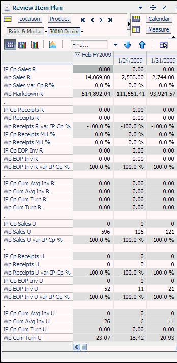

The Review Item Plan view is optional. If your company uses Oracle Retail Item Planning (IP), you can review and reconcile your subclass plan to the approved item plan that was created with that product.
The approved item plan is loaded into MFP from IP through nightly or weekly batch processing. Approved data is exported from IP and loaded into MFP at the subclass level. The aggregation takes place within IP when exporting. Only the plans that have been approved since the last export in IP are imported into MFP.
If an item plan OP or item plan CP has been committed, and the batch has run, which brings those measures in the Bottom Up task, then the bottom up planner can use this view to compare them. However, there is no hard reconciliation between MFP and IP.
There are six measure profiles for which you can use to compare your plan:
  • Review Item Plan CP Unit Plan
  • Review Item Plan CP Value and Units
  • Review Item Plan CP Value Plan
  • Review Item Plan OP Unit Plan
  • Review Item Plan OP Value and Units
  • Review Item Plan OP Value Plan
Figure 5-24 Review Item Plan, CP Value and Units Measure Profile
Table 5-6 Review Item Plan View: Review Item Plan CP Value and Units Measure Profile Measures
Measure Description

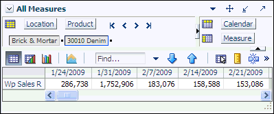

All Measures
The All Measures view includes all the measures contained in the task; however, only the Wp Sales R measure is visible in the default measure profile. The purpose of this task is to allow you to create a view of task measures that you may not be able to view all at once in other views.
Figure 5-31 Review Targets - All Measures
To see the other measures in this view, perform the following steps:
  1. Click the Measure dimension tile. The All Measures - Measure window is displayed.
  2. Move the measures you want to see in the view from the Hidden Measures box to the Visible Measures box.
  3. When finished, click OK.
For more information about hidden and visible measures, see the Oracle Retail Predictive Application Server User Guide for the Fusion Client.
