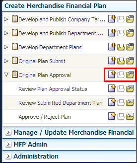

After the bottom up user submits a plan, the middle out user can review the plan and approve or reject it in the Original Plan Approval task.
To see the bottom up user's plan, either build a new workbook or open an existing one from the Original Plan Approval task, as shown in Figure 6-1.
If you open an existing task, you must refresh it to see the bottom up user's plan. To refresh a task, click the Refresh icon in the toolbar or select the Refresh option in the Edit menu.

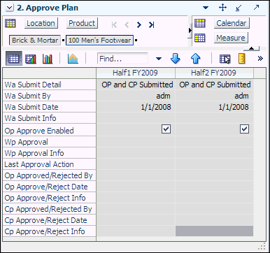

The first step in the Original Plan Approval task is the Review Plan Approval Status view. This view shows you which bottom up user submitted the plan, what they submitted it to, when it was submitted, and any notes that user may have added.
You can approve or reject the plan at this view, but it is recommended that you first view the plan at the next step.

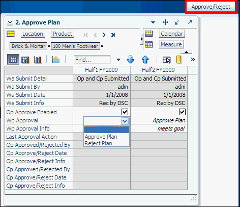

After you have reviewed the submitted Wa plan, approve or reject it at this step.
The view in this step is Approve Plan, the same one that is shown in the first step, Review Plan Approval Status.
In the Wp Approval measure, select one of the two options: Approve Plan or Reject Plan.
In the Wp Approval Info measure, enter any useful information about the plan or your approval decision. This step is optional.
Click the Approve/Reject button as shown in Figure 6-5.

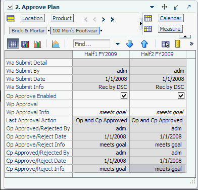

A success message is displayed. Click OK to close it.
The view refreshes and the approval or rejection information is populated in the measures, as shown in Figure 6-7.
