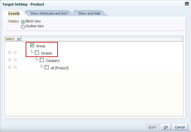

To show or hide levels and select the display type using the Dimension dialog box, complete the following steps:
In the page edge, click the dimension tile you want. The Dimension dialog box appears.
Click the Levels tab. The Levels tab shows all the levels and alternate roll-ups and enables you to select one or more levels within a single dimension.
Select the levels you want to show or hide using the check boxes to the left of the level name.
Select Block View or Outline View as the display type.
Click OK to apply the changes and close the dialog box.
Or, click Apply to apply the changes and continue working on the other tabs.

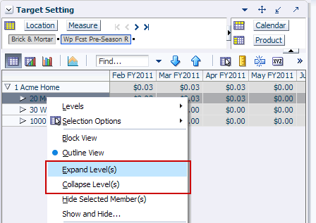

Although you can click the Expand/Collapse buttons next to each level displayed in the view, it can be time consuming if there are many levels. The Fusion Client includes the following options to help you expand or collapse levels easily:
Right-click menu
Levels Tab in the Dimension pop-up
To expand or collapse levels using the right-click menu:
Select the levels you want to expand or collapse, and right-click.
On the right-click menu, select Expand Level(s) or Collapse Level(s).
To expand or collapse levels using the Dimension dialog box:
In the page edge, click the dimension tile of the dimension you want to collapse or expand. The Dimension dialog box appears.
On the Levels tab, select the relevant check box to expand or collapse all the positions at the level. To expand or collapse all positions at all the visible levels, click the Expand/Collapse shortcut menu on the top.
Note: The expand and collapse check boxes are enabled only for the levels selected. |
Click OK to apply the changes and go back to the view.
You can also click Apply to apply the changes and continue working on the other tabs.

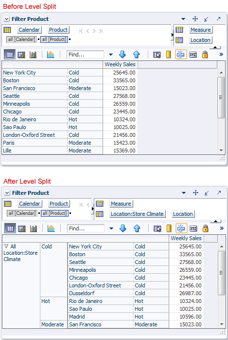

Level splitting allows you to group dimension data based on position characteristics defined by attribute values.This enables users working with large sets of data to group together subsets of data to make the information easier to work with. These attributes can be either predefined (set up during the configuration process) or dynamic (defined by a user and made available globally).
For example, for an attribute that describes the climate of a store location, you can group those store locations by climate using a level split. This lets a planner working on the winter season to first work with stores in cold weather regions and then work with stores in more temperate regions.
Level splitting is applied to the entire workbook, although when the split was defined it may have been specified that the split should only be shown in some of the views in the workbook. As each dimension in the workbook can only have one split applied to it at any one time, applying a split to a view without any apparent grouping may still result in a message saying that a split already exists. Users then have the option of continuing with the existing split or clearing it and applying the new split to the entire workbook.
As shown in Figure 6-6, the attribute values (cold, moderate, hot) act as positions within the level split. Each level split contains only the positions that have that attribute: only the cold locations appear in the cold split, only the hot locations appear in the hot split, and so on.
The level split has its own dimension tile. You can move this tile just as you would a dimension tile because level splits behave like independent dimensions. See Creating a New Split for more information.
Behind the scenes, a hierarchy is built based on attribute values at the level that is split, allowing the aggregations to be correctly calculated and providing a spreading for values edited at aggregated levels. Other capabilities, such as locking and protection processing, are fully functional on the positions of the split.

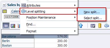

Click the Level Splitting icon in the toolbar. In the Level Splitting menu, select New Split.
Or, right-click a position. The right-click context menu appears. Select Level Splitting. In the Level Splitting menu, select New Split.

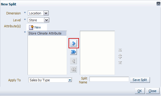

The New Split dialog box appears (Figure 6-9). Select the following options:
Dimension: Select the dimension that you want to split.
Level: Select the level that you want to split into groups.
Attributes: Check the attribute that you want to use to group the levels into and use the Move icon to move it to the right side. More than one attribute can be selected.
If multiple attributes are selected for a split, the order they are selected will determine the order they are applied. The first attribute in the list will be used to group the dimension into bands. The second attribute in the list will then be used to subdivide within the initial bands, and so on. The order can be modified by using the up or down arrows in the New split dialog box.
If you want to create a new attribute, use the New Attribute icon.
Apply To: Select the views that the split should apply to. You can choose one view, some views, or all views.
Split Name: To save the split for later use, enter a name and click Save Split.

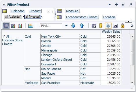

When finished, click OK. The dialog box closes, and the levels are split, as shown in Figure 6-10.

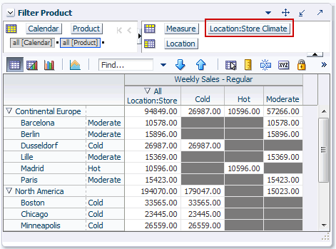

You can move the split dimension to a different axis, as shown in Figure 6-11. Moving the split dimension to a different axis can be helpful when you have aggregate levels of the base dimension. In Figure 6-11, the base dimension is Location. When aggregating that dimension, you can see the total Weekly Sales for regions by climate.
You can also move the split dimension to the page edge, as shown in Figure 6-12.

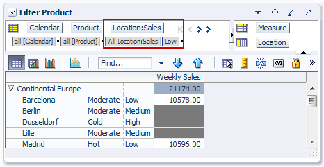

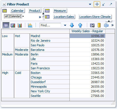

You can use more than one attribute to define a split for a dimension. In Figure 6-13, two attributes were used to define the split.
Climate (Hot, Moderate, Cold)
Sales (Low, Medium, High)
These are used in the priority order used to select them when the split was defined. Because Climate was the first attribute selected, the stores are first grouped by the climate bands. Within a specific climate band, the stores are then grouped by sales. These splits can be moved to different axes or the page edge.

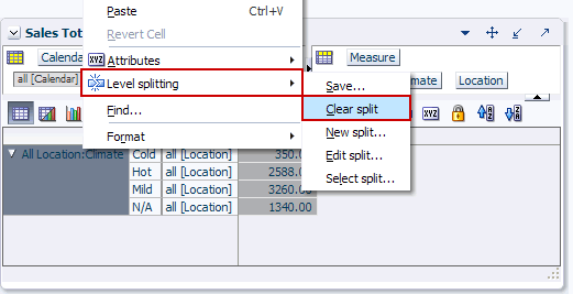

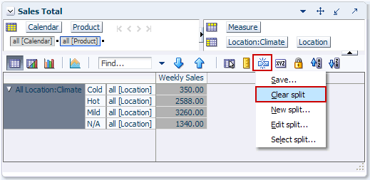

To clear or remove a split from the view, complete the following steps:
Click the Level Splitting icon in the toolbar. Then select Clear Split.
Or, right-click a position. In the right-click context menu, select Level Splitting. Then, select Clear Split.
The split is removed from the view.

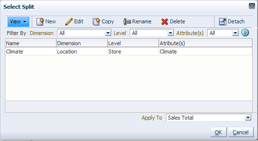

To apply a saved split to a view, complete the following steps:
Click the Level Split icon in the toolbar and then click Select Split.
Or, right-click a position. In the right-click context menu, select Level Splitting and then Select Split.
The Select Split dialog box appears. Select the split you want to apply to the view.
Click OK. The split is applied to the view.
If no existing split exists for the dimension the split is being applied to, the split will be immediately applied.
If an existing split exists for the dimension the split is being applied to, a warning dialog box will appear.
As only one split can be applied to a specific dimension at one time, users have the option of continuing with the existing split or removing it and applying the new one.

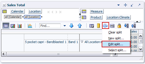

To edit an existing split, complete the following steps:
Ensure that a split appears in the view.
Right-click the level split or click the Level Split icon.
From the Level Split menu, select Edit Split.
The Edit Split dialog box appears.
Edit the split as necessary and click OK.
Note: A split cannot be edited if it is in use in a worksheet. To edit the split, first clear the split from the workbook. |

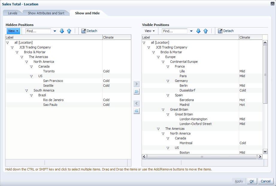

Positions that appear in the view are based on the configuration. Only positions configured for a view are visible in the view. In the Fusion Client, you can show or hide the positions using the Dimension dialog box.
To show or hide positions:
In the Page Edge and Tiles area, click the dimension tile you want. The Dimension dialog box appears.
In the Dimension dialog box, click the Show and Hide tab.
Select the positions you want by holding down the CTRL or SHIFT key.
Click the Add and Remove arrows to move positions between the Visible Positions and Hidden Positions areas.
Or
Drag and drop the positions between these areas.
Use the Add All and Remove All arrows to move all the positions between the Visible Positions and Hidden Positions area.
