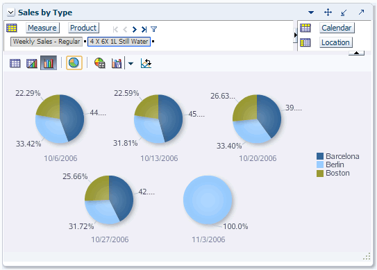

12 Working With Charts
You can use the charting feature to generate a visual representation of the data in the form of charts. This section describes the available chart types and provides instructions on the various tasks you can perform with charts. It includes the following sections:

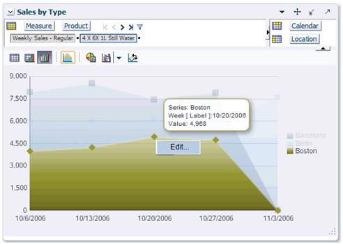

After the chart appears on screen, you can update the value of a specific series.
Editing Data Without the Drilling Operation Enabled
If no drilling operations have been carried out, data can be edited simply by clicking the series in the chart. To edit a chart:
  1. In the chart, select the value for the specific series represented in the chart using the following steps:
    1. Mouse over the series or the legend. The specific series is highlighted automatically, and the other series are dimmed. See Figure 12-8.
      Figure 12-8 Example of a Series Highlighted in Area Chart
      Surrounding text describes Figure 12-8 .
      This is a configurable setting and can be toggled on or off in the properties file. For more information, refer to the Oracle Retail Predictive Application Server Administration Guide for the Fusion Client.

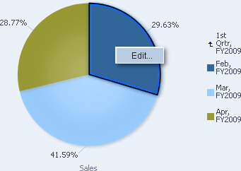

    2. After the series is highlighted, locate the value you want to edit on the chart and select the relevant area based on the following:

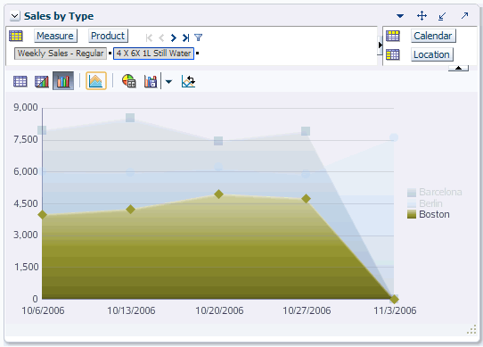

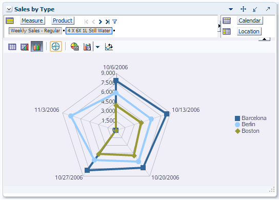

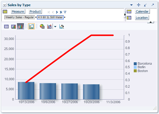

      Chart Type Area to Select
      Area Chart Right-click on the specific point and select Edit... in the context menu. The point is indicated by a tool tip pop-up when you point at it.
      Bar Chart Right-click the bar area and select Edit...
      Bubble Chart Right-click the bubble. and select Edit...
      Column Chart Right-click the column area and select Edit...
      Combination Chart Right-click on the relevant area based on chart type. Refer to the area for Area, Column, and Line Charts.
      Line Chart Right-click the specific point on the line and select Edit... (indicated by line marker).
      Pareto Chart Right-click on the column or the pareto line marker and select Edit...
      Pie Chart Right-click the slice and select Edit...
      Radar Chart Right-click the line marker point and select Edit...
      Ring Chart Right-click the slice and select Edit...
      Scatter Chart Right-click on the scatter marker (shape) and select Edit...
      Treemap Chart Right-click the node and select Edit...
      Figure 12-9 Example of Value to be Selected in the Area Chart
      Surrounding text describes Figure 12-9 .
    The Chart Editor window appears.

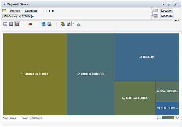

  • Continuous allows one color to be used in different shades for a node. The color shades transition from a minimum to a maximum value.

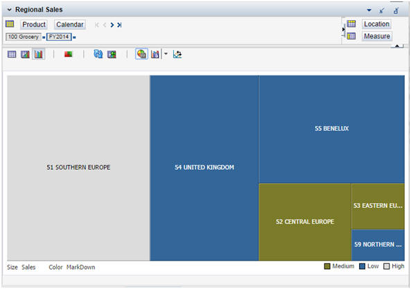

  • Grouped allows specific colors to be assigned to defined groups.

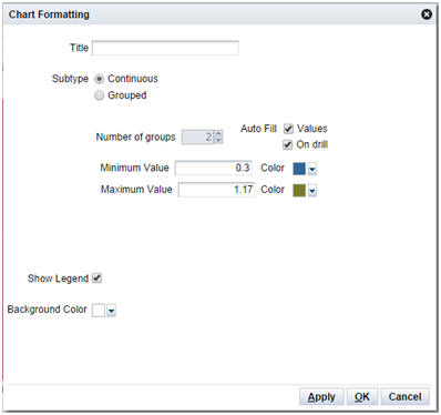

Continuous Subtype
When you select the continuous subtype, you must manage the options for Auto Fill, Minimum Value, Maximum Value, and Color. The Number of groups value is disabled here as it only applies to the grouped subtype. See Treemap Chart Formatting Window.
Table 12-7 Continuous Subtype Options
Option Description
Auto Fill
Select this check box if you want Values or On drill to be auto-calculated. These two options are both selected by default.
Values. Select this option if you want the minimum and maximum values to be auto-calculated based on the chart data. The minimum value is set to the lowest chart data value, and the maximum value is set to the highest chart data value. You can override these auto-calculated values by entering a number for either value yourself. In this case, the Value check box becomes de-selected.
On drill. Select this option so that after drilling down, the minimum and maximum values are re-calculated based on the new highest and lowest values instead of on the existing parent-level values. You may not need the On drill option when the data that drives color is aggregated as average, mean, median, or percent. This option is more relevant when color data aggregates as total, min, max, and so on.
Minimum Value/Maximum Value
Define the starting and ending values for the color transition. Treemap chart nodes that have values less than or equal to the minimum are shaded with the color associated with the minimum value, and nodes with values greater than or equal to the maximum are shaded with that associated color. Nodes with values in between are reflected by color shades according to their specific values. These values are auto-calculated if you select the Auto Fill check box.
Color
Associates a specific color with the minimum value and a specific color with the maximum value. The default values are selected from the chart color series.
Grouped Subtype
When you select the grouped subtype, you must manage the options for Number of groups, Auto Fill, Labels, Range cut-off values, and Color.
Figure 12-18 Grouped Subtype Option
Surrounding text describes Figure 12-18 .
Table 12-8 Grouped Subtype Options
Option Description
Number of groups
Defines the number of discrete groups that the nodes are grouped into. Each group is associated with a label. range cut-off value, and color. The default is 2.
Auto Fill
Values. Select this option if you want the range of cutoff values to be auto-calculated based on Number of groups and chart data. You can override these auto-calculated values by entering a range cutoff value yourself. In this case, the Value check box becomes de-selected.
On drill. Select this option so that after drilling down, you want the range cutoff values to be proportional. The new cutoffs are based on the new color data and proportioned using the parent-level cutoffs. You may not need the On drill option when the data that drives color is aggregated as average, mean, median, or percent. This option is more relevant when color data aggregates as total, min, max, and so on.
Label
The name for each group. The default names are Group 1 and Group 2. You can change these names as appropriate. If you add a group (by changing the value in Number of groups), the new group will initially be assigned a default name, regardless of any changes you may have made.
Range cut-off value
Defines the cut-off value for the range associated with the group. All the nodes that have a color data value greater than the lower cutoff and lower than or equal to the upper cutoff are shaded with the associated color.
Color
Defines the color associated with each group. A node is assigned a color based on the range into which the value falls. The default color is assigned to each group using the chart color series.

Area Chart
In a Area chart, the data is represented as a filled-in area. An area chart can be used to show trends over time, such as sales for the past 12 months. Area charts require at least two groups of data along an axis.
Area charts are available in the following types:
  • Absolute Area Chart – Each area marker connects two data values. This type of chart has the following variations:
    • Absolute Area Chart with a Single Y-Axis
      Figure 12-22 Absolute Area Chart with a Single Y-Axis
      Surrounding text describes Figure 12-22 .

Pareto Chart
In a Pareto Chart, the data is represented by bars and a percentage line that indicates the cumulative percentage of bars. Bars are arranged by value from left to right, from the largest to the lowest. A Pareto Chart is always a Dual Y-Axis chart. The first Y-Axis corresponds to values that the bars represent and the second Y-Axis runs from 0-100 percent and represents the cumulative percentage values.
Figure 12-45 Pareto Chart
Surrounding text describes Figure 12-45 .

In a Pie Chart, the data is represented as sections of a circle. Pie charts can be used to show the relationship of parts to a whole.
Figure 12-46 Pie Chart
Surrounding text describes Figure 12-46 .

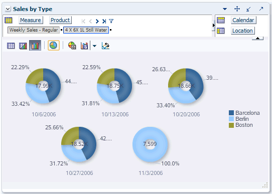

Ring Charts are similar to the Pie Chart, except that the center of each circle displays the total pie value.
Figure 12-47 Ring Chart
Surrounding text describes Figure 12-47 .
Radar Chart
In a Radar Chart, the data is represented in a polygon layout. Radar Charts are used to show patterns that occur in cycles, such as monthly sales for last three years.
The data structure of a Radar Chart is:
  • Number of sides on the polygon is equal to the number of groups of data. Each corner of the polygon represents a group.
  • A series or set of data is represented by a line, markers of the same color, or both (labeled by legend text).
Figure 12-48 Radar Chart
Surrounding text describes Figure 12-48 .

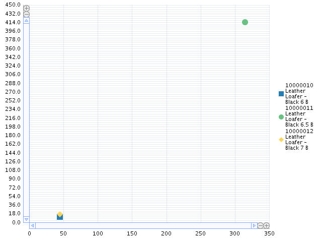

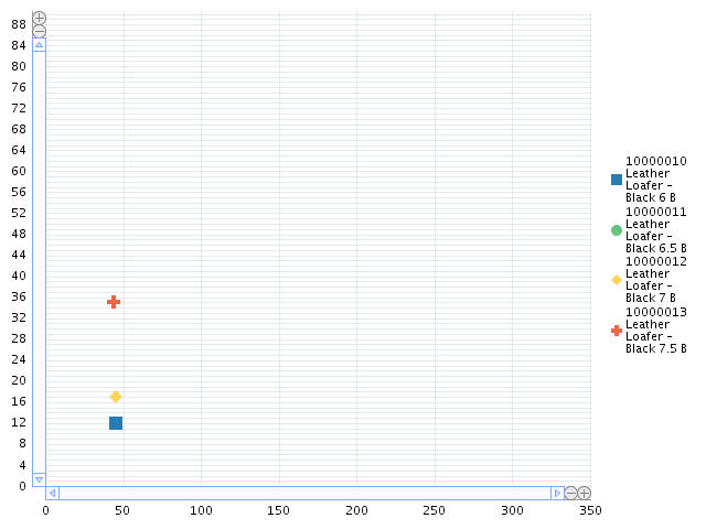

In a Scatter Chart, the data is represented by the location of data markers. Scatter Charts can be used to show the correlation between two different kinds of data values.
Scatter Charts are available in the following types:
  • Scatter Chart with a Single Y-Axis
    Figure 12-49 Scatter Chart with a Single Y-Axis
    Surrounding text describes Figure 12-49 .
  • Scatter Chart with a Dual Y-Axis
    Figure 12-50 Scatter Chart with a Dual Y-Axis
    Surrounding text describes Figure 12-50 .

In a Treemap chart, the data is represented by the size and color of the rectangular area markers (nodes). A Treemap chart shows correlations between two types of data values and is used to examine relative performance between a number of data items.
The first data value determines the area size. A zero or negative value will be ignored and no node will be shown on the chart. The second data value determines the area color. You can reverse this via the Flip size/color option that is available on the right-click context menu. Selecting it refreshes the chart so that it displays the new orientation of the data.
For example, a Treemap chart can be used to show the correlation between yearly sales vs. average percent markdown for different regions. The sales data for each region determines the node size, and the average percent markdown determines its color. See Figure 12-51.
Treemap charts are available in the following types:
  • Treemap chart with continuous colors. The node colors in this Treemap chart transition between a range of shades between two colors. The color shade is determined based on the node data value that determines color.
    You can pick the two colors on the chart formatting dialog. See Understanding the Treemap Chart Formatting Window.
    Figure 12-51 Treemap Chart with Continuous Colors
    Surrounding text describes Figure 12-51 .
  • Treemap chart with grouped colors. The nodes in this Treemap chart use discrete colors based on the pre-defined range that the node data value falls into. Each range is associated with a group label and a color.
    You can define the groups with a start value and a cutoff value with the chart formatting dialog. See Grouped Subtype.
    Figure 12-52 Treemap Chart with Grouped Colors
    Surrounding text describes Figure 12-52 .

Figure 12-53 Drill Down Example Before
Surrounding text describes Figure 12-53 .
Figure 12-53 shows the data for the 1st Quarter segment of the pie chart at a monthly level.
Figure 12-54 Drill Down Example After
Surrounding text describes Figure 12-54 .

Editing Data Values
In both normal and drilled chart view, data can be edited by right clicking in the chart area and opening the Right Click menu.
Figure 12-59 Editing Data - Right-Click Menu
Surrounding text describes Figure 12-59 .
If you select the Edit option, a pop-up window opens that you can use to edit the data.
Figure 12-60 Pop-Up Menu for Editing Data
Surrounding text describes Figure 12-60 .

Zooming
If you are having difficulty examining the data points in a chart because they are clustered together, you can use the zoom functionality to increase the distance between the data points. This is illustrated in Figure 12-62 and Figure 12-63.
This can be done in two ways.
  • Reducing the size of the scroll bar
  • Zooming in or out using the zoom menu located in the left bottom corner of the chart panel
Figure 12-62 Before Zooming
Surrounding text describes Figure 12-62 .
Figure 12-63 After Zooming
Surrounding text describes Figure 12-63 .
