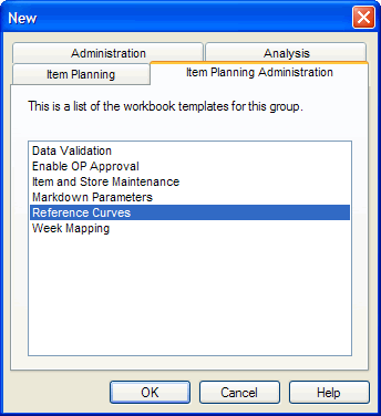

Click the New icon in the toolbar.
The New Workbook dialog box appears. On the Item Planning Administration tab, select Reference Curves and click OK.

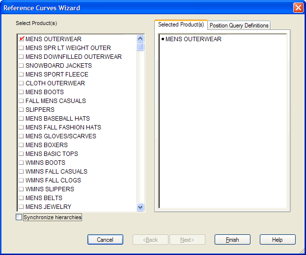

The Reference Curves Wizard appears at the Select Products step. Select the products you want to create curves for and click Finish.
The Reference Curves workbook is built and opens at the Maintain Curve Profiles Worksheet.

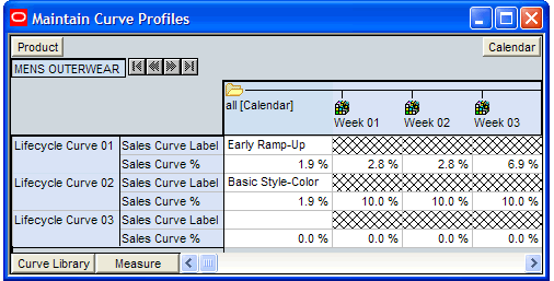

The Reference Curves workbook has one worksheet, Maintain Curve Profiles. Use this worksheet to create sales curves to be used in the Item Planning workbook. These curve profiles are based on a percent-to-total sales. Regardless of weeks in the curve, the curves can shrink or stretch to fit the defined regular and promotional sales period.
Perform the following steps to create curve profiles.
Ensure that all[Calendar] is shown in the Calendar hierarchy.
In the intersection of the Sales Curve Label measure and the all[Calendar] dimension, enter the label of the curve profile. This label is displayed in the Item Planning workbook.
Starting in Week 01, enter the percent-to-total sales percentage in the weeks of the curve profile. The number of defined weeks is up to you.
Note: You must start the curve in Week 01 for the curve to be able to shrink or stretch to fit the defined regular and promotional sales period. |
Click Calculate. The all[Calendar] percentage is calculated based on the percentages in the defined weeks.
Repeat steps 1 through 4 for additional curve profiles.
When finished, save and commit the workbook.

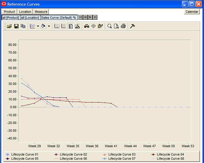

Use the graph view to see how the curves look over the sales period (Figure 3-4).
