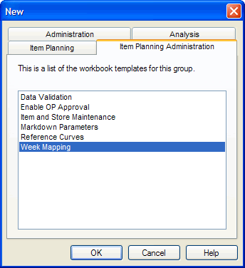

Click the New icon in the toolbar.
The New Workbook dialog box appears. On the Item Planning Administration tab, select Week Mapping and click OK.

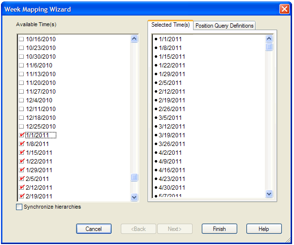

The Week Mapping wizard appears at the calendar step. Select the weeks you want to map and click Finish.
The workbook is built.

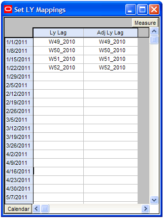

This tab contains a single worksheet called Set LY Mappings.
After you have mapped the weeks, build the Reference Curves workbook to create reference curves.
