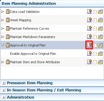

  1. Click the New Workbook icon in the Approval to Original Plan task.
    Figure 10-1 Approval to Original Plan Validation

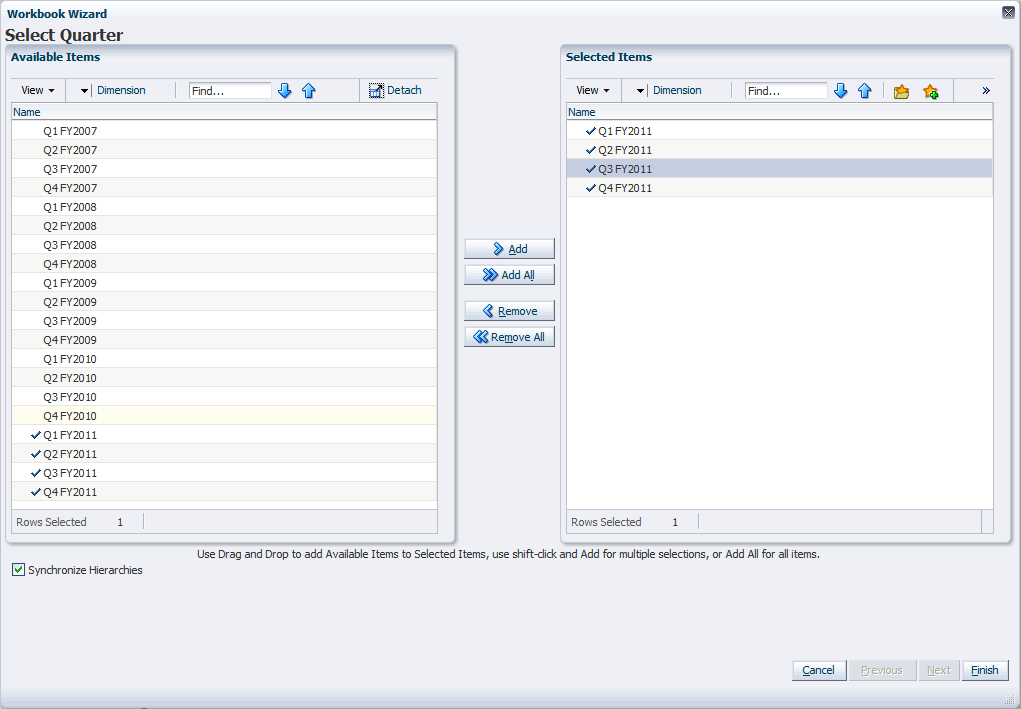

  2. The workbook wizard opens at the Calendar Selection step. Select the quarter you want to enable and click Finish.
    Figure 10-2 Approval to Original Plan Workbook Wizard - Calendar Selection

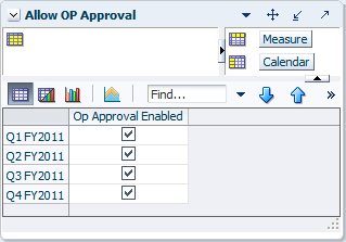

Allow Op Approval
The Allow Op Approval step has one view: Allow OP Approval. Select the quarters that you want to enable users to approve plans to the original plan.
Figure 10-3 Allow OP Approval View
The following table lists the measures available on this view.
Table 10-1 Allow Op Approval View Measures
Measure Description
Op Approval Enabled
Select this measure to enable users to approve plans to the original plan for the quarter.
