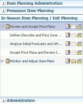

Use the Review and Accept Price Plans task during in-season planning to create a new price plan using COE forecasts and what-if calls. This price plan can then be seeded into the associated Wp measures in the Monitor and Adjust Item Plans task.
The Review and Accept Price Plans Task has three steps:
This task and steps are shown in Figure 8-1.

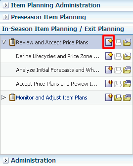

  1. Click the Create New Workbook icon in the Review and Accept Price Plans task.
    Figure 8-2 Create New Workbook Icon

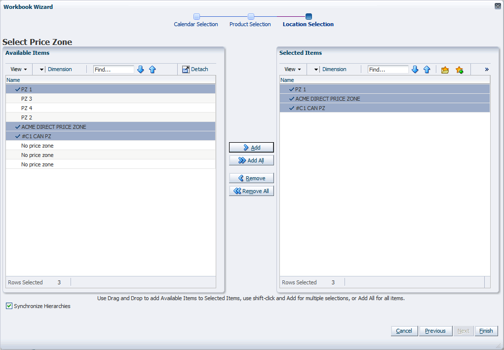

  4. The Prize Zone Selection step of the workbook wizard appears. Select the prize zones you want to plan and move them to the Selected Items box. Click Finish.
    Figure 8-5 Workbook Wizard: Prize Zone Selection
The Review and Accept Price Plans workbook is built.

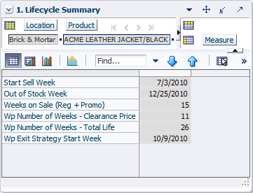

Lifecycle Summary View
Use this view to review the lifecycle of the style/color that was set up in the Develop and Approve Item Plans task. This view is read-only.
Figure 8-6 Lifecycle Summary View
Table 8-1 Lifecyle Summary View Measures
Measure Description
Start Sell Week
The first week the style/color is sold.
Out of Stock Week
The planned week that the style/color is out of stock.
Weeks on Sale (Reg + Promo)
The combined number of weeks the style/color is on sale at the regular and promotional price.
Wp Number of Weeks - Clearance Price
The number of weeks that the style/color is on sale at clearance price.
Wp Number of Weeks - Total Life
The total number of weeks of the style/color's entire lifecycle. This is the sum of the regular, promotional, and clearance weeks.
Wp Exit Strategy Start Week
The first week that the style/color inventory and sales are moved from regular to clearance.
After you have reviewed the lifecycle, continue to the Spread to Price Zone View.

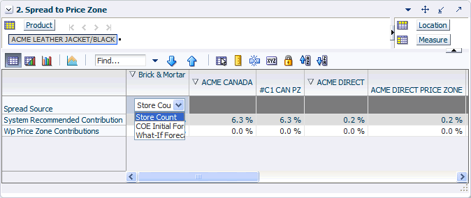

Use this view to spread the item plan's sales from the channel level to the price zone level. This is done by choosing a spread method and setting the price zone contribution.
Figure 8-7 Spread to Price Zone View
To set the spread method, perform the following steps:
  1. In the Spread Source measure, select a spread method. There are three options:
    • Store Count: Spreads the sales according to the number of stores in each price zone.
    • COE Initial Forecast: Spreads by the initial forecast sales units that the COE engine creates. These forecasts, which are at the price zone level, are sent in a batch process from COE.
    • What If Forecast: Spreads according to the COE forecast that you revise in the What If Request View.
  2. Click Calculate. The data in the System Recommended Contribution measure is updated to reflect the relevant recommendations for the spread method.
  3. In the Wp Price Zone Contributions measure, enter the spread percentages for each price zone. Use the data in the System Recommended Contribution measure as a guideline. The percentages you enter are used to spread the channel level plan down to the price zone level.
Table 8-2 Spread to Price Zone View Measures
Measure Description
Spread Source
Select the spread method to use. Options are Store Count, COE Initial Forecast, and What If forecast.
The system recommended contribution for the spread method. Use this data as a guideline.
Enter the spread percentages for each prize zone. The sales are spread to the price zones according to these percentages.
When finished, continue to the Analyze Initial Forecasts and What-if Forecasts Step.

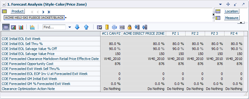

Forecast Analysis (Style-Color/Price Zone) View
Use this view to review the COE initial forecast and the what-if forecasts you create in this step. Use the three measure profiles provided in this view to review this high level information:
  • Initial Forecast: Displays the initial forecast from the COE engine. This forecast is generated automatically by the Clearance Optimization Engine based on the actual sell through, compared to the target sell through and exit dates. This forecast is loaded into IP COE in the batch process. This is the default measure profile (shown in Table 8-3).
  • What-If Forecast: Displays the forecast you create in the What If Request View. The what-if forecast is the COE response to your what-if request, based on your markdown cadence.
  • Initial and What-If Forecast: Displays both the COE initial forecast and the what-if forecast.
After you have reviewed the forecast data, continue to the What If Request View to create and review what-if forecasts.
Figure 8-8 Forecast Analysis (Style-Color/Price Zone) View - Initial Forecast Measure Profile
Table 8-3 lists the measures in this view.
Table 8-3 Forecast Analysis (Style-Color/Price Zone) View Measures
Measure Description
COE Initial EOL Exit Week
The Exit Date COE uses to calculate the Recommended Clearance Markdown. This measure is a single hierarchy selection that displays the week ending date of the exit week.
COE Initial EOL Sell Thru %
The Recommended Sell Thru % used by COE to determine the optimal Recommended Clearance Markdown Price Plan that achieves the desired Sell Thru %.
COE Initial EOL Salvage Value % Off
The percent off the Current Ticketed Retail Price that is used to determine the Salvage Value Price for any remaining inventory at the Exit Date.
COE Initial EOL Salvage Value Price
The Salvage Value Price applied to any remaining inventory at the end of the Exit Date.
COE Forecasted Clearance Markdown Retail Price Effective Date
The Effective week of the COE Recommended Clearance Markdown Ticketed Retail Price.
COE Forecasted Opportunity Cost
The dollar amount you can generate in profit by taking the recommended markdowns.
COE Forecasted Exit Week Sell Thru %
The Forecasted week that the Targeted Sell Thru % is achieved.
COE Forecasted EOL EOP Inv U at Forecasted Exit Week
The Forecasted EOP Inv Units in the Forecasted Exit Week.
COE Forecasted GM Initial Exit Week
The cumulative Forecasted Gross Margin value at the Forecasted Exit Week. This is calculated for each time period based on the COE Recommended Clearance Markdown Retail Price and the Product Cost Price.
COE Forecasted GM Forecasted Exit Week
The cumulative Forecasted Gross Margin Value at the Forecasted Exit Week (Date) expressed as a percentage of the COE Forecasted Sales Retail Value and the Product Cost Price.
COE Forecasted GM % Forecasted Exit Week
The cumulative Forecasted Gross Margin Percentage at the Forecasted Exit Week (Date) expressed as a percentage of the COE Forecasted Sales Retail Value.
Clearance Optimization Action Note
Notation for the type of Clearance Optimization What-If action that has been initiated.

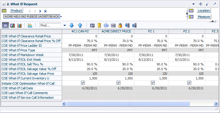

Use this view to create different what-if calls by trying different combinations of clearance prices, price ladders, markdown weeks, and so on.
Price ladders, which define a set of markdown prices, are created within the Clearance Optimization Engine (COE) application.
Because price ladders are created in COE, you can only select a price ladder to use within Item Planning. To edit it, you must return to COE.
For more information about the creation of price ladders, see the "Price Ladders Standard Interface" section and the "Price Ladders Standard Interface Specification" table in Chapter 2 of the Oracle Retail Clearance Optimization Engine Operations Guide.
Figure 8-9 What If Request View
To create a what if forecast, perform the following steps:
  1. In the COE What-If Price Ladder ID measure, select the price ladder to apply to the style/color. These price ladders were created in COE.
  2. Upon a calc, the COE What-If Price Type measure will auto-update to the correct type based on the Ladder ID, depending on if the Ladder ID is a percent-off ("Percent Off") or a Price Point ("PPT").
  3. Enter the remaining what-if data.
  4. In the Initiate COE Optimization What-If Call measure, select the check box.
  5. Click the What-If Markdown Call button in the upper right corner.
    Figure 8-10 What-If Markdown Call Button

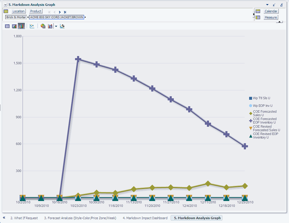

To see the what-if forecast at the week level, continue to the Forecast Analysis (Style-Color/Price Zone/Week) View. To see the forecast at the style-color/price zone level, return to the Forecast Analysis (Style-Color/Price Zone) View.

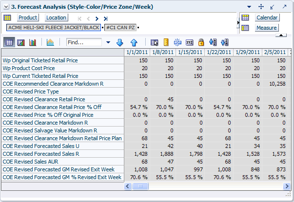

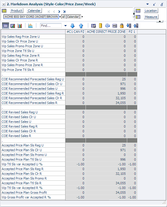

Use this view to review a detailed view of the initial forecast and the what-if forecast you created in the What If Request View. Use the three measure profiles provided in this view to review this information:
  • Initial Forecast: Displays the initial forecast from the COE engine. This forecast is loaded into IP COE in the batch process. This is the default measure profile.
  • What-If Forecast: Displays the forecast you create in the What If Request View (shown in Table 8-5).
Figure 8-11 Forecast Analysis (Style-Color/Price Zone/Week) View - What-If Forecast Measure Profile
Table 8-5 Forecast Analysis (Style-Color/Price Zone/Week) View - What-If Forecast Measure Profile Measures
Measure Description
Wp Original Ticketed Retail Price
The Original Ticketed Retail Price at the time when the product was first set-up in the Item Master files.
Wp Product Cost Price
The Cost Price of the product.
Wp Current Ticketed Retail Price
The Current Ticketed Retail Price for the product at the end of the last period / beginning of the current time period.
The COE Optimized Recommended Clearance Markdown Ticketed Retail Price.
COE Revised Price Type
Text measure that contains the price type value returned from the COE service call.
COE Revised Clearance Retail Price
Revised Clearance Price validated against the COE Price Ladders and used during the What-If COE Optimization Service Call.
COE Revised Clearance Retail Price % Off
Revised Clearance Price percent off the Current Ticketed Retail Price.
COE Revised Price % Off
Original Price Measure that holds the value returned by the COE service call.
COE Revised Clearance Markdown R
The extended Retail Value of the COE Clearance Markdown based on the COE Revised Clearance Markdown Price and the Beginning of Period Inventory Units in the effective week of the Clearance Markdown.
COE Revised Salvage Value Markdown R
The extended Retail Value of the Salvage Markdown.
COE Revised Clearance Markdown Retail Price Plan
The COE Optimized Revised Clearance Markdown Ticketed Retail Price Plan following a What-If COE Optimization Service Call.
COE Revised Forecasted Sales U
Units in unelapsed time periods combined with Actual Sales Units in elapsed time periods.

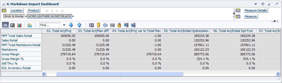

Markdown Impact Dashboard View
Use this view to review the markdown budget created in the Merchandise Financial Planning (MFP) application. This budget is at the subclass level. The key performance indicators of the budget are provided to help you understand the total budget for the subclass and to enable you to compare it to the price plan you create in this task.
Use the measure details to compare the actual plan to the working plan, initial forecast, and revised forecast.
Figure 8-12 Markdown Impact Dashboard View
Table 8-6 and Table 8-7 describe the measures in this view.

Markdown Analysis Graph View
Use this view to see the forecast analysis in the graph view. If you are not satisfied with the results, return to the What If Request View to adjust the what-if call.
Figure 8-13 Markdown Analysis Graph View
After you have created a what-if forecast you are satisfied with, continue to the Accept Price Plans and Review Impact Step.

Begin with the Markdown Analysis (Style-Color/Price Zone/Week) View.
Use this view to review all of the recommendations for each price zone. The purpose of this view is to compare the different recommendations and choose which one you want to use with each price zone in the Price Plan Acceptance View.
Figure 8-14 Markdown Analysis (Style-Color/Price Zone/Week) View

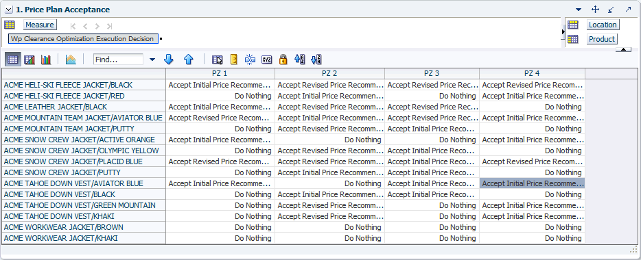

Use this view to select the recommendation for each price zone. You can select different recommendations for each price zone.
Figure 8-15 Price Plan Acceptance View
To assign recommendations to a price zone, perform the following steps:
  1. Review the different recommendations for each price zone in the Markdown Analysis (Style-Color/Price Zone/Week) View and decide which recommendation you want to use for each price zone.
  2. In this view, select recommendation you decide to use. There are three options:
    • Do Nothing: Uses the Wp sales spread from the channel plan as the price plan in this price zone.
    • Accept Initial Price Recommendation: Uses the unaltered recommendations from COE that were loaded through the batch process.
    • Accept Revised Price Recommendation: Uses the recommendation that you created in the What If Request View.
  3. After you have selected a recommendation for each price zone, select the Accept Price Plan button in the upper right corner.
    Figure 8-16 Accept Price Plan Button
    A success message appears, confirming that the recommendation has been assigned to the price zone.
Based on the decision for each price zone, the accepted price plan for each channel is computed by aggregating the corresponding sales measures.
