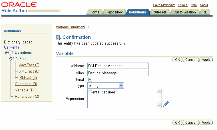

In this section, you use Rule Author to add a variable that replaces a portion of the message that you print out in the Java How-To you built in Chapter 2. In Oracle Business Rules, a variable is similar to a public static variable in Java. You can specify that a variable is a constant or modifiable.
Perform the following steps to add a variable:
Click the Repository tab and load the CarRental dictionary.
Click the Definitions tab.
In the navigation tree, click the Variable node. The Variable Summary page shows a table with a row that includes the text, (No items found), this indicates no variables are defined.
Click Create. This shows the Variable page.
In the Name field, enter DeclineMessage.
In the Alias field, enter Decline Message.
Select the Final check box (by default this box is selected).
In the Type box, select String.
In the Expression box, enter "Rental declined ".
To use the Wizard to assist you with creating an expression, click the edit icon to display the Wizard.
Click Apply. Rule Author shows a confirmation message (see Figure 3-1).
When Rule Author creates a variable, it adds a "DM." to the name you enter in the Name field (DM stands for Data Model).Figure 3-1 Rule Author Variable Definition Page

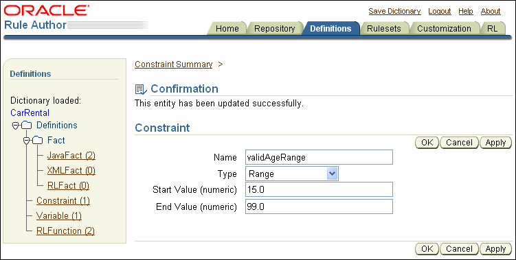

Perform the following steps to define a range constraint:
In the navigation tree, click the Constraint node. The Constraint Summary page shows a table that indicates that no constraints are defined.
Click Create. This shows the Constraint page.
In the Name field, enter validAgeRange.
From the Type list, select Range. This updates the Constraint page display to show two new fields: Start Value and End Value.
Enter 15 in the Start Value field.
Enter 99 in the End Value field.
Click Apply. Rule Author shows a confirmation message (see Figure 3-2).
Figure 3-2 Rule Author Constraint Definition Page

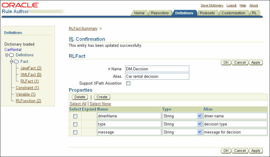

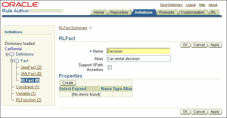

Click the Definitions tab. In the navigation tree under Facts, click the RLFact node. This displays the RLFact Summary page that shows that no RLFacts are defined.
Click Create. This shows the RLFact page.
Enter Decision in the Name field.
Enter Car rental decision in the Alias field. See Figure 3-3.
Figure 3-3 Rule Author Definitions Tab with RLFact Page
In the properties table click Create. This shows a new row in the Properties table.
Enter driverName in the Name field.
Select String from the box in the Type field.
Enter driver name in the Alias field.
Click Create. This adds another new row to the Properties table.
Enter type in the Name field.
Enter decision type in the Alias field.
Enter message in the Name field.
Enter message for decision in the Alias field.
Click Apply. Rule Author displays a confirmation message (see Figure 3-4).
Figure 3-4 Rule Author Definitions Tab with RLFact Properties
Click RLFact in the navigation tree. This displays the RLFact Summary page, and the new RLFact, DM.Decision.
When Rule Author creates an RLFact, it adds a "DM." to the name you enter in the Name field (the DM stands for Data Model).See Also:

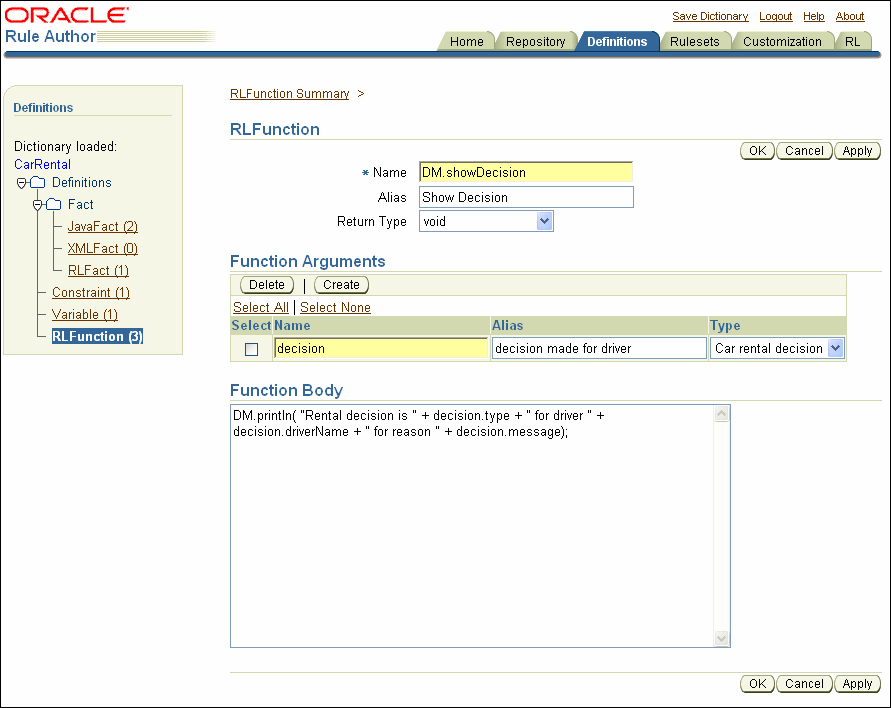

Select the Definitions tab.
In the navigation tree, select RLFunction. This shows the RLFunction Summary page.
Click Create.
Enter showDecision in the Name field.
Enter Show Decision in the Alias field.
If you are defining a function in Rule Author, you must specify a valid alias in the Alias field, even though the actual function name (not the alias) must be used in the function body.Select void in the box in the Return Type field (this is the default value).
Click Create in the Function Arguments table.
Enter decision in the Name field.
Enter Decision made for driver in the Alias field.
Select Car rental decision, the alias for the Decision RLFact, in the box in the Type field.
In the Function Body box, enter the following:
DM.println( "Rental decision is " + decision.type + " for driver " + decision.driverName + " for reason " + decision.message);
Click Apply. This shows a confirmation message.
In the left navigation pane, click the RLFunction node. You should see the RL function DM.showDecision in the summary table.
Click Edit to view the function (see Figure 3-5).
After creating the new RLFact Decision as specified in Section 3.3 and the new RLFunction DM.showDecision, you can update the UnderAge rule to provide an action that creates a new Decision fact. To use the Decision fact with the showDecision function, you must create a new rule that checks for Decision facts and provides an action, using the showDecision function, to show the results.

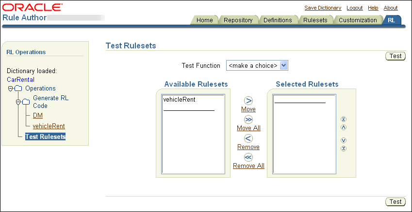

Use the Rule Author RL tab to view the RL Language text that represents the data model and the rule sets associated with the dictionary data.
To generate, view, and check the RL Language text, do the following:
Click the Repository tab and load a dictionary. For example, load the CarRental dictionary.
Select the RL tab.
Select the rule set of interest in the navigation tree.
Click Generate RL. This shows you the RL Language text for the specified rule set.
Click Check RL Syntax to validate the RL Language text.

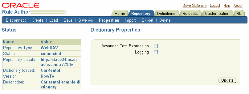

To configure dictionary properties, perform the following steps:
Make sure you are connected to a repository and a dictionary is loaded.
Click the Repository tab.
Click the Properties secondary tab (see Figure 3-6).
Figure 3-6 Rule Author Dictionary Properties Page
Rule Author stores dictionary properties per user. If you change your preferences, and then log out, and then log in as a different user, your dictionary properties reflect the properties for the newly logged in user.If Rule Author does not use authentication, which is possible if the user configures web.xml to disable security, then this also disables saving user level dictionary properties.

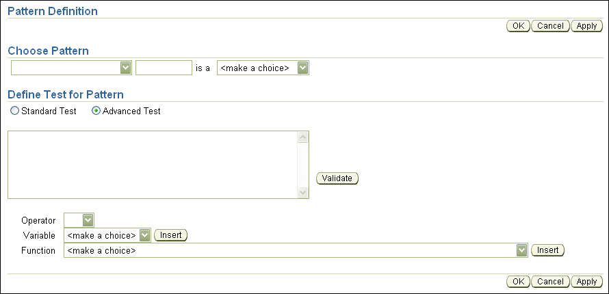

The Advanced Test Expression check box changes the Rule Author expression mode to advanced for test expressions that are displayed when you edit a pattern for a rule (see Figure 3-7). Tests in a the condition of a rule can involve mathematical operations and conjunctions. Rule Author includes the advanced expression mode to support defining such complex expressions.
When a pattern is first created, its test expression mode depends on the Advanced Test Expression property set on the Properties page. When you select the Advanced Test Expression check box, the advanced test expression mode is applied to all new patterns. This setting persists when the dictionary is saved. In this case, when the dictionary is loaded, all patterns are created with Advanced Test Expression mode. After a pattern is created, with or without a test, it is permanently associated with the test expression mode. Thus, the test expression mode associated with a pattern cannot be changed.
In a single rule, you can use patterns created with both basic expression mode and advanced expression mode.
Figure 3-7 Pattern Definition Advanced Test Expression Page

Log Level: Error, the lowest log level generates the least amount of output. Status is the medium log level. Trace is the highest log level, generating the most output.
Use the Log Directory box to specify the directory for the log. Specifying the log directory in the Log Directory box is optional (if the directory is not specified, the log is displayed on the console).
When the Log file name is specified, the log is saved in a file with the name <log_file_name>.<last_8_session_id>. For example, if you specified RALog as the name of your log file, and the last eight digits of your session ID are 11223344, the file RALog.11223344 would be created. If no log file is specified, the log is saved in a file named RuleAuthor.<last_8_session_id>.
Click Update when you are finished specifying your logging options.

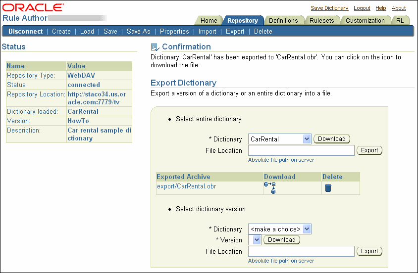

To export an entire dictionary:
Click the Export secondary tab.
In the "Select entire dictionary" section:
In the Dictionary field, select the dictionary you want to export.
In the File Location field, specify the location and filename (absolute file path on the server) to which you want to export the dictionary.
Click Export.
You can also select the dictionary and click Download, which creates a link to the exported archive on the Export Dictionary page. You can then click the link and use your browser to download the archive to a location of your choice (see Figure 3-8).
Figure 3-8 Rule Author Export Dictionary Page

Create a test function, as follows:
Click the RLFunction node in the navigation tree.
Enter test in the Name and Alias Fields.
Leave void as the return type.
Enter the following in the Function Body field:
java.text.SimpleDateFormat sdf =
new java.text.SimpleDateFormat( "MM/dd/yyyy" );
assert (new carrental.Driver( "d111", "Dave", 50, "sports", "full",
sdf.parse ("10/1/1969"), 0, 1, true ));
assert (new carrental.Driver( "d222", "Abe", 15, "truck", "provisional",
sdf.parse ("8/1/2004"), 0, 0, true ));
assert (new carrental.Driver( "d333", "Lance", 44, "motorcycle", "full",
sdf.parse ("6/1/2004"), 0, 1, true ));
pushRuleset ("vehicleRent");
run();
This function asserts several facts, pushes the vehicleRent rule set onto the rule set stack, and calls run().
All rule sets you want to have executed must be pushed onto the stack. They are not automatically pushed simply by selecting them.To enable logging, you can call the watchFacts() or the watchActivations() functions.
Click OK. This saves the RLfunction named DM.test.
Save the dictionary.

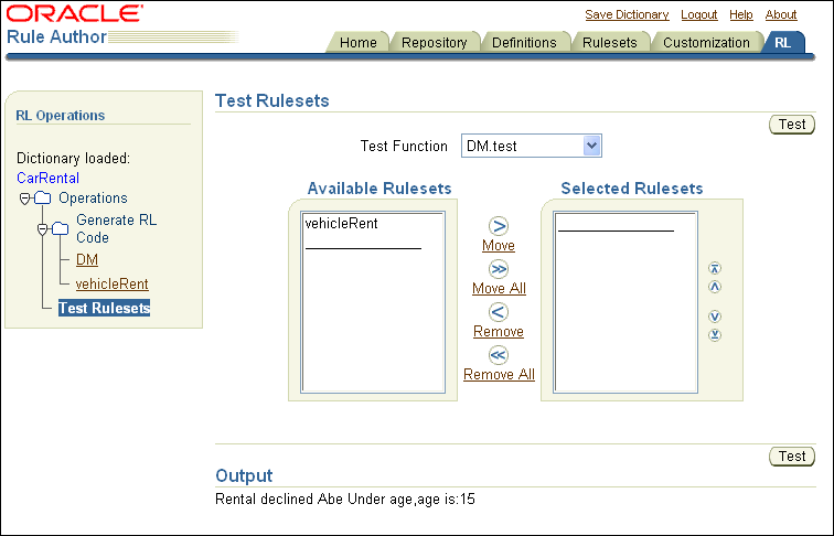

Click the RL tab.
In the navigation tree, click the Test Rulesets node. This displays the Test Rulesets page.
Figure 3-9 Rule Author Test Rulesets Page
You can see the vehicleRent rule set is available. This rule set was created in Chapter 2.
Select the vehicleRent rule set and move it to the Selected Rulesets column.
Select the DM.test function from the Test Function list.
Click Test.
This generates RL Language code for the selected rule set(s), which is then inserted into a Rule Session. Then, the selected test function is called. Output from the function is printed on the screen (see Figure 3-10).
Figure 3-10 Rule Author Test Rulesets Page with Output
