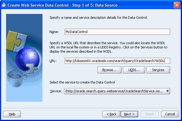

  7. Enter a name for the data control.
  8. Enter a Web Services Description Language (WSDL) URL. The WSDL URL for Oracle Secure Enterprise Search is of the form:
    http://host:port/search/query/OracleSearch?WSDL
    When Oracle Secure Enterprise Search is installed, the endpoint listed in the WSDL points to a placeholder location. Once the data control is created, you must correct the endpoint URL using the Structure pane. This step will be described later in this procedure.
  9. Click Services. The wizard page should now look similar to Figure 8-1.

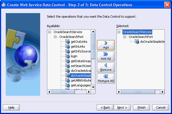

  11. From the Data Control Operations page, you choose which methods you want to expose by moving them from the Available list to the Selected list. For the purposes of this example, move doOracleSimpleSearch to the Selected list. When you are done, the page should look similar to Figure 8-2.
    Figure 8-2 Data Control Operations Page of Web Service Data Control Wizard
    Description of Figure 8-2 follows
    Description of "Figure 8-2 Data Control Operations Page of Web Service Data Control Wizard"
  12. For the purposes of this example, you can now click Finish. If you want to review the other pages of the wizard first, then click Next until you reach the end of the wizard and then click Finish.

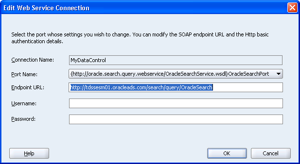

  15. Right-click your data control in the Structure pane and choose Edt Web Service Connection from the context menu.
  16. The Edit Web Service Connection dialog appears as shown in Figure 8-3. As noted earlier, the endpoint listed in the WSDL points to a placeholder location. You must now correct the endpoint URL.
    Figure 8-3 Edit Web Service Connection Dialog
    Description of Figure 8-3 follows
    Description of "Figure 8-3 Edit Web Service Connection Dialog"
  17. Click OK.

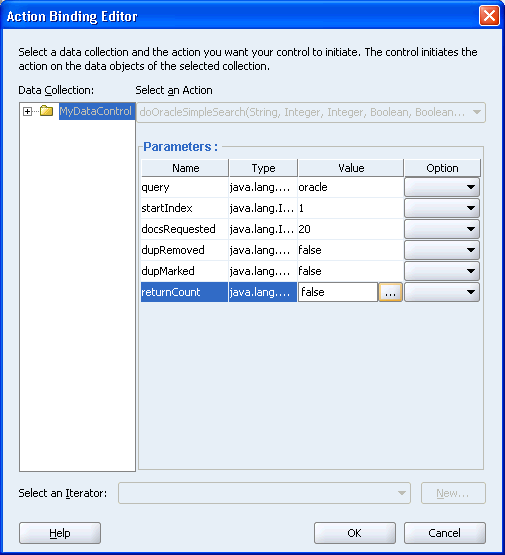

  27. For the sake of simplicity, you can hard code the values for each parameter as shown in Table 8-1.

  28. When you are done, the dialog should look like Figure 8-4. Click OK.

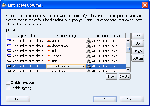

  30. The Edit Table Columns dialog appears. Select lastModified and click Delete (Figure 8-5).
    Figure 8-5 Edit Table Columns Dialog
    Description of Figure 8-5 follows
    Description of "Figure 8-5 Edit Table Columns Dialog"
  31. Click OK.

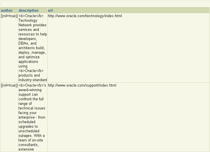

  35. Browse through your output and notice how occurrences of the word oracle are surrounded by <b></b> tags. Figure 8-6 shows a small sample fragment of this output. Currently, the search hits are not formatted because you have not yet converted the view component that renders this column to OutputFormatted.
    Figure 8-6 Sample of Searched Output, Hits Unformatted
    Description of Figure 8-6 follows
    Description of "Figure 8-6 Sample of Searched Output, Hits Unformatted"

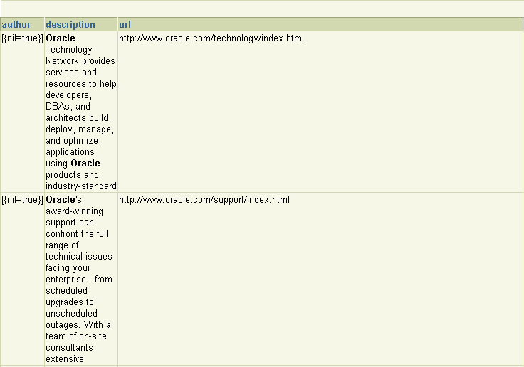

  41. Run the page again to see the changes. You should now see output similar to that in Figure 8-7. Notice how the <b></b> around the word oracle is now interpreted so that search hits appear in bold.
    Figure 8-7 Sample of Searched Output, Hits Formatted
    Description of Figure 8-7 follows
    Description of "Figure 8-7 Sample of Searched Output, Hits Formatted"
