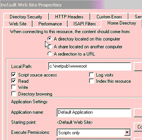

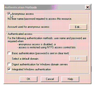

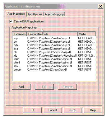

The Web Server Environmental Binding configuration procedures vary depending on the type of Web Server SSM you are configuring. AquaLogic Enterprise Security supports two Web server SSMs that require configuration of the Web Server Environmental Binding: the Microsoft IIS Web Server SSM and the Apache Web Server SSM. For configuration instructions, see the appropriate topic below:
To configure the environmental binding for Microsoft IIS Web Server, perform the following tasks:
Note: | This task assumes you have created an instance of the IIS Web Server SSM. |
The IIS Web Server Binding plug-in file is named wles_isapi.dll
. This file is located in the BEA_HOME
\ales30-ssm\iis-ssm\lib
directory.
To configure the Microsoft IIS Web Binding plug-in, perform the following steps:
wles_isapi.dll
file (which is located in BEA_HOME
directory), and click OK. Read
and Read/Execute
permissions on the following directories:BEA_HOME
\ales30-ssm\iis-ssm\libBEA_HOME
\ales30-ssm\iis-ssm\instance\iisssmdemo\sslBEA_HOME
\ales30-ssm\iis-ssm\instance\iisssmdemo\config
NamePasswordForm.acc
file in a virtual directory, repeat the previous step for the virtual directory as well.wles_isapi.dll
file to the Executable field, fill in the other fields as shown in Figure 5-5, and click OK.wles_isapi.dll
file again and start the IIS Web Server.Note: | Be sure to start the IIS Web server with IIS SSM after you have started the Web Service SSM and ARME. |
