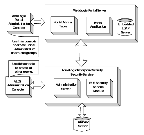

ALES does not replace all of the management functionality provided by the Portal Administration Tools. For example, as shown in Figure 6-1, WebLogic Portal administrative tools are used to manage administrative users and resources associated with Portal Delegated Administration and Portal Content Management.
