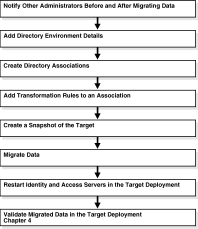

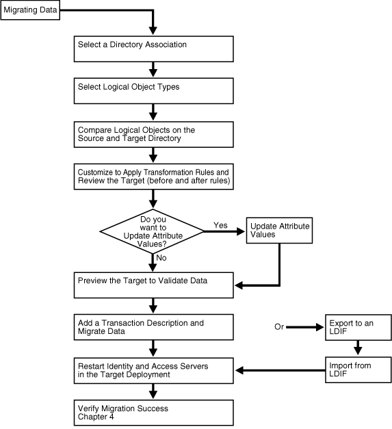

Figure 3-1 provides an overview of the procedures involved in preparing for and migrating data using Oracle Access Manager Configuration Manager. Additional information follows the figure.
Figure 3-1 Preparing for and Migrating Data Using Configuration Manager
Task overview: Migrating data includes
Notifying Other Administrators: Recommended both before and after any data migration.
Adding Environment Details to the Configuration Manager: Required before you can form an association.
Creating a Directory Association: Required before migration.
Adding and Managing Optional Transformation Rules: Optional and applied automatically during migration.
Creating a Snapshot: Recommended before any data migration.
Restarting Servers After Migration: Required after data migration.
Validating Migration Success: Recommended to ensure that everything in the target deployment works as expected, and described in Chapter 4.

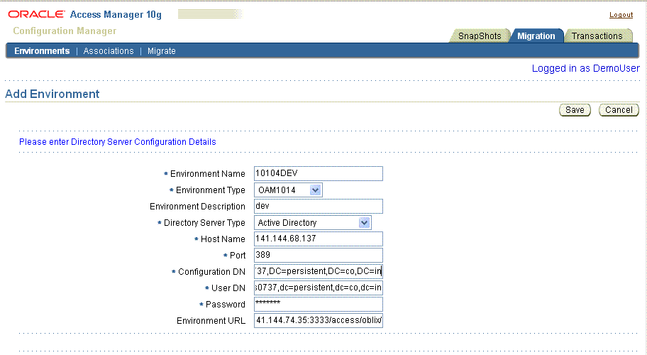

The procedure in this topic explains how to add environment details to the Configuration Manager. Any individual with HMUser privileges can add environment details. The repository for Oracle Access Manager Configuration Manager must be online. Oracle recommends that the environment (LDAP directory) also be online.
After adding details for at least two LDAP directory environments, you can form an association that specifies a source and target for data migration.Failover and Load Balancing: Oracle Access Manager Configuration Manager does not support directory failover or load balancing. For each existing deployment, the Configuration Manager writes to only a single master LDAP directory and reads from only a single master or replica server.
Replicated Environments: In a replicated directory environment, you must add details for only the master directory (the one on which write operations take place) as the target environment. Otherwise the objects that you select for migration cannot be written into the target and migration will fail. After migrating configuration data to the master LDAP directory you must ensure that the changes have fully propagated to the replicas before restarting Identity Servers and Access Servers.
When you click the Create New button from the Environment List page, the Add Environment page appears. A filled in sample is shown in Figure 3-2. Your environment will differ.
Lists are provided from which you can select the environment type (OAM 1014 or COREid704) and directory type. In this example, the environment type is OAM1014.
The Add Environment page provides fields where you can enter other information, including Environment Name, optional Description, Host Name and Port, Configuration DN, User DN, Password, and the URL for the LDAP Directory environment. When defining an environment name and description, you can use any combination of uppercase and lowercase alphanumeric characters, as well as spaces and punctuation.
If the environment is SSL-enabled, be sure to specify that on the Add environment page. For more information, see the following procedure.

On the Add Environment page, provide the information for this specific directory server using the guidelines in this procedure overview. For example:
Environment Name: Enter a unique and descriptive name for this directory server. You might want to include details about the environment, hostname, port, or other identifying characteristics. For example:
10104DEV
Environment Type: Select the type of environment for which this directory server is installed (either release (10g (10.1.4.0.1) or release 7.0.4).
OAM1014
Environment Description: Enter a brief optional statement that further identifies this directory and its environment. For example:
dev
Directory Type: Select the type of directory server from those listed. For example:
Active Directory
Host Name: Enter the complete DNS hostname (DNS_hostname.domain.com) or IP Address of the computer where this directory is installed. For example:
141.144.68.137
Port: Enter the port number on which this directory server communicates.
389
Configuration DN: Enter the configuration DN for Oracle Access Manager 10g (10.1.4.0.1), or Oracle COREid Release 7.0.4, data. For example:
OU=oblix,OU=company1,DC=obps0737,DC=persistent,DC=co,DC=in
The configuration DN must start from theoblix node.User DN: Enter the directory administrator ID for this environment (LDAP directory). For example:
cn=administrator,cn=users,dc=obps0737,dc=persistent,dc=co,dc=in
Password: Enter the directory administrator password: For example:
Your_password
Environment URL: The URL to the LDAP directory. For example:
http://141.144.74.35:3333/access/oblix/
For more information, see "Viewing Environment Details in the Configuration Manager".
Enable SSL: If Secure Sockets layer (SSL) is enabled for this directory, click Enable SSL at the bottom of the page, then load a certificate for this directory using the following steps. For example:
Check the box beside Enable SSL.
Click the add Certificate link (beside the Enable SSL check box) to display the Upload Certificate dialog box then fill in requested details. For example:
Take one of the following actions:
Certificate Upload Successful: You are returned to the page where you started. In this case, proceed to Step 5.
Certificate Upload Not Successful: An error message appears to help you solve the problem. In this case, click the Cancel button on the error window, verify the location of the files and password, and complete the certificate steps again.
Click Save when you have finished filling in the details for this directory server.

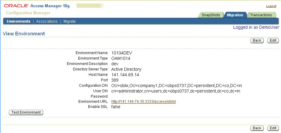

The procedure in this topic explains how you view environment details that were added to the Configuration Manager. This activity can be performed by any individual with HMUser privileges.
The Environments List page appears as shown in Figure 3-3 when you click the Migrate tab, then click the Environments secondary tab. If there are no go to "Adding Environment Details to the Configuration Manager".
When you click a name in the Environment Name column, the View Environment page appears as shown in Figure 3-4. Details about this page follow the figure.
The View Environment page includes the following types of information:
Environment Name: The unique name that was entered when details about this directory server were added to the Configuration Manager (10104DEV, for example).
Environment Type: The release for which this directory server is installed (OAM1014, for example).
Environment Description: An optional statement that further identifies this directory and its deployment (dev, for example).
Directory Type: The supported directory server type (Active Directory in this example).
Host Name: The DNS hostname of the computer where this directory is installed (the full IP address, in this example).
Port: The port number on which this directory server communicates (389 in this example).
Configuration DN: The bind DN for configuration data for the specified environment (in this example, it is OU=oblix,OU=company1,DC=obps0737,DC=persistent,DC=co,DC=in).
The configuration DN is similar to the searchbase for user data. The configuration DN must be specified to identify the node in the DIT under which the Oracle Access Manager schema and configuration data are stored. For more information about its use and location within Oracle Access Manager 10g (10.1.4.0.1), or Oracle COREid Release 7.0.4, deployments, see the corresponding Installation Guide as described in "Related Documents".
User DN: The administrator ID, also known as a bind DN or root DN, for the for the specified environment (in this example it is cn=administrator,cn=users,dc=obps0737,dc=persistent,dc=co,dc=in)
This directory account should have Read, Write, Add, Delete, Search, Compare, and Self-write permissions. The method to create a user with these privileges varies among directory vendors. See your directory documentation for details. For more information about its use and location within Oracle Access Manager 10g (10.1.4.0.1), or Oracle COREid Release 7.0.4, deployments see the corresponding Installation Guide as described in "Related Documents".
Password: The User DN directory administrator password.

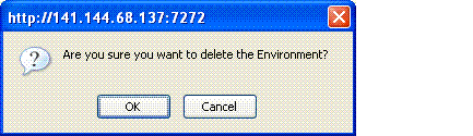

From Oracle Access Manager Configuration Manager, click the Migration tab, then click Manage Environments. For example:
Migration, Environments
Click the option beside the desired Environment Name, then click the Delete button. For example:
Delete
A message asks you to verify this is what you want to do before the operation is performed, as shown here.
Verify the removal by clicking OK in the message window (or Cancel to terminate the operation without completing it).
OK
On the Manage Environments page, review the informational message to validate that the operation was successful and confirm that the environment details are no longer listed.
The environment must be live and online during snapshot, migration, and transaction operations. Any individual with HMUser privileges can test an environment connection.
If there is any problem with the connection, notify the directory administrator.
To ensure the environment is live and online
From Oracle Access Manager Configuration Manager click the Migration tab, then click Environments:
Click the desired name in the Environment Name column to view details. For example:
On the View Environment page, click the Test Environment button.
Test Environment
Read the informational message to ensure that the environment connection is successful.

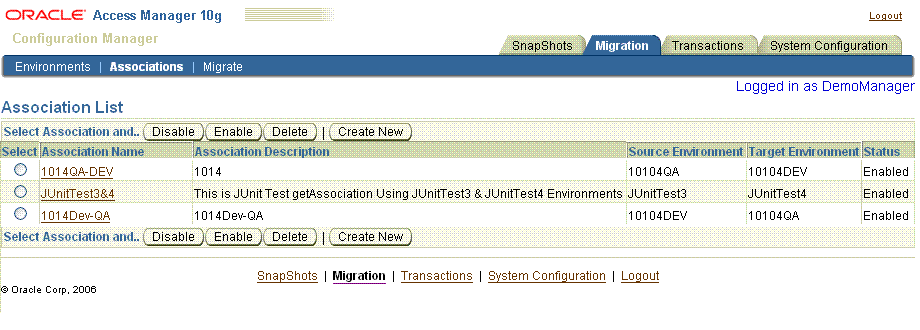

When you click the Associations secondary tab under the Migrate tab, the Association List page appears. A sample is shown in Figure 3-5. The table is empty when no associations exist in the Configuration Manager.
The Association List page provides several function buttons: Disable, Enable, Delete, Create New. Starting with the left-most column in the table, the Select column provides an option beside each name in the Association Name column. You click the option in the Select column that corresponds to the name of the association that you want to enable, disable, or delete.
The Association Name column provides a link that you can click to view details of that association. The Association Description column provides an optional description that was entered when this association was added. The Source Environment column and Target Environment column provide the names of the source and target LDAP directories that comprise the named association. The Status column identifies whether the association is enabled or disabled.
The following list provides more information about the information within each column:
Association Name: The unique name entered to identify this associated directory pair.
Association Description: A brief optional statement entered for this association.
Source Environment: The name of the source environment (the LDAP directory that contains the data that you will migrate).
Target Environment: The name of the target environment (the LDAP directory to which data will be migrated).
Status: Enabled or Disabled. Each association is enabled automatically when created.

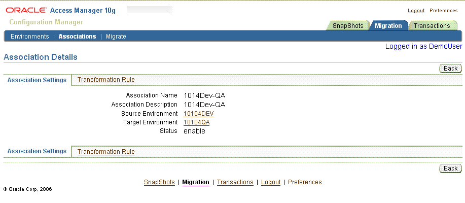

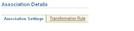

When you click an asociation name in the table, the Association Details page appears as shown in Figure 3-6. You find the same information for a single association on both the Association Details page and in the table on the Association List page. The Association Details page includes a sub tab that you can use to add a transformation rule as described in "Adding and Managing Optional Transformation Rules".
From Oracle Access Manager Configuration Manager, click the Migration tab, then click Association:
Migration, Associations
On the Association List page, click a name in the Association Name column. For example:
On the Association Details page, view the settings for this directory pair.
Click the Back button to return to the Association List page.

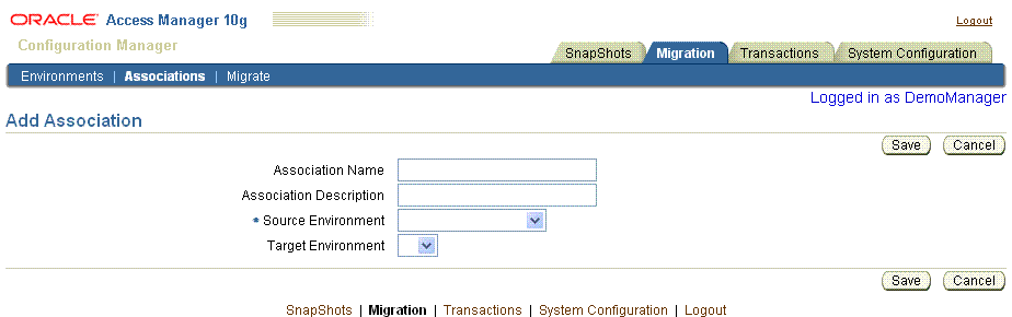

Data migration requires a directory association that specifies the migration path between a source and target environment. Any individual with HMUser privileges can create an association. The repository for Oracle Access Manager Configuration Manager must be online. Oracle recommends that the environment (LDAP directory) also be online.
When you click the Associations secondary tab under the Migration tab, the Association List page appears. You click the Create New button to display the Add Association page, which is shown in Figure 3-7.
When you enter an association name and optional description, you can use any combination of upper and lower case alpha/numeric characters, as well as spaces and punctuation. Lists are provided from which you can select the source and target environments from those that have been defined in the Configuration Manager.
After you select a source environment, a list of possible target environments is established based on the release of your chosen source. For example, if the selected source environment is release 7.0.4, the Target Environment list is populated only with other release 7.0.4 environments defined in the Configuration Manager. The association is enabled automatically when you create it.
If the environment that you want is not listed, you might need to add it. For more information, see "Adding Environment Details to the Configuration Manager".
Once an association is created, you cannot modify the details. You can remove an association, as described in "Deleting a Directory Association".From Oracle Access Manager Configuration Manager, click the Migration tab, then the Associations:
On the Association List page, click the Create New button:
Create New
On the Add Association page, enter the following details to identify the source and target directories in this associated pair. For example:
Association Name: Enter a unique name that identifies this associated directory pair at a glance. For example:
1014Dev-QA
Association Description: Enter a brief optional statement that further identifies this associated pair. For example:
Password Policy
Source Environment: Select the name of the desired source directory from the list of existing environments. For example:
10104DEV
Target Environment: Select the name of the desired target directory from those listed. For example:
10104QA
Click Save to create the association (otherwise, click Cancel to terminate the operation).
Save
The Associations List page appears. The association is enabled for use automatically.

This topic explains how to delete a directory association. Any individual with HMUser privileges can delete an association. The repository for Oracle Access Manager Configuration Manager, and the associated LDAP directories, must be online.
Oracle recommends that you disable the association before deleting it. When you delete an association, all migration transactions related to this association are also removed. However, snapshots for a deleted association remain until you explicitly delete the snapshots.
You cannot delete an environment that is part of an association. You must first delete the association and then delete the environment.During the delete operation, you are asked to confirm that this is the action you want to take. When the association is deleted, you are returned to the Association List page where an informational message notifies you that the removal was a success.
From Oracle Access Manager Configuration Manager, click the Migration tab, then click Associations:
On the Association List page Select column, select the option beside the desired association name then click the Delete button. For example:
Delete
A message asks you to verify that this is what you want to do, as shown here.
Verify your intent to remove the association by clicking OK (or click Cancel to terminate the operation without completing it).
OK
On the Association List, review the informational message that confirms that the item was deleted.

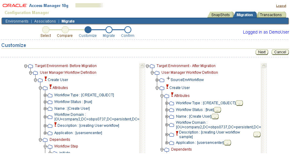

After migration, you can change attribute values as follows:
On the Rollback Transaction, Customize page. For more information, see "Rolling Back Changes Made During a Specific Transaction".

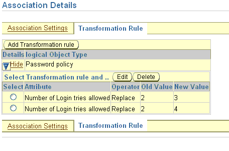

You use the procedure in this topic to view an existing transformation rule for a directory association. Any individual with HMUser privileges can perform this task. The repository for Oracle Access Manager Configuration Manager and the associated LDAP directories must be online while you perform these tasks.
When you click the Associations secondary tab under the Migrate tab, the Association List page appears. After selecting a name in the Association Name column to display the Association Details page, you click the Transformation Rules subtab. Details about existing transformation rules for the association appear in a table as shown in Figure 3-8. Initially, the Transformation Rule table displays only the logical object types on the target for which a transformation rule exists. If no rule exists, a message states "No Transformation Rules were found".
Figure 3-8 Transformation Rules Page and Table
You click the Show arrow beside the desired logical object type to expand details. Figure 3-9 shows the types of details outlined for the transformation rule, which include Attribute, Operator, Old Value, and New Value. The Edit, Delete, and Add Transformation Rule buttons are also available.
Figure 3-9 Rule Details with Edit, Delete, and Add Transformation Rule Buttons

The Association Details page appears.

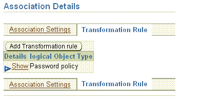

On the Association Details page, click the Transformation Rule subtab. For example:
Click the Show arrow beside the desired logical object type to display the corresponding rules and attributes. For example:

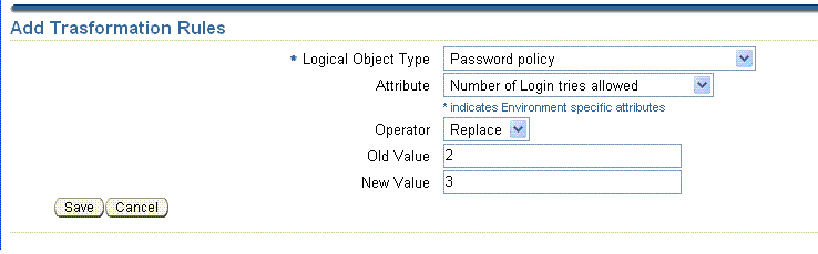

You use the procedure in this topic to add an optional transformation rule for a directory association that will automatically change an attribute value on the target during data migration. Any individual with HMUser privileges can perform this task. The repository for Oracle Access Manager Configuration Manager and the associated LDAP directories must be online while you perform these tasks.
You start this operation much the same as you would when viewing a transformation rule. For example, you select an existing association name and then click the Transformation Rule subtab. If the desired association is not listed, ensure that it was formed as described in "Creating a Directory Association".
From the Transformation Rule subtab, you click the Add Transformation Rule button. On the Add Transformation Rule page, lists are initially empty and fields are blank. The available attributes depend on the logical object type you select. The available operators depend upon the attribute you select. In the Attribute list, system-specific attributes are shown with an asterisk, *.
You select a logical object type and a related attribute to which the rule will be applied. You then select an operator. To finish, you enter the old parameter value and a new parameter value as described in the following procedure. A completed transformation rule will look like the example in Figure 3-10.
To add a transformation rule to a directory association
From Oracle Access Manager Configuration Manager, click the Migration tab, then click Associations. For example:
In the Association Name column, click the desired name. For example:
Click the Transformation Rules subtab. For example:
The Transformation Rules page appears with the Add Transformation Rule button. Included is a table of logical object types for which rules are defined within this association. The table is empty if no rules are defined for this association.
Click the Add Transformation Rule button to display the page where you can create a new rule.
The Add Transformation Rules page provides lists from which you select specific elements of the rule and a field where you enter a specific parameter for this rule.
On the Add Transformation Rules page, select from the lists to define this rule. For example:
Logical Object Type: Select the appropriate logical object type from the list. For example:
Password Policy
Attribute: Select the desired attribute from the list, which varies depending upon the selected logical object type. For example:
Number of Login Tries Allowed
Operator: Select the appropriate operator for this attribute and rule. For example:
Replace
Old Value: Enter the old value of the parameter. For example:
2
New Value: Enter the new value of the parameter. For example:
3
Click the Save button to complete the operation (or Cancel to terminate without saving this rule).
Save
The Association Details page appears with a message announcing that your transformation rule has been saved.

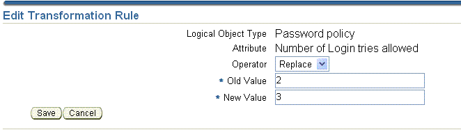

You use the procedure here to edit an existing transformation rule for an association. For example, you can use this procedure to make a correction using the page shown in Figure 3-11.
Figure 3-11 Edit Transformation Rule Page
This procedure is similar to creating a transformation rule. However when you edit a rule, the Logical Object Type and Attribute are fixed and cannot be changed. Only the operator list, and the old and new value fields are active and can be used to modify current information.
Click the Transformation Rules subtab to display the Transformation Rules page. For example:
The Transformation Rules page organizes logical object types for which rules have been created in a table.
Click the Show arrow beside the desired logical object type to display details about this rule. For example:
Show
Select the attribute option to edit. For example:
Click the Edit button to display the page where you can modify this rule.
Edit
Modify the details for this transformation rule using the guidelines in "Adding an Optional Transformation Rule".
Click Save to retain this change (or Cancel to terminate the operation).
Save

The Association Details page appears containing both the current Association Settings and the Transformation Rules subtab.
On the Association Details page, click the Transformation Rules subtab.
Click the Show arrow to display the desired rule. For example:
Show
On the Transformation Rules page, select the option beside the desired attribute to delete. For example:
Click the Delete button to remove this rule. For example:
Delete
A message asks you to verify this operation.
Verify by clicking OK in the message window (or click Cancel to terminate the operation without completing it). For example:
OK
Review the informational message and confirm that the item no longer appears in the rules table.
Repeat as needed to remove other rules.
Proceed to the following sections before migrating data:

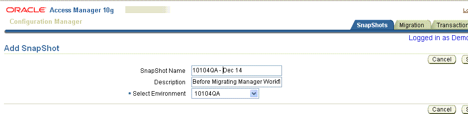

When naming a snapshot or adding a description, you can use any combination of upper and lower case alpha/numeric characters, as well as spaces and punctuation. You then select an environment from the Select Environment list. A completed Add SnapShot page is shown in Figure 3-13.
When you click the Save button, the snapshot is created. When the process completes, an informational message confirms that the operation was successful. The new snapshot name and details appear in the table on the SnapShot List page. You cannot view the actual content of a snapshot.

Click the Create New button to display the Add Snapshot page.
Create New
Fill in the Add SnapShot page with information appropriate to your environment, as follows:
SnapShot Name: Enter a unique name that will identify this specific snapshot in the list. For example:
10104QA - Dec 14
Description: Enter an optional description to further distinguish this from other snapshots in the list. For example:
Before migrating Manager Workflow
Select Environment: From the list, select the specific directory for which you want to capture a snapshot. For example:
10104QA
Select Save to assign this information and create the snapshot (otherwise select Cancel to terminate the operation without creating the snapshot).
Save
When the operation completes, you are returned to the Snapshot List page where you should see a message confirming that the Snapshot was saved.
Check the message and the table to confirm that the snapshot is available for possible restoration later.

Topics here include migration overviews that explain the migration process and all activities you will perform. Following the overviews is a step-by-step procedure to guide you. Any individual with HMUser privileges can perform this task. The repository for Oracle Access Manager Configuration Manager and the associated LDAP directories must be online during all migration activities.
Oracle recommends that you schedule a migration window and notify administrators before migrating data. For more information, see "Notifying Other Administrators".Figure 3-14 illustrates the migration process and tasks that you will perform using the Configuration Manager. Additional details follow the figure.
The following task overview presumes that you have completed all prerequisite tasks in Table 3-8.
Task overview: Migrating data after selecting the Migration tab, and Migrate subtab
You select a directory association to specify the migration path: This is required and described in "About Selecting an Association".
You select logical object (logical object types) to migrate: This is required and is introduced in "About Selecting Logical Objects to Migrate".
You compare the logical objects that you selected in a navigation tree:
To review the differences on the source and the target
To see related objects that you can select and migrate, as well as dependents that will be migrated automatically
For more information, see "About Comparing Data Before Migration".
You can choose to customize the selected logical objects:
Automated Method: To automatically apply any optional transformation rules that were defined for this association. For more information, see "Adding and Managing Optional Transformation Rules".
Manual Method: Edit logical object attributes manually to assign new values that will be applied to the target during migration. For more information, see "About Customizing the Target"
You preview the target system to review the selected logical objects as they are now and as they will be when migration completes. For more information, see "About Previewing Before Migration".
You enter a unique transaction description to identity the record of this migration, which is created automatically, then migrate the data. For more information, see "Migrating Data".
Alternative: Export data to an LDIF file, then import the data offline (using an external tool to import the data). For more information, see "About Exporting Data to an LDIF File (Optional)".
You restart all Identity Servers and Access Servers in the target environment, as described in "Restarting Servers After Migration".
Caution:
You cannot use Oracle Access Manager Configuration Manager to migrate data between environments that are a different release. Oracle Access Manager Configuration Manager performs checks to ensure this does not occur. For more information, see "Deployment Support and Interoperability".This topic introduces requirements to display logical object types so you can select them for migration. Step-by-step instructions are provided in "Migrating Data".
The LDAP directory environments that you will use during the migration must be online and accessible to the Configuration Manager. You start the data migration procedure by clicking the Migration tab, then the Migrate secondary tab. The Select Logical Objects to Compare page appears. A progress indicator appears at the top of the page: Select is highlighted. From here, you must select an association to specify the migration path from a source environment to a target environment, as shown in Figure 3-15.

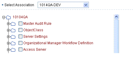

This topic introduces the method that you use to select logical object types for migration. Step-by-step instructions are provided in "Migrating Data".
After you select an association, a folder appears representing the source environment. You can select the expansion icon to the left of the icon to display logical object types on the source. A scroll bar beside the list enables you to scroll up and down as needed.
When you click the expansion icon beside the folder, all supported logical object types in the environment are displayed, as shown in Figure 3-16. A check box beside each logical object type enables you to select (or clear) items to compare. No defaults are selected.
Figure 3-16 Partial Logical Object Types List
Each logical object folder includes an expansion icon. When you expand a logical object type, you can see the logical objects grouped under that type. You can select as many logical object types (or logical objects) as needed:
Select the check box beside a logical object type to compare all logical objects of a particular type.
Click the expansion icon beside a folder to expand the type and display logical objects.

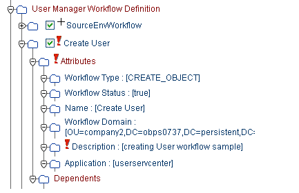

Symbols Highlight Differences When Comparing Objects to Migrate: The following symbols might appear between an object name and its check box to alert you to differences, as shown in Figure 3-17.
The Add icon, +, appears only when the object is present in one directory but not both:
An + (Add icon) in the Source Environment list indicates that the object is present on the source directory but not on the target directory.
An + (Add icon) in the Target Environment list indicates that the object is present on the target directory but not the source directory
The Diff icon (!) appears when the logical object has differing attribute values or dependents, or both.
Figure 3-17 shows an example with the following differences (among others):
Policy1 (displayed with the Add + icon) is present only in the source.
Policy2 (displayed with the Diff ! icon) is the same logical object in the source and target but has different attribute values for the Number of Login tries Allowed and Password Minimum Age on the source and target.

This topic introduces the method that you use to resolve differences in attribute values by applying optional transformation rules or by manually customizing attributes during migration. Step-by-step instructions are provided in "Migrating Data".
After you select logical objects on the Compare and Migrate page and click Next, any transformation rules that were defined for the association are applied automatically. The Customize page appears and shows how objects on the target have been customized by the application of the transformation rules, if any. In the progress indicator, Customize is highlighted.
Initially, only the titles of the two environments are shown. When you expand either environment, details of both environments are presented in a navigation tree:
Target Environment - Before Migration: This pane shows the current and exact state of logical objects in the target LDAP directory before transformation rules and any manual customizations are applied.
Target Environment - After Migration: This pane shows the state of logical objects on the target as they will be after transformation rules, manual customization, and migration are completed.
A sample Customize page is shown in Figure 3-18. In this example, objects are expanded. Differences in attributes and dependents are visible. Again, the Add (+) and the Diff (!) icons indicate differences between the target before and after migration.
Clicking the Cancel button terminates the Customize operation and returns you to the Select Logical Object Types to Compare page.

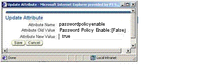

Manually Customizing Attributes: Attributes in the Target Environment - After Migration tree include an update button labeled with two dots (..). Selecting an update button opens an Update Attribute window, where you can manually assign a new value for the attribute. The new value will be assigned during the data migration. Alternatively you can customize attributes after migration within your Oracle Access Manager 10g (10.1.4.0.1), or Oracle COREid Release 7.0.4, deployment.
For example suppose that in both views the Password Policy Enable attribute is (False). To manually customize the value of this attribute, you select the (..) button beside Password Policy Enable (False). In the Update Attribute window, you enter a new value, in this case true, and save it. Figure 3-19 provides an example of the Update Attribute window.
When you click Save, you are returned to the Customize page and the new value is reflected in the Target Environment - After Migration tree. If you canceled the update, you are returned to the Customize page with no changes made to the attribute.
When you finish customizing attributes and click the Next button the Preview page appears, as described next.

Test Environment: Perform the following activities to confirm that the source and target environments in the association are accessible to the Configuration Manager:
From Oracle Access Manager Configuration Manager, click the Migration tab, click Environments. For example:
Click the source environment name to view details. For example:
Test Environment
Read the informational message to confirm that the environment connection is successful.
If there is any problem with the connection, notify the directory administrator. The directory must be live and online during the migration.
Repeat these activities with the target environment to ensure that it is live and online.

From the Select Association list, choose the desired association. For example:
Perform the following steps to select logical objects to compare and migrate:
Expand the association icon to display a list of supported logical object types. For example:
Select all of the logical object types that you want to include in this migration.

Show Differences: On the Compare and Migrate page, perform the following steps to review any differences:
Expand objects by clicking the expansion icon beside the folder.
Add + icon: Determine whether the Add icon is only in the target, or only in the source. For more information, see "About Comparing Data Before Migration".
Diff ! icon: Determine which objects are designated with the Diff (!) icon. This indicates differences for attribute values or dependents. For more information, see "About Comparing Data Before Migration".
Show Dependents: Perform the following activities to show dependents for a logical object:
Click the expansion icon beside a logical object to expand it.
Look for and expand the list of dependents and attributes.
Dependents are migrated automatically; there is no way to select these independently. However, you must select logical objects and related logical objects to migrate.

Customize: On the Customize page, perform the following activities:
Review details of the Target Environment - After Migration to see how the application of any transformation rules has changed objects.
Observe and document differences between the Target Environment - After Migration and the Target Environment - Before Migration; pay attention to any item flagged with the Diff (!) icon because you might want to update attributes.
Proceed as desired for your environment:
Update Attributes Before Migration: Proceed to step 7 if you want to perform this optional activity.
Preview Data: Proceed to Step 8 to review all information before migration.
Cancel the Migration: Click the Cancel button to return to the Select Logical Objects to Compare page.
For more information, see "About Customizing the Target".
Update Attributes: From the Customize page, perform the following optional activities if desired. After expanding objects in the Target Environment - After Migration list:
In your browser window, enable pop-up windows for this site.
Click the update button (..) beside the attribute that you want to change to open the Update Attributes window. For example:
In the Update Attributes window, add the new value and click Save. For example:
Attribute Name: The current attribute name is fixed and cannot be changed.
Attribute Old Value: The current attribute value is fixed.
Attribute New Value: Enter the new attribute value that you want to assign using guidelines in "About Customizing the Target".
Save: Click the Save button to save the updated attribute value and return to the Customization page.
Repeat as needed for each attribute that you want to change in the Target Environment - After Migration list.

Export Data to an LDIF File: Proceed to Step 9 to export data to an LDIF file for customizing or importing with an external tool. In this case, no transaction record is created.
Migrate Data Now: Skip to Step 10 to assign a transaction description then continue with following steps.

Proceed to "Restarting Servers After Migration" to ensure data synchronization after migration.
