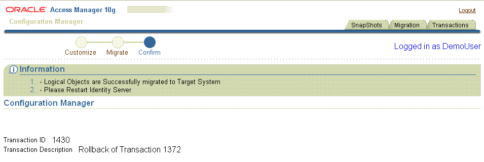

Roll Back: On the Rollback Transaction page, complete the following activities to complete the operation:
Enter a Transaction Description in the field provided, to name the record that is created during this rollback operation. For example:
Roll back of Transaction 1372
Click the Rollback button to undo the changes that were made during the original migration transaction. For example:
Rollback
Click OK to validate and start the rollback operation. For example:
OK
Check the informational message when the operation completes, to confirm that the rollback is successful, as shown next.
