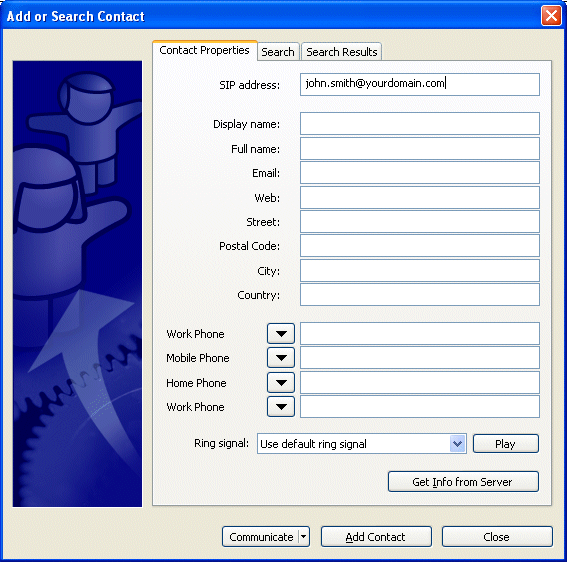

To subscribe to a user's Presence:
  1. Make sure that each test user is logged into a separate instance of the Oracle Communicator client, preferably on different computers.
  2. In the Oracle Communicator client where the first test user is logged in, click the Contacts button and select Add Contact (Figure 3-3).
    Tip:
    For more information on how to add a contact in Oracle Communicator refer to the Oracle Communicator online help.
    Figure 3-3 Adding an Oracle Communicator Contact
    Description of "Figure 3-3 Adding an Oracle Communicator Contact"
  3. In the Contact Properties tab that displays, enter the SIP address of the second test user you defined earlier in the space provided.
  4. Click Add Contact.
  5. Observe the second Oracle Communicator client instance. A message is displayed in which test user one requests permission to subscribe to the Presence of test user two.
  6. In test user two's Oracle Communicator client, click OK to grant Presence subscription permissions to test user one and add the user to the contact list of test user two.
