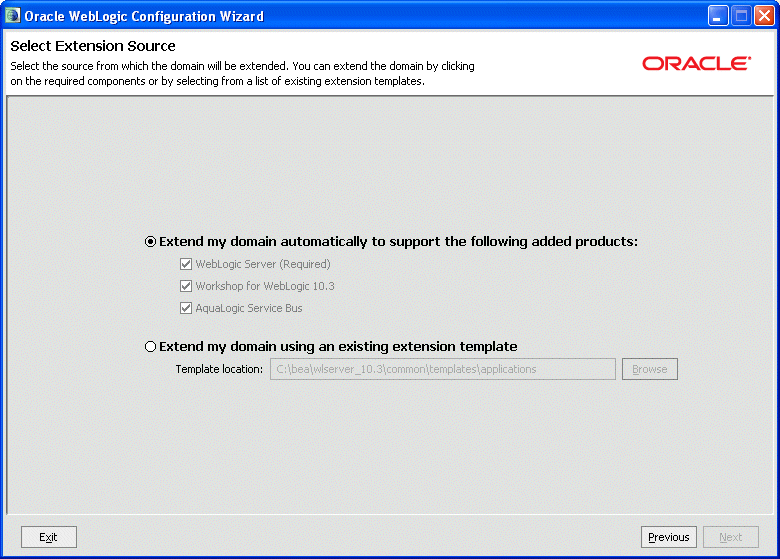

The Select Extension Source window prompts you to select the source from which to extend your domain. You can select product components to add to your domain, or extend your domain using an existing extension template.
To select the source from which to extend your domain:
To use this option, simply check the boxes for the components you want to add to your domain. The components already included in your domain are indicated by a grayed-out check box.
To use this option, you can manually enter the pathname to the extension template in the Template location field and click Next.
Alternatively, you can click Browse to invoke the Select a Template dialog box. The default directory lists the predefined extension templates provided with your product installation. Use the drop-down arrow in the Look In: field to navigate to an alternate directory if desired. Select the desired extension template and click OK to return to the Select Extension Source window.
