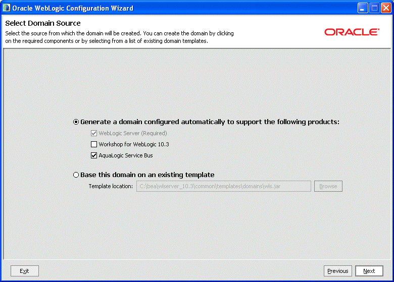

The Select a Domain Source window prompts you to select the source from which to create the domain. You can select the product components to include in your domain, or select a custom template on which to base your domain.
Choose one of the following options for selecting the source for your domain:
To use this option, select the check boxes associated with the components you want to include, and click Next.
You can select the following product components in the Select a Domain Source window as displayed in Figure 4-1. For more information about selecting different products from the list of products and relation between them, see http://download.oracle.com/docs/cd/E12840_01/common/docs103/tempref/tempref.html.
The WebLogic Server is selected by default.
To use this option, manually enter the full pathname to the template in the Template location field and click Next, or click Browse to navigate to the directory containing the desired template. Select the domain template that contains the settings you want to use as the basis for your domain.
