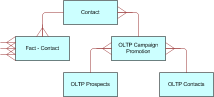

Customers who have purchased the Siebel Marketing product line and who own the Siebel-provided List business models, have business models that have been extended to make sure that list generation occurs from contact information that resides in the Siebel transactional database. This is needed when marketers have added or deleted contacts manually after a campaign is loaded in the campaign contact table. When this happens, the list of target level IDs (contacts) as provided by the segment or segment tree, do not match what is in the campaign load. As a result, the output list needs to be generated from the Siebel transactional database campaign promotions table.
In the Siebel data model, this table is the S_CAMP_CON table (OLTP Campaign Promotion). Figure 4 illustrates the following:
  • The OLTP Campaign Promotion (S_CAMP_CON) table is snowflaked between the OLTP Contacts (S_CONTACT) table and the Contact (W_PERSON_D) table.
  • The OLTP Campaign Promotion (S_CAMP_CON) table is also snowflaked between the OLTP Prospects (S_PRSP_CONTACT) table and the Contact (W_PERSON_D) table.
    Figure 4. Example of Snowflaked Tables.
