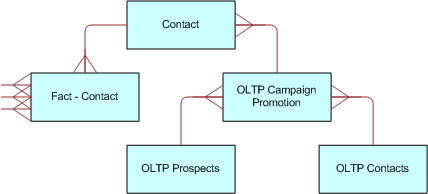

In the data model, this table is the S_CAMP_CON table (OLTP Campaign Promotion). Figure 4 illustrates the following:
  • The OLTP Campaign Promotion (S_CAMP_CON) table is snowflaked between the OLTP Contacts (S_CONTACT) table and the Contact (W_PARTY_PER_D) table.
  • The OLTP Campaign Promotion (S_CAMP_CON) table is also snowflaked between the OLTP Prospects (S_PRSP_CONTACT) table and the Contact (W_PARTY_PER_D) table.
    Figure 4. Example of Snowflaked Tables.
