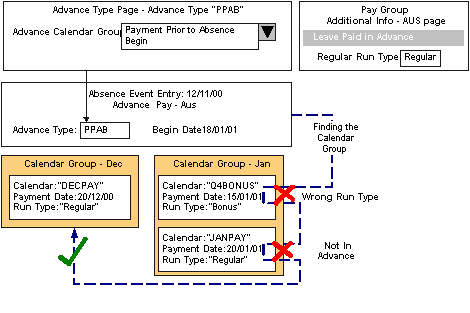

Select a regular run type. Within the general structure of Global Payroll calendars, periods and calendar groups, the system has to determine which calendar group an advance should be paid in.
When the system determine in which calendar group to include an advance, it takes into account the calendars each group contains to see when they are paid. However, a calendar group can contain many calendars, each with different periods and payment dates.
To determine the appropriate calendar group, the system typically uses the organization’s regular run type. You specify the regular run type on this additional pay group page.
In the following diagram, the Advance calendar group for the advance type is Payment Prior to Absence Begin (PPAB). This refers to the payment date that is prior to the absence begin date—not the payment period that is prior to the absence begin date. For the prior payment period, you use the Period Prior to Absence option.
Determination of the calendar group in which to pay a leave advance payment
