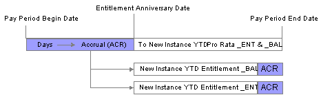

When you run the absence calendar, the deannualized value is accrued to the pro rata year-to-date _ENT and _BAL accumulators. The year in the year-to-date is set when the accumulator’s begin option is Specify Date, and the begin month and begin day are generic variables LVE VR HIRE MONTH and LVE VR HIRE DAY, which hold the employee’s hire month and day, respectively. The accumulators are stored by EMPL ID/EMPL RCD.
When the system automatically creates new instances of the accumulators at the hire date anniversary, the previous values of the entitlement _ENT and _BAL accumulators are rolled over into their new instances and the previous values of the pro rata _ENT and _BAL accumulators are rounded and rolled over into the new instances of the entitlement _ENT and _BAL accumulators. The following diagram shows this:
Pro rata balances transferring to new instances of entitlement balances
The current calendar period is then split into pre-hire anniversary and post-hire anniversary periods, using generic date element LVE DT HIRE ANN DT. The pre-hire anniversary days are then used in formula ANN FM P2EDYS EMBR to work out the proportion of the accrual that belongs to the pre-hire anniversary period. This value is then sent to variable ANN VR PP2EDYS MBR, which adds to the entitlement _BAL and _ENT accumulators. The following diagram shows this (ACR stands for accrual).
Accrual for the days before hire anniversary becoming entitlement
The pre-hire anniversary accrual variable, ANN VR PP2EDYS MBR, also subtracts from the pro rata _ENT and _BAL accumulators. This reduces the pro rata _ENT and _BAL balances by the amount of the accrual that was accrued in the previous accumulator period.

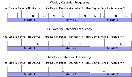

The accrual is granted for whole months only so the formula grants the accrual if the hire day value is in the calendar period (and the hire date is not in the period).
The following diagram shows when the accrual is and is not granted. The letter N indicates not granted (because the hire day is not in the period). You need to distinguish between hire date and hire day.
Accrual according to hire date and hire day

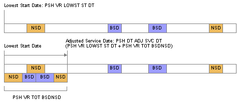

Calculating the Adjusted Service DateThe system adjusts the initial service start date before calculating the duration of the service period upon which the accrual is based.
The diagram shows how non-service days and between-service days are totalled then added to the lowest (earliest) start date to reset the lowest start date to a later date. The variable and date elements are also shown.
Adjusting the service start date

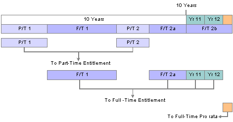

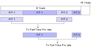

Calculating OGO Part- and Full-Time Pro Rata and EntitlementWhen you run an absence calendar, the system recalculates all the accrued part-time and full-time pro rata and entitled long service leave. The following two diagrams show the accumulators are increased—at 0.025 per month—for an absence calendar run, after 9 years of service and after 12.5 years of service. Both the _ENT and _BAL accumulators for the four accruals are updated. The accumulators are calendar period based.
Update of leave accumulators after 9 years
Update of leave accumulators after 12.5 years
