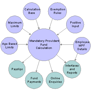

The following diagram displays the rules and options that you are required to set up or exercise to ensure correct MPF calculation and system outputs.
User inputs and system outputs for Mandatory Provident Fund deductions
