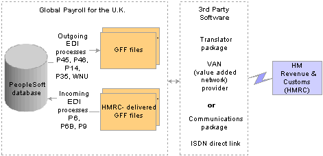

This diagram illustrates the EDI processes:
Global Payroll for the U.K. EDI processes
There are two types of EDI transactions:
Outgoing transactions
In this type of transaction, the application engine process creates a flat file containing information from your PeopleSoft database that you then submit to HMRC via third-party software or provider. The outgoing transactions are: P46, P45 Part 1 (leaver), P45 Part 3 (starter), P14, P35, and works number update (WNU).
Incoming transactions
In this type of transaction, the application engine updates employee data in your PeopleSoft database using information from a flat file that you obtain from HMRC via third-party software or provider. The incoming transactions are: P6 and P9.
All the flat files, whether for outgoing or incoming transactions, are in HMRC-defined Generic Flat File (GFF) format. Global Payroll for the U.K. does not support any other file format. There are four types of GFF format on which Global Payroll for the U.K. continuous EDI transactions are based:
