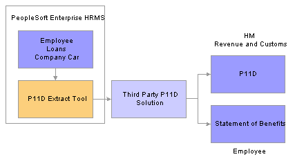

The P11D is a statutory report, created annually, to report employee expenses and benefits to HM Revenue and Customs (HMRC) for employees whose earnings exceed the limit set by the government. Employers are also required to provide a Statement of Benefits to their employees covered by the legislation. The information required for the P11D is diverse and includes benefits such as employee loans, company cars, and medical insurance. Typically this information is stored in different systems, including HR, payroll, and financial systems.
Global Payroll for the U.K. provides a P11D data extract tool that enables you to extract the P11D information that is stored in the standard PeopleSoft Enterprise HRMS tables. It creates extract files in a CSV format that can be processed by a third-party P11D solution.
This diagram shows how the P11D data extract tool fits into the P11D production process:
Overview of the P11D Production Process
The P11D data extract tool retrieves data from Global Payroll for the U.K. and PeopleSoft Enterprise Human Resources:

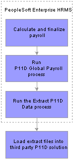

This flowchart shows the steps in the P11D data extract process:
Flowchart of the P11D Data Extract process
Before you can run the P11D processes, the payroll for the entire tax year must be calculated and finalised. You cannot run the P11D process if payees are open in any calendars. Therefore, you must plan carefully when you run the process between payroll runs.
The first step in the P11D data extract process is to run the P11D Global Payroll process. This process:
Is run in the same way as payroll.
Use the normal Calculate Absence and Payroll run control page to initiate P11D processing. However, the process requires a specific calendar and processing structure. This is explained in the setup section.
Retrieves employee, company car, and loan data using arrays.
Populates a set of P11D results tables.
The process populates the result tables GPGB_P11DRSLT_L, GPGB_P11DRSLT_M, and GPGB_P11DRSLT_S. These generic result tables hold data from different source tables. The process assigns an extract type to each row of data that specifies the type of information. The Extract types page identifies the extract types that are delivered.
Retrieves data for all employees who have company car or loans data for the tax year.
Note. If some of your employees do not required P11Ds because their salaries are below the statutory minimum, then you can identify these employees using your P11D solution. This is done after the extraction is completed and the data has been loaded into the third-party P11D solution.
Use the message log to view the results of the process. You can also use the normal payroll results pages to view a list of employees who were processed.

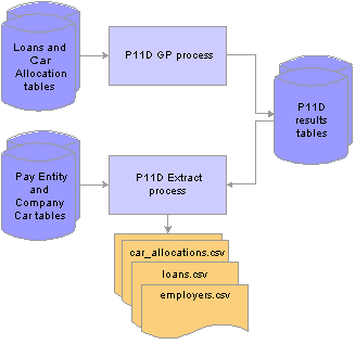

When you have successfully run the payroll process, run the Extract P11D Data Application Engine process (GPGB_P11D). This process:
Extracts P11D information from various PeopleSoft tables.
The process extracts data from the P11D result tables, previously populated by the P11D global payroll process, and other HRMS tables.
Generates a series of CSV files using the extracted data.
The resulting CSV files are stored in the report repository.
The Extract P11D Data process uses the extract definition, which you define for your P11D solution, to determine the data extracted and the format of the CSV file.
Set up extract definitions using the Define P11D Solution GBR (GPGB_P11D_SOLUTION) component.
See Understanding P11D Extraction Setup.
This diagram summarises the two processes that comprise the P11D data extract tool:
Summary of P11D Data Extract Processes
Note. The diagram shows an example of the extract files only. The CSV files produced differ according to the third-party P11D solution you are using.

Running the P11D Extract Processes
This section discusses how to run the P11D extract process.
Pages Used to Run P11D Extract
Page Name |
Object Name |
Navigation |
Usage |
GP_RUNCTL |
Global Payroll & Absence Mgmt, Absence and Payroll Processing, Calculate Absence and Payroll, Calculate Absence and Payroll |
Run the P11D global payroll process to populate the P11D results tables. Remember that you must run this process when the payroll for the tax year is finalised and the payees are not linked to any open calendars. Note. The P11D global payroll process must be finalised before normal payroll processing can resume. However, you should check that the Extract P11D Data process runs correctly before finalising the payroll process. |
GPGB_P11D_RC |
Global Payroll & Absence Mgmt, Year-End Processing, Extract P11D Data GBR, Extract P11D Data |
Run the Extract P11D Data process to create the CSV files. |
