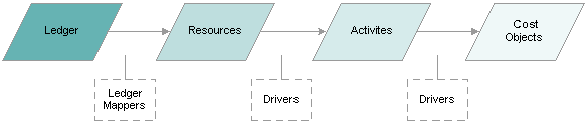

Activity-Based Management Modeling Components Activity-Based Management uses models—complete sets of rules to define individual activity-based costing model objects and their relationship to your organization's financial management system, primarily the general ledger. Models let you specify different business scenarios for comparative analysis. Activity-Based Management lets you define, run, and analyze models to assess your organization's profitability.
Create models in Activity-Based Management by defining the following components:
Modeling components
Resources
Resources—such as people, facilities, and costs associated with people and expenses—are the economic elements consumed while performing activities. They are the core elements that let your organization operate.
Activities
Activities consume resources and drive costs to cost objects. The lowest-level definition of what your organization does, activities are the foundation for measuring activity costs.
Cost Objects
Cost objects represent cost information grouped by profitability dimensions—products, customers, and channels. With your model's resources and activities linked to cost objects, which are the final results of the activities performed by your organization, they are often the focal point of profitability analysis.
Ledger Mappers
Ledger mappers relate expense data from your general ledger accounts to resource objects. You can map multiple ledger line item amounts to one or more resource IDs in the following two ways:
An actual amount that represents actual costs of the accounting period results
A budgeted amount that you can use to calculate the capacity rates as well as budgeted model results
Drivers
Drivers—transactional, duration, and intensity—let you assign monetary amounts from one object to another throughout the model (calculated by amount, percentage, spread even, and direct) in different ways depending on assignment type and object type. You can even assign drivers across business units.
Pointers
Pointers specify the location of driver quantities in the Operational Warehouse - Enriched (OWE) tables. Rather than entering and maintaining static driver quantities, pointers let you to extract values from any location in the OWE, and then use these values as driver quantities.

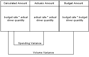

Determining both the actual and budgeted rates let you calculate two variance types:
Variance Type |
Calculation |
Volume |
(budgeted driver quantity - actual driver quantity) x (budgeted rate) |
Spending |
(budgeted rate - actual rate) x (actual driver quantity) |
As a result, you can calculate the following two types of variance results:
Favorable variances |
Costs that are less than those budgeted and are expressed as positive amounts. |
Unfavorable variances |
Costs that are greater than those budgeted and are expressed as negative amounts. |
The combined results create the total variance. If you apply the budgeted rate calculated by the Activity-Based Management engine, only those values pass through the remainder of the model versus passing along the actual amount.
The following diagram illustrates how the system calculates volume and spending variance:
Variance calculation for actual and budgeted rates

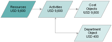

Capacity Rates
Actual and budgeted driver quantities can and do fluctuate over time; likewise, the actual and budgeted rates fluctuate over the same time period. Because decisions made on the basis of these fluctuating rates could be misleading, the concept of capacity rates becomes important.
When entities are not operating at their full capacity and all costs are applied to activities and cost objects, the model fully absorbs the costs and managers are forced to use historical information to make decisions.
Activity-Based Management lets you assign the excess costs to a departmental cost object so that you can track excess capacity. Assigning excess capacity to such an object balances the actual amounts within the model, and the flow of amounts through the objects remains constant:
Calculating capacity rates
The capacity rate is the result of the budgeted amount divided by the capacity driver quantity:
capacity rate = (budgeted monetary amount) / (capacity driver quantity)

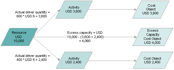

Example of a Capacity Calculation
Suppose that the actual resource cost mapped from the general ledger is 10,000 USD. Our actual driver quantity for activity 1 is 600 units; for activity 2 it is 400 units. In addition, suppose that the budgeted amount for the resource is 9,600 USD, and the capacity volume for the resource is 1,600.
The system calculates a capacity rate by dividing the budget amount value by the capacity volume quantity as follows:
9,600 USD / 1,600 = 6.00 USD
Values going to activity 1 and activity 2 are then calculated by multiplying the actual driver quantities by the capacity amount.
Activity 1 actual driver quantity = 600 x 6 USD = 3,600
Activity 2 actual driver quantity = 400 x 6 USD = 2,400
For the model to balance, the system places the excess amount in the departmental excess capacity cost object. The resource total is 10,000 USD while activities total 6,000 USD. The system places the remaining 4,000 USD in the excess capacity cost object:
Capacity rate calculation example

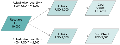

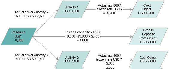

Frozen Rates A frozen rate is fixed and agreed upon outside the context of the Activity-Based Management model:
Calculating frozen rates
Example of a Frozen Rate Calculation
Using a frozen rate lets you calculate variances from actual, budgeted, or capacity values. Because information about the driver quantity is not used to calculate the rate, the variance is not divided between spending and volume:
Frozen rate calculation example
