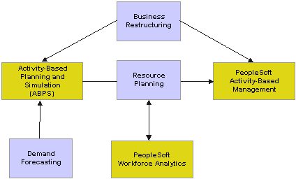

The following diagram illustrates the flow for the different PeopleSoft ABPS forecasting types:
ABPS flow for different forecasting types
